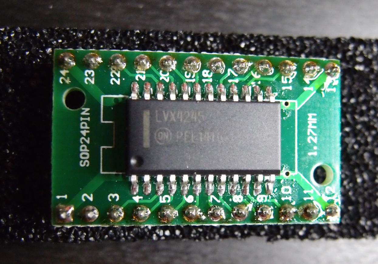

PostPosted: Sat Oct 17, 2015 3:45 pm
Posts: 171
Location: Philadelphia, PA
The 74LVX4245 is now about ready to mount on the breadboard. I was wondering whether it's worth mounting bypass caps directly on the carrier board, but I think I'll wait and see how it performs first.

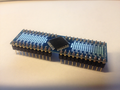

With the AVR MCUs you can calibrate the internal 8MHz oscillator and 7.37 MHz is within the possible calibration. Do the PIC not have such a feature as well? To use TQFP-44 on a breadboard I used the following adapter
File comment: TQFP-44 to DIP-48 Adapter
The result is a DIP-48 with standard width (0.6"). I use the PCB from dipmicro.com and as pins I use machined round pins (not the square ones)
