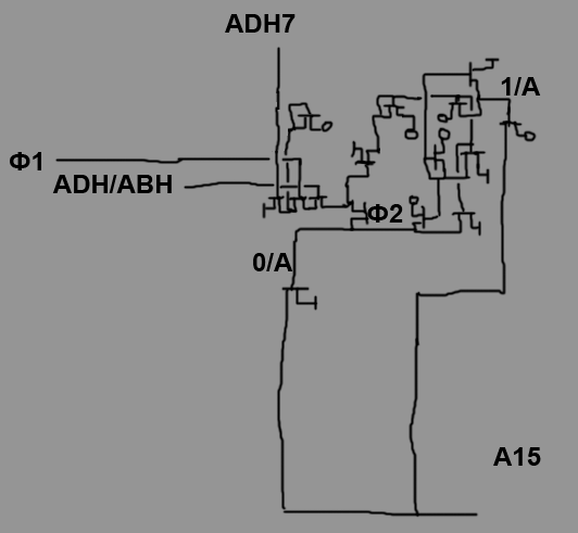

Todays speccy : Address pin

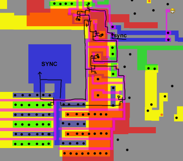

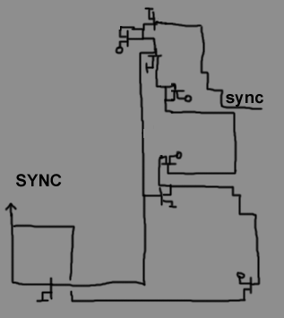

Todays speccy : SYNC
Color :
Transistor level :
Logic:
SYNC = sync (driven by internal signal through amplifiers)

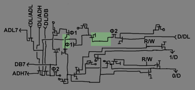

Found error in data latch (missing vias).
Updated transistor level schematics :

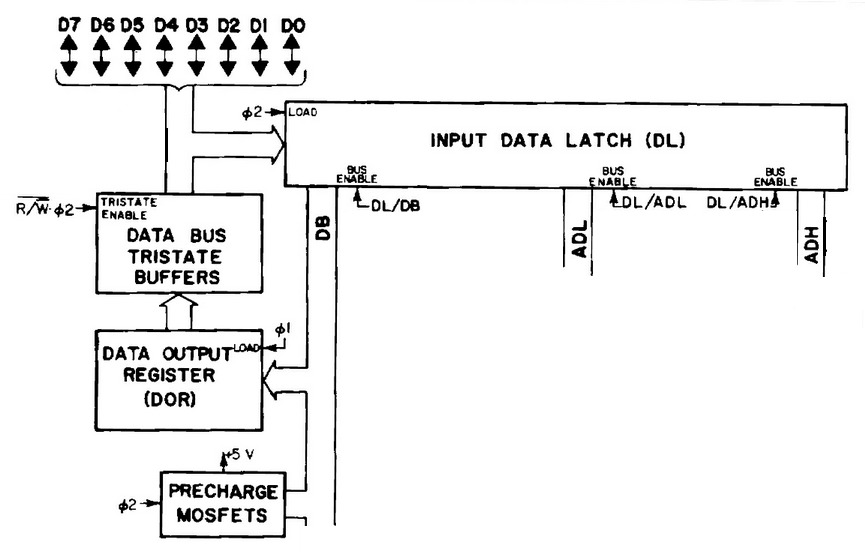

I completed reversing of data bus logic :)
PHI1:
if (DL_ADL) ADL = DL;
if (DL_ADH) ADH = DL;
if (DL_DB) DB = DL;
DOR = DB;
PHI2:
if (RW == 0) DATA = DOR;
DL = DATA;
ADL = ADH = DB = 0xFF;

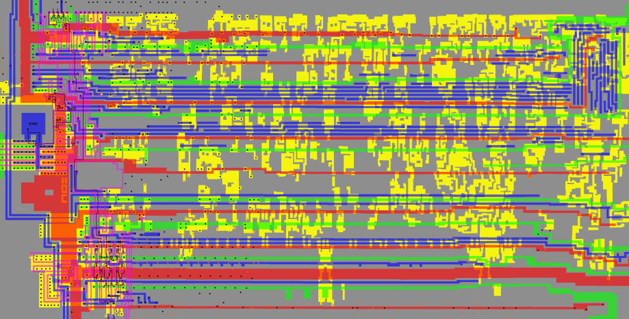

Started random logic :)
Simple explanation :

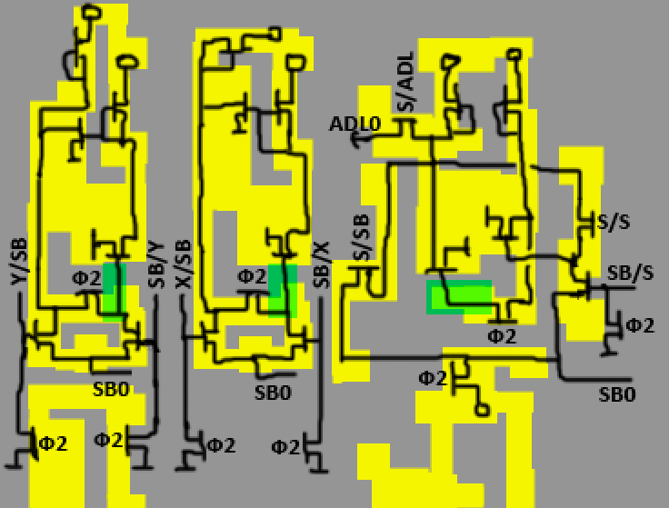

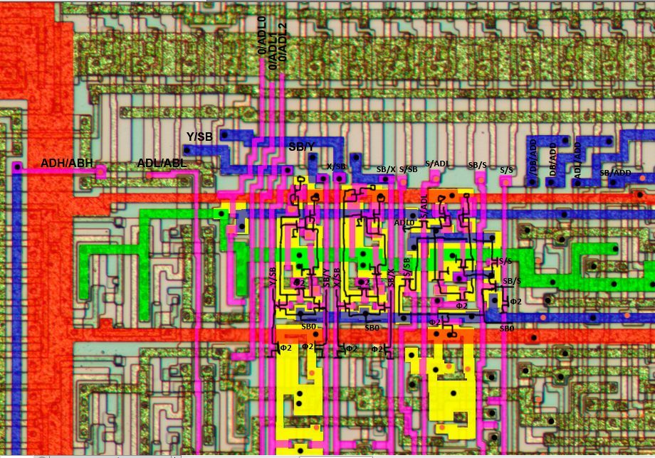

Todays speccy : Registers X, Y, S
Color (bit 0):
Transistor level:
Logic:
PHI1:
if ( Y/SB ) SB = Y;
if ( SB/Y ) Y = SB;
if ( X/SB ) SB = X;
if ( SB/X ) X = SB;
if ( S/ADL) ADL = S;
if ( S/SB ) SB = S;
if ( SB/S ) S = SB;
if ( S/S ) S = S;
PHI2:
SB = 0xFF;

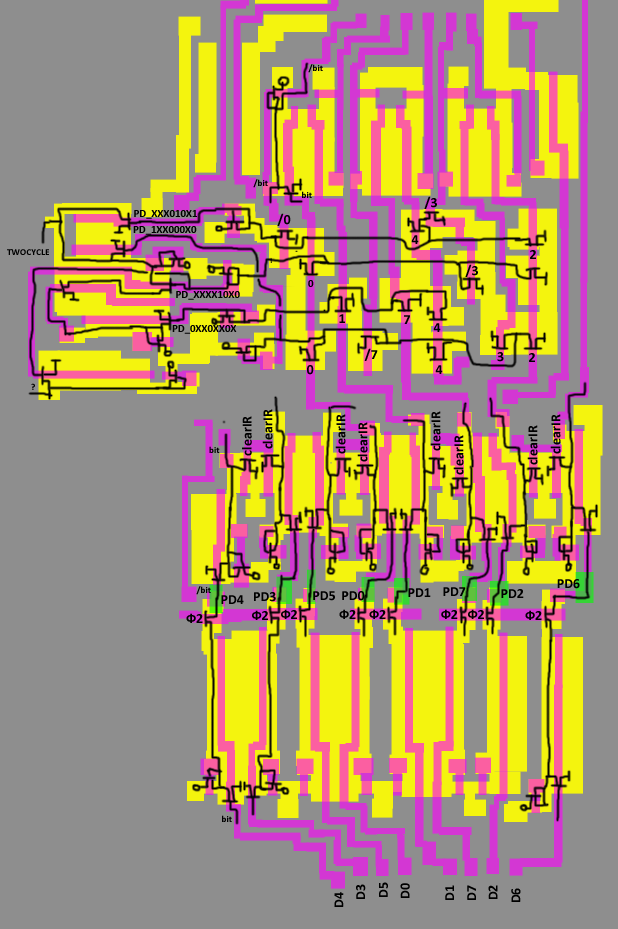

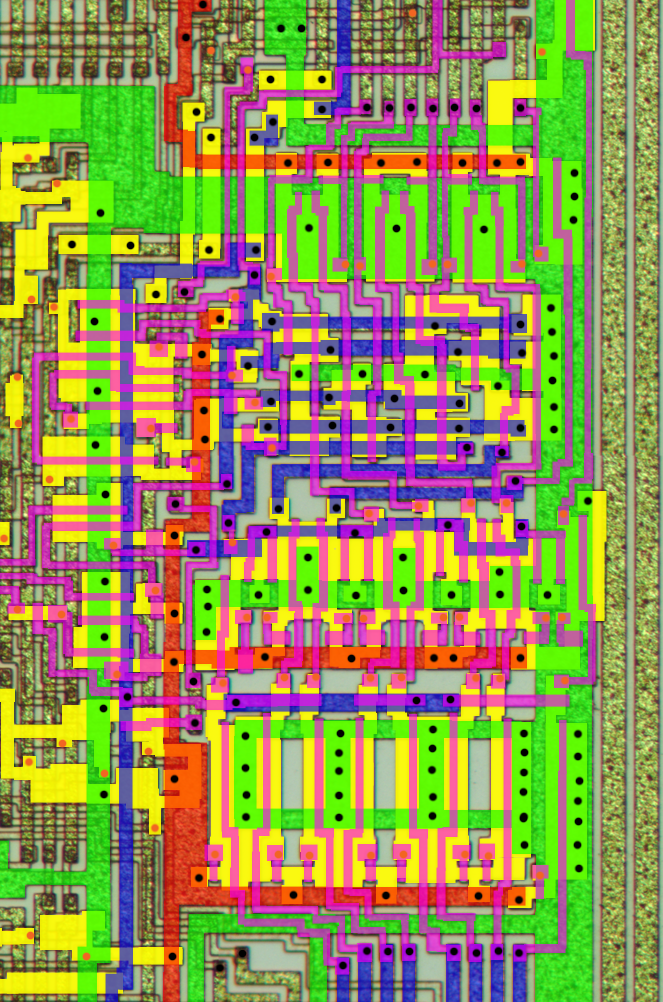

Todays speccy : Predecode Register
6502 addict
Re: Breaking 6502 apart
Instantly recognisable! You notice how the first transistors from the databus are huge? I think that's to make the inverter's logic threshold a bit lower, which it needs to be because the databus is at TTL levels. Fortunately, it makes no difference to a logic sim. A big pulldown is a more eager one, so the output flips at a lower input voltage than it otherwise would.
You see the same thing in the next gate, after phi2, because the pass transistor transmits a degraded logic 1. The ClearIR inputs are normal sized by comparison. (As discussed previously, those PDn nodes are storage nodes.)
