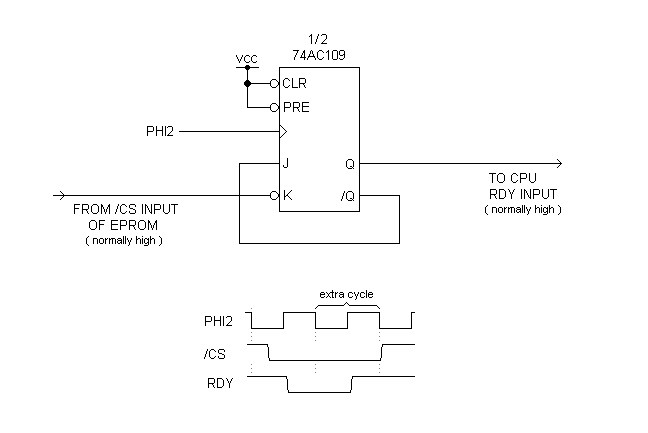

Generating wait states:
simple wait-state generator.gif (4 KiB) Viewed 11385 times
The circuit above generates a one-cycle-long wait state when the EPROM is accessed. (For WDC, it's best to add a series resistor -- see below.) One wait state may not sound like much; but, when you're pushing the CPU close to its maximum clock rate, adding one wait-state roughly triples the time available for the EPROM to respond! Here's why. At high clock rates tADS and tDSR delays (which each consume a fixed number of nanoseconds) end up accounting for about 50% of all the nanoseconds in a clock cycle. (65xx timing is graphically explained in the Visual Guide to 65xx CPU Timing).
The access time remaining for memory to do its job works out to roughly 50% of the nanoseconds in one clock cycle. Adding a one-cycle-long wait state changes this figure from 50% to 150%. (The tADS and tDSU delays don't get applied again when a wait-state cycle is inserted.) Stated another way, if the cycle time is 100 ns, say, then adding a one-cyle-long wait state increases the available memory access time by 100 ns.
ETA: There's an implicit assumption. The circuit only works if /CS goes low before the rise of Ø2 -- which is normally the case. BDD touches on this in the following post. Also: using the both halves of the '109, two wait states can be provided (see circuit below). The extra access time thus provided will be 200% of one cycle. The total access time will be about 5 times what's available using no wait states.

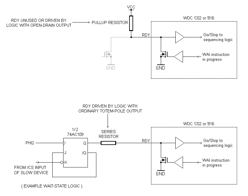

Further edit: in contrast to Rockwell and other suppliers, WDC makes the RDY pin bi-directional. A WDC 'C02 or '816 will pull its own RDY pin low as a result of executing a WAI instruction. This can result in excessive current flow if the RDY pin is driven high by external logic at the same time.
One solution is to use an Open-Collector or Open-Drain gate to drive RDY (as shown in the upper diagram in image below) but this limits the ability for RDY to quickly return high. It's better to use an ordinary gate and simply include a series resistor to limit current flow (lower diagram).
WDC's datasheet was revised to include a comment about the series resistor (as well as a comment about pullup resistors).
Unfortunately WDC doesn't suggest a value for the series resistor, so let's look at that question. Too low a value means increased dissipation, and the risk that a valid logic-low voltage won't be achieved. OTOH too high a value will produce unacceptable delay re the RC of the gate and resistor driving the capacitance of the RDY input. I myself would use a series resistor of around 470 ohms -- a rather low value, but IMO not so low as to prevent a valid logic-low voltage from being achieved. In another thread Garth suggests putting a small (~22 pF) capacitor in parallel with the resistor, which allows use of a much higher resistance but of course increases the component count slightly.

Something I noted is that it appears that you are gating the SRAM chip select with Ø2. That is generally not good practice. The problem as it stands is that the SRAM will not respond to chip select until sometime after Ø2 has gone high, which will set a hard limit on performance. It's better to select the SRAM (and ROM) as soon as a valid address appears on the bus, which is early during Ø2 low, and then gate /OE or /WE on the rise of Ø2. That way, all of the Ø2 high period is available to read or write.
Also, many SRAMs respond faster to /OE and /WE than to /CS. So the procedure I recommend (and use in POC) is to assert /CS as soon as the address is valid and then assert /OE or /WE only when Ø2 rises. As an example, the SRAM I'm using in POC V1.1 is guaranteed to respond to /CS in 12ns or less. If /CS is already asserted and /OE is then asserted, the SRAM will drive the data bus in 6ns or less. If /OE is already asserted and /CS is used to gate the device the elapsed time until the SRAM starts driving D0-D7 is 12ns.

Jeff's solution (above) is more elegant, has a very low parts count and can be rigged up to only affect devices that need a wait-state. Otherwise, the system runs full speed ahead at all times.
Unlike the NMOS parts, the 65C02 (and 65C816) will respond to RDY during write cycles. So there's really no good reason to not use wait-states to accommodate slower devices.

it appears that you are gating the SRAM chip select with Ø2. That is generally not good practice. [...] It's better to select the SRAM (and ROM) as soon as a valid address appears on the bus, which is early during Ø2 low
Yes, absolutely. This is something I take for granted, and is implicit in the wait-state circuit I posted above. I confess I didn't examine Banedon's circuit until now. (Hmmm... there are two signals named /ROM select... )

Also I've edited my previous post to include a circuit for two wait-states. Compared with no wait states, this results in roughly quintuple (5 times) the available memory access time. /CS is presumed to go low before the start of phase two, as already discussed.
