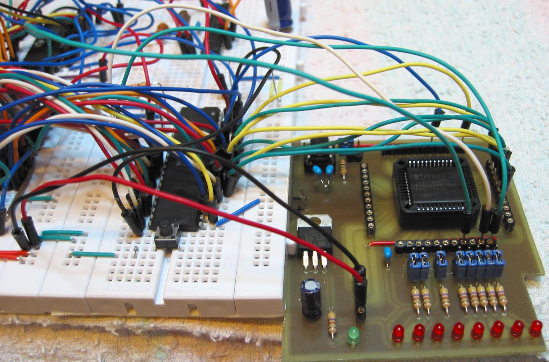

Reporting some progress:
I finished making a Xilinx parallel programmer and a XC9536 / 72 ISP Demo Board.
I also managed to reproduce Daryl’s 65SPI. I’m really happy. 8-P
Daryl is helping me programming some address decoding (thanks Daryl) and it’s going well. I’m studying an HDL-ABEL Primer and found Xilinx’s ABEL Reference Guide
http://www.xilinx.com/itp/xilinx10/help ... /whnjs.htm

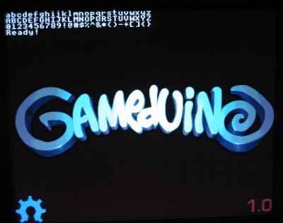

I’ve attached the demo board to my prototype 6502 and transferred my very first bytes through 65SPI. As slave device I connected a gameduino. (not on the picture)

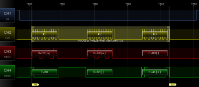

Please forgive me if the answer is obvious, but what is that sub-microsecond spike in the green channel?
Mike
lordbubsy
Posts: 207
Joined: 11 Sep 2013
Location: The Netherlands
Re: 6502 Design & concept questions.
Post by lordbubsy »
I suspect that it is the start of the third byte, which has to be “1” on start. I’m not sure though.

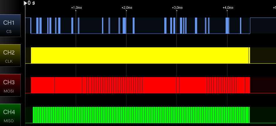

OTH, I discovered that transmission wasn’t stable. Therefore I have replaced the power form the USB cable to a proper power supply. I lowered PHI2 to 1MHz instead of 1.8432MHz. Cleaned up the breadboard and added some more bypass caps. That didn’t help either.
After I connected ALL VCC’s, GND’s and open inputs to GND from 65SPI, transmission stays stable.
Although I keep getting random spikes on all channels.

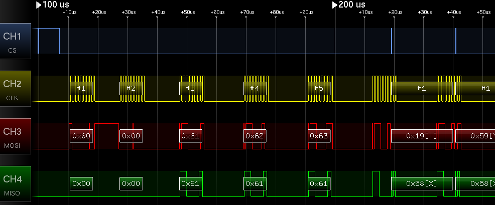

This is the start of the transmission which sends $80, $00, "abcdefgh etc."
This is the whole transmission.
All those blue spikes shouldn't be there.
I hope it will be more stable on the PCB. I’m at roughly 80% now.
