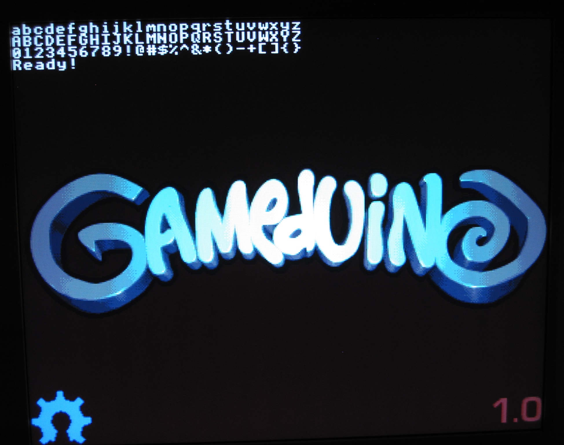

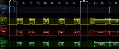

I’ve attached the demo board to my prototype 6502 and transferred my very first bytes through 65SPI. As slave device I connected a gameduino. (not on the picture)
Marco

Please forgive me if the answer is obvious, but what is that sub-microsecond spike in the green channel?
Mike

I suspect that it is the start of the third byte, which has to be “1” on start. I’m not sure though.
OTH, I discovered that transmission wasn’t stable. Therefore I have replaced the power form the USB cable to a proper power supply. I lowered PHI2 to 1MHz instead of 1.8432MHz. Cleaned up the breadboard and added some more bypass caps. That didn’t help either.

Although I keep getting random spikes on all channels.
This is the start of the transmission which sends $80, $00, "abcdefgh etc."
This is the whole transmission.
All those blue spikes shouldn't be there.
I hope it will be more stable on the PCB. I’m at roughly 80% now.
