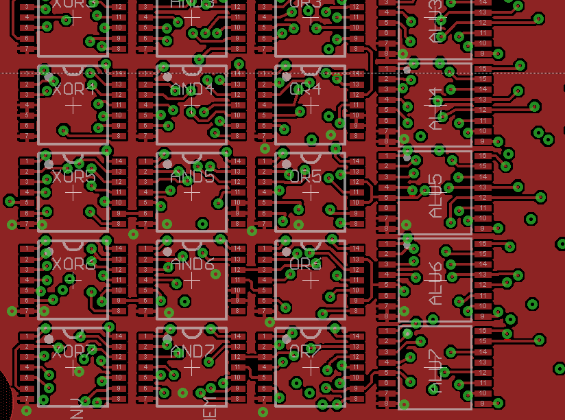

Here's the same area with top layer, showing GND pour, and GND vias near pin 7 of most ICs.

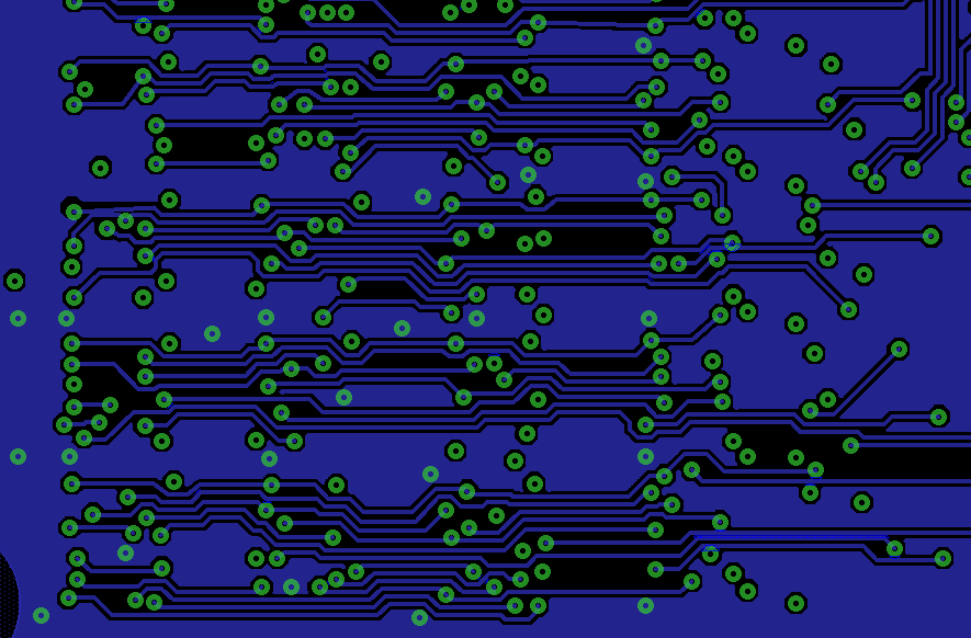

Re: Yet another TTL 6502
Here's the same area with bottom layer. Even though most of the traces run here, I still try to allow GND pour between them, especially near the GND pins of the ICs.
Each horizontal row of ICs is one bit slice, and most of the signals are going left to right, which means that most of the return current is also going horizontally. If I put a via near each GND pin, the return current can go through that strip.
I'm still planning to go back to this area and try to move traces in order to maximize the ground flow.

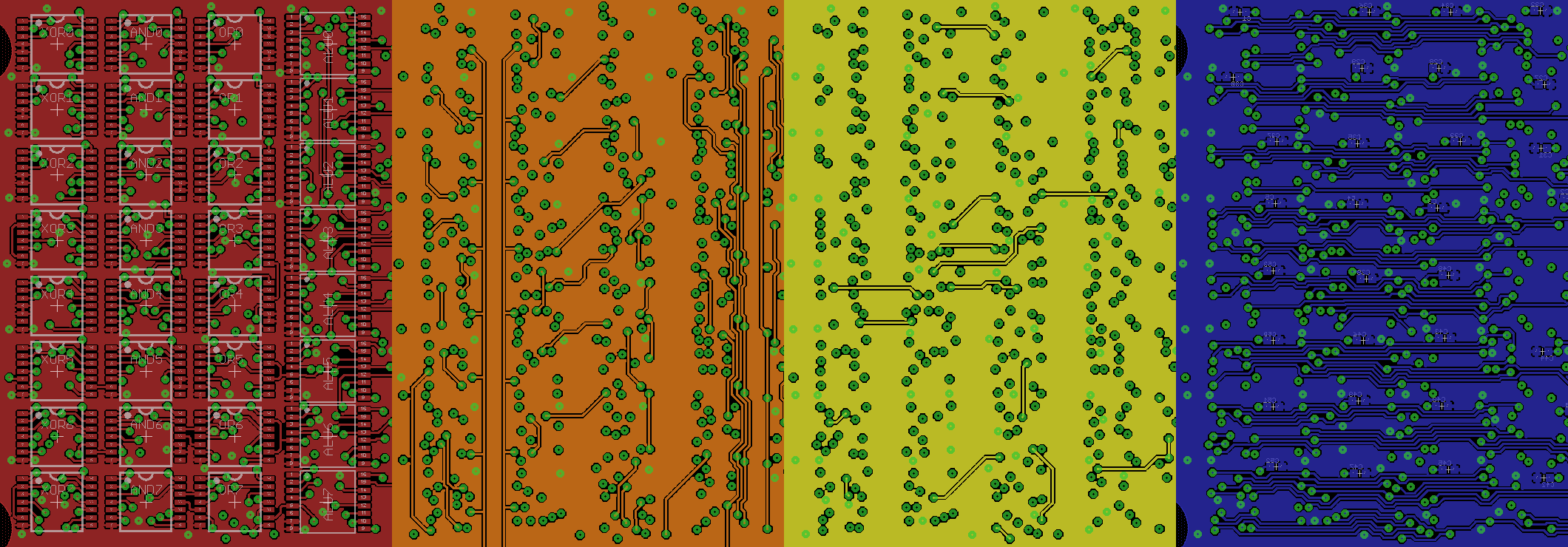

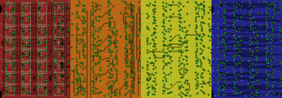

I did manage to finish the ALU section, including control lines. Optimized the traces, and added extra GND vias. Also added a bypass cap near each IC (on the bottom, next to the VDD via). Fixed all design rule errors, and put everything on grid in 45 degree angles (using 0.075 mm grid, about 3 mil)
Here's a composite image of all 4 layers (red=top, orange=VDD, yellow=GND, blue=bottom). All layers have GND pour, except the VDD layer which has a pour for the 3.3V power.

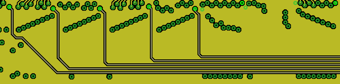

Didn't have much time today, but I added a couple of control signals for the register clocks. Because these are sensitive to cross talk (unlike everything else) I put them in the GND layer, separated by thin GND strips. There are 4 more clock signals in the design, and the rest is all data/enable which isn't critical.
How so ? The return current can travel right next to signal, so the 'loop' has minimal enclosed area.
(On the part that you can't see, towards the right, the signals pop back up to top layer, so the GND strips are continuous).
It's a solid plane full of current, and there's a slot cut in it, so it may possibly act like a slot antenna. Ground isn't "zero", and voltages are all relative, a slot in a ground plane can be just as bad as a deliberate antenna. I think. It's all theory to me, I don't (intentionally) make transmitters.
I'm pretty sure you don't want any traces passing over those lines on other layers though. In which case why bother doing it on the ground layer, do it on the other layers, since they necessarily have free paths.
It will probably all work anyways though, and you're not going for emissions testing.
The practical problem is that I only have 2 layers with enough room: the top layer and the 'gnd' layer. Both are relatively clean, and both have a ground pour filling up all unused space, so despite the naming, they are fairly similar.
I don't like to put long traces in top layer, because it tends to cut up the board into little islands. Also, the gnd pins of the devices are directly connected there, so I get "free" connections without having to worry too much about placing a via right next to pin.
What I'm hoping is that the several ground pours together will act as a more or less solid plane (helped by sprinkling of gnd vias)
The only good alternative is to use 6 layers, but I don't think that's necessary for function, and like you said, I'm not going for emissions testing.
