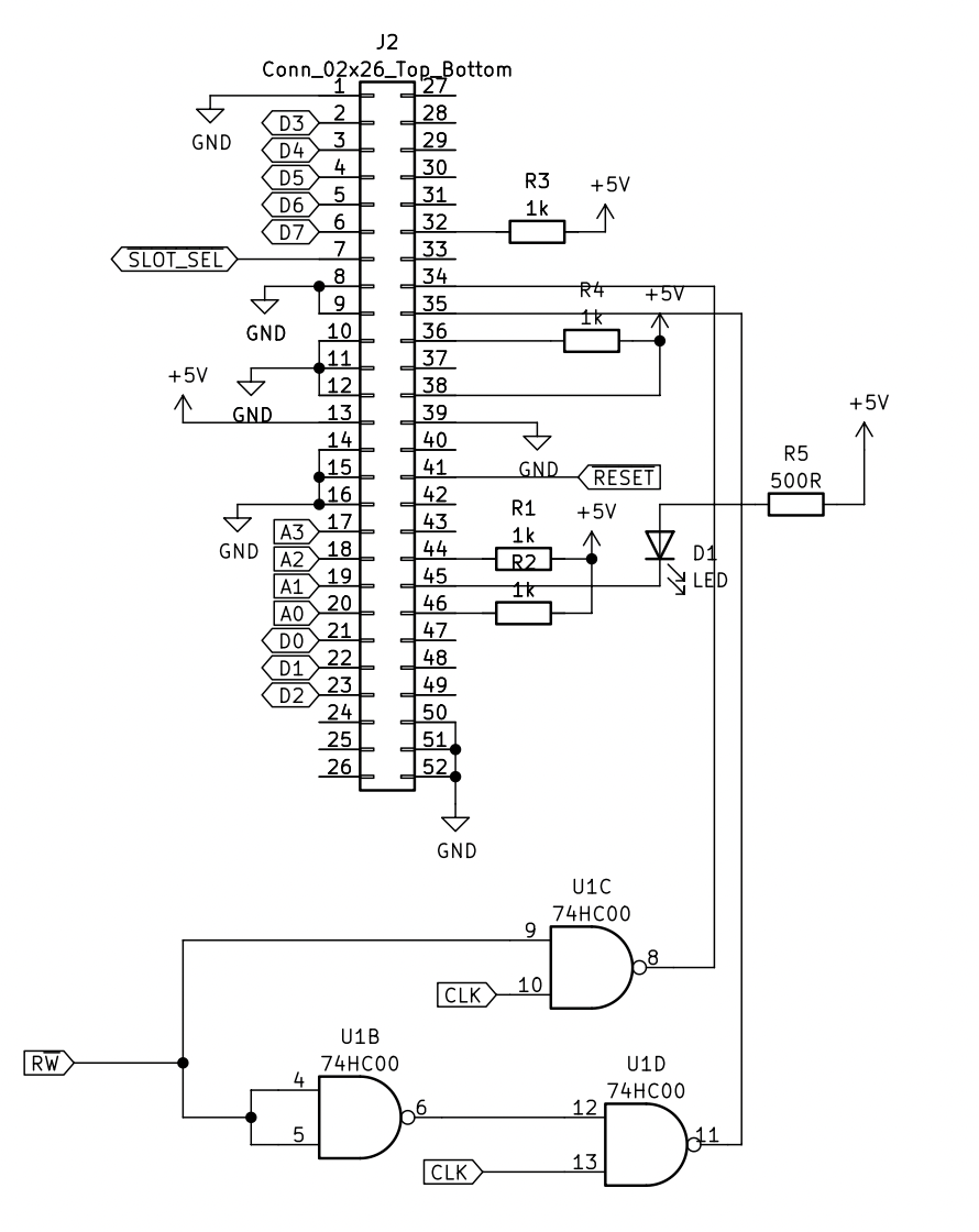

I am trying ( and so far failing) to reliably read data from a CF card.
I built a circuit which seems to work, but I am getting some missed bytes, or sometimes added bytes.
Here is a schematic of the circuit, but note I am using a CF to IDE adapter on my prototype board (to my understanding they are just passive adapters, am I wrong?)

I think you might be having an issue with your hardware setup. The schematic is a bit confusing... as you show a 52-pin connector and compact flash is a 50-pin connector. You noted you're using an adapter, but all of the ones I've used over the years are setup for either a 40-pin IDE interface (with separate power connector) or a 44-pin 2.5-inch IDE connector (integrated power). In any case, these are basically passive, but would have the correct wiring to put the CF Card into IDE mode. Also note that there are two power pins on the CF Card: pins 13 and 38. You have pin 13 to +5V and pin 38 via a 1K resistor to +5V. You also have the /CS0 select tied low and are using a bunch of gates decoding the read and write lines to the CF Card. This might create some timing problems, but maybe not. You show pin 50 as floating, but the SanDisk specification shows pin 50 as Ground.

Hmm, I'm forced to guess some details. Is CLK the same as PHI2? And is SLOT_SEL the output of an address decoder?
I does not seem to be a timing issue either because I get the same types of errors whether I run the computer at 1, 6 or 12 MHz...
Altering the clock speed isn't 100% proof you DON'T have a timing issue. But if CLK is indeed PHI2 then your circuit looks reasonably good to me. You could try replacing the 'HC00 with 'AHC00...

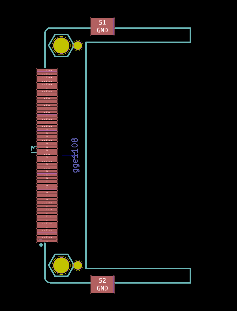

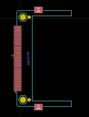

Pins 51 and 52 are the little tabs that hold the connector down on the board. This is the footprint I am using
The schematic is not the exact circuit I am using at the moment. It's a design for a board I am planning to make once I have this prototype working. I can see now that it is wrong in a few places. I can draw and post the prototype's schematic if that would be helpful. I used the same decode logic, but I have CE1 (pin 37 on the CF card) tied to the chip select out of the memory decoding. CE0 (pin 38) is tied to ground. Thank you floobydust for your keen eye, I'll make sure to fix these mistakes on the schematic before having the board fabricated. Your schematic will definitely be helpful. Could you also maybe point me to your PLD code so that I could check my own logic against yours ?
Yes to both
It looks to me as if the code is calling itself!
There is an "rts" on the line above "cf_read" that maybe escaped your coffee deprived brain :D
you should have 3 controls: chip select, read strobe and write strobe. Timing wise, read strobe or write strobe need to be asserted last and negated first. Think of chip select as one of the addresses.
Chip select is tied directly to the output of the address decoding.
The read and write strobes are mostly the same, but incorporating the RW signal gated and by the PHI2. Is that enough?

Thank you floobydust for the code listing. it helped me a great deal when trying different things. I still had some trouble getting reliable reads from the CF card, even after trying probably everything that was offered here.
I then realized that plasmo's comment about signal integrity was probably on the money, so I had a board fabricated according to the schematic I posted in my first post, modified to take into account everyone's remarks.
Here is the current version.
And it turns out that when on a proper PCB, this design works flawlessly! I had a bit of trouble soldering the socket, but apart from that I am very happy with it. I can now use the Taliforth block read and write facilities, and have even played with a very small boot rom (about 200 bytes) that only copies the code from CF to RAM and jumps to it, it's great!
So again, thank you everyone for your help!!
