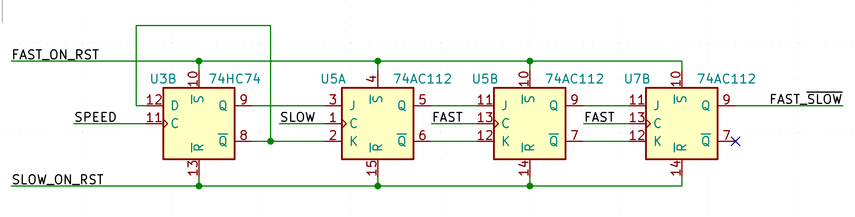

So this is what I came up with after reading the double-flop article this morning. Is this what you had in mind?
If SLOW and FAST have synchronized phases so that U5A is triggered too close to the falling edge of FAST, then the setup time of U5B is not met and it could go metastable. This is fine because it has up to the period of FAST minus the setup time of U7B to settle. Then, the next falling edge of FAST will correctly propagate the value to FAST_~SLOW. This adds one flip flop delay to determining the max frequency this can run at. However, that is fine because the limiting circuit is still PULSE_~RUN, so it does not change my max frequency.
One thing I'm unsure of is what happens if U5B starts changing while still in the hold time of U7B. Thankfully for this specific J-K flip flop the hold time is 0 so it shouldn't be a problem here.

I used a variation of Figure 3 on this page:
https://www.eetimes.com/techniques-to-m ... itch-free/
to do clock switching between a fixed 8MHz clock and a variable 8 to 50MHz clock for a 68000 board. It was implemented in an ATF1504 CPLD.
The circuit relies on both clocks running continuously - single pulses won't go through. If you want to use it for single stepping you will have to generate additional pulses on the SLOW clock when you switch from fast to single step.
If you only want it for single stepping rather than running from two completely different unsynchronized clocks there is probably a simpler way of (1) stopping the main clock and (2) allowing a single clock pulse through before stopping again.
