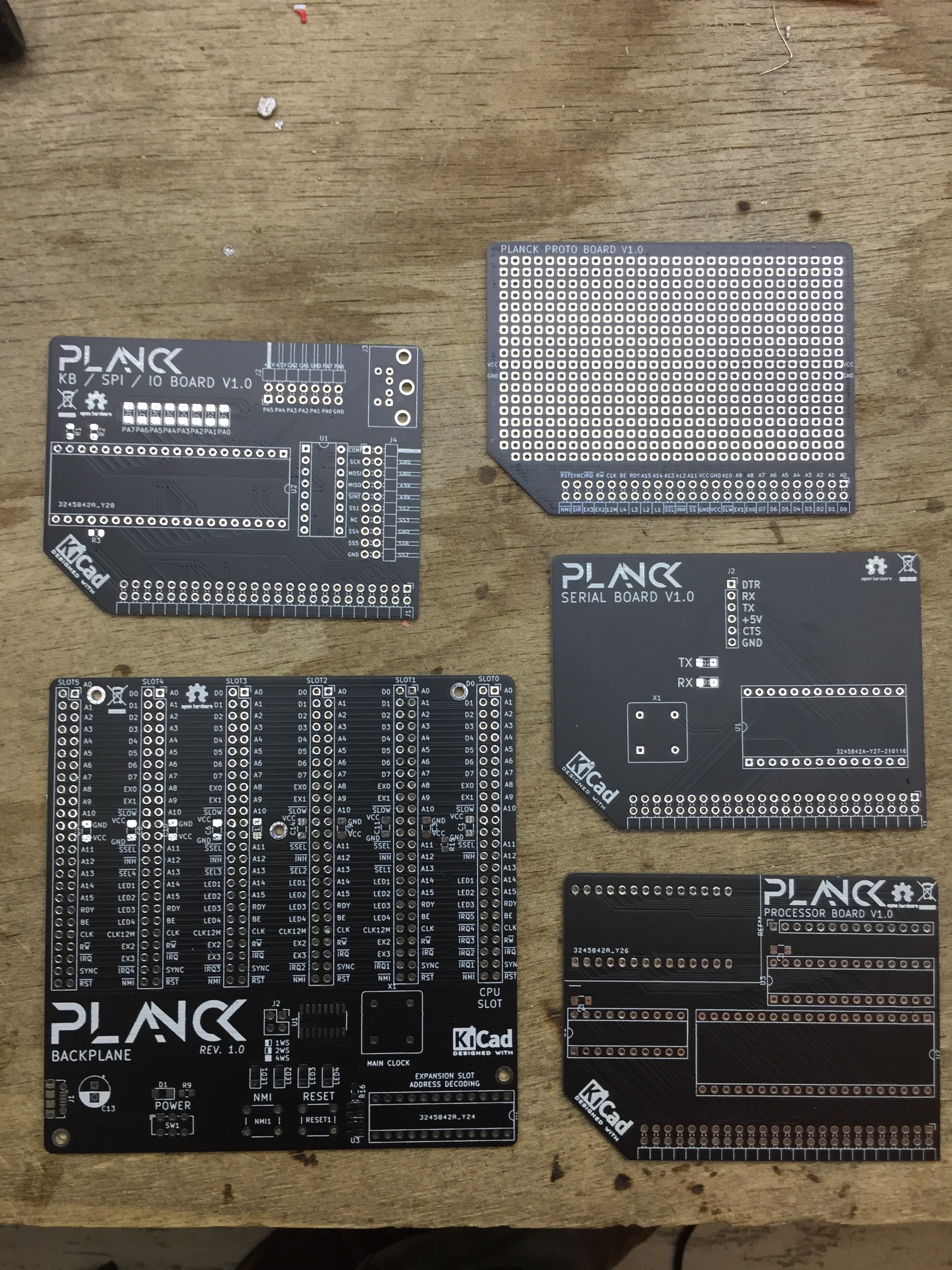

Finally, the prototype boards are in!
I'm quite happy with how they turned out. I'm still waiting on some components to be able to solder everything up. I'm quite impatient to try it out as you can probably guess.
From the top left we have the IO board with a 6522, PS/2 port, parallel port (VIA port A) and an SPI port with 7 slave selects, similar to the 65SBI specification but with the 12V power replaced with 5V. It has 8 onboard leds to display the port A value.
Then on the top right is a prototype board (I got 10 of these to be able to try out a few things)
Bottom left is the backplane itself, and then middle right is the serial board, which is just a 6551 with a header for a usb to serial adapter.
At the bottom right is the processor board, which includes a ZIF socket for ROM, a wide or narrow socket for RAM, a 16V8 to handle RAM/ROM address decoding and irqs, and the CPU at the bottom.

I looked at your clock stretching circuit published on Sun 10 Jan 2021 and I'm quite impressed to the extent that I may implement a variation of it. I doodled something similar but it didn't occur to me that the 4 bit state could wrap around. Your implementation has approximately double range and is therefore the preferable one. As I understand, it normally transitions between 15 and zero but if a slow cycle is required, it counts from nine to 15 and then transitions to zero. It then alternates between 15 and zero until the next slow cycle occurs. Unfortunately, there is less than 30ns to signal that a slow cycle is required.
The variant I'm intending to use with 74HC161 has separate inputs to D0, D1 and D2. This loads the counter with 14, 13 or 11 and therefore provides separate +1, +2 or +4 ticks. Including the unstretched cycle, this provides a processor high phase with a total of 1, 2, 3 or 5 oscillator ticks. (Erroneous states may incur additional ticks but are otherwise not adverse.) Allowing D0 low effectively switches bus phases. This option is superficially incompatible with many video circuits, DMA systems or dual processor configurations. However, selective use of 74HC161 clock inhibit may switch bus phase back. Therefore, in a typical use case, a processor on a split bus may remain in the wrong phase until it accesses video memory.
Adapting this back into your design using 40ns tick (or thereabouts) and 74AC11 triple input AND gates, you could have three boards with +2 wait states and three boards with +4 wait states. I/O is preferably placed from one end to use the fast slots. Whereas, cheap ROM is restricted to the slow slots where it has 200ns (or more) to respond. By flattening the logic, as recommended by BigDumbDinosaur, you also have the option of an extra three boards with +1 wait state. However, this would complicate video. Perhaps you could have a "desktop" configuration with six slots and video and a "server" configuration with nine slots and no video?

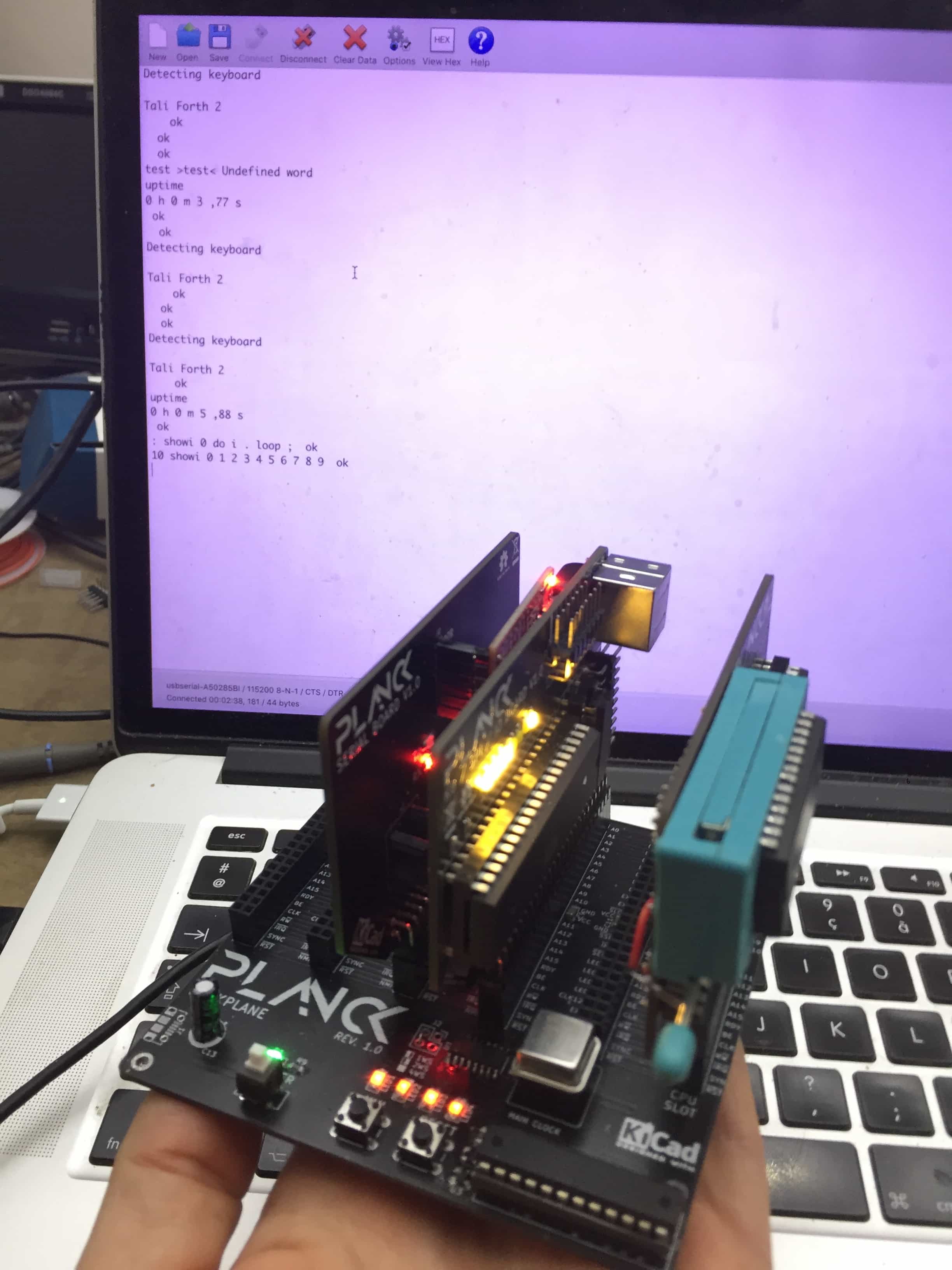

Hi everyone, an update on this. I have received most of the chips I was waiting for, so finished putting everything together today.
The design called for an ATF16V8 on the processor board to handle incoming interrupts and onboard RAM and ROM decoding. However they seem to have been misplaced in the mail. I was tired of waiting, so I decided to use one GAL22V10 instead. 4 pins float outside the board, but it doesn't really matter.
Well after all that, I am really pleased to report that everything works perfectly (over serial only for now) with only 3 or 4 bodge wires :mrgreen: Two of the boards (backplane and IO board) actually have none! :shock:
I am also very pleased to report that thanks to your help, the clock stretching circuit works like a charm. I have installed a 25 Mhz crystal (fastest I had) and everything runs at about 12.5 MHz without a hitch (so far). Only one wait state is necessary for the ROM.
Next step is to get the PS/2 keyboard working, which should not take very long since I already have working code, but will have to wait until next week because it's already late here and tomorrow is Monday 8)
All in all I am very pleased with how it turned out and very grateful to all of you for your help in getting to this point.
I have attached a picture of the computer running forth over serial.
Jonathan Foucher
