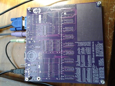

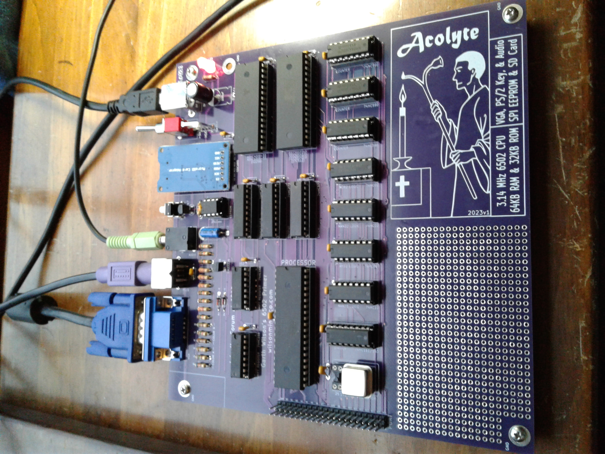

The boards came in and I just soldered everything. It took about 1.5 - 2.0 hours to solder everything and tidy it up. And most importantly, no bodges.
I did learn a few things here though:
1) The purple board is unusually dark for me, and I don't have a lot of good lighting in the office anyways. I was basically soldering blind. My daughter chose purple because it's technically her computer :) I prefer the classic green.
2) Some of the silkscreen from the gerbers didn't show up on the board! None of the 5 boards from JLCPCB had one particular silkscreen label. I checked the gerbers and they have it, so... IDK there.
3) In the future I need to look more closely at physical dimensions of components on Mouser. My expansion port 1x20 pin headers are super tall, and my 0.1uF bypass caps were not my favorite with the bent leads for easy insertion.
The next thing to do is try to attach the 6522 VIA through the expansion port. That will be a fun exercise!

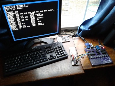

Alright! Now the 6522 VIA is working also! Attached are pictures.
I have made *one* tiny little bodge now, adding PHI2 to my expansion port. Like, why *didn't* I design it like that. Duh.
I have also updated my Github with the adjusted schematics and gerbers.
Still more testing to do. I would like to see if I can get the PS/2 Keyboard exclusively off of the VIA. And of course an LCD is in the future. Lastly, I'd like to hook up the Genesis controller and somehow play Tetris and Space Invaders with that! :)
Thanks everyone. Today was a good day.
Chad

Hi Chad, great that the new board is working!
I had a couple of questions about the PCB design:
1. What settings do you use for trace widths and clearances?
2. Did you figure out why some of the graphics were missing? Was it on the wrong layer, or maybe lines that were too thin to print?
