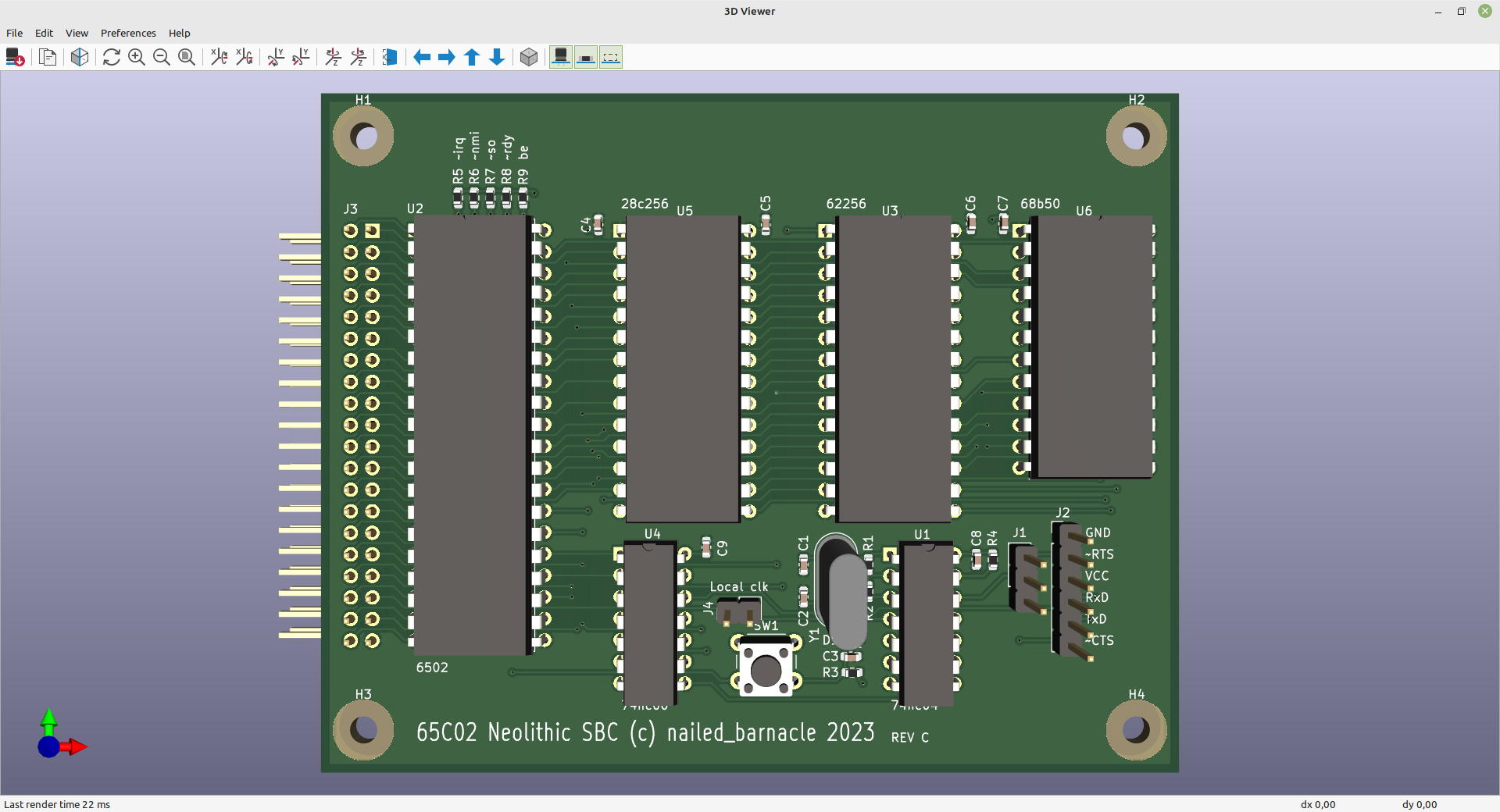

Well, as it happens, I'm currently playing with such a design - though caveat: mine requires a 74HC04 for the oscillator to work as designed. From the chips in the pack, it looks intended to be used with Grant Searle's minimal design - though I don't know what the LS07 is for.
Fits nicely onto a half-eurocard (80 x 100mm), I had it made by JLCPCB who deliver quickly into Germany, even on their slowest/cheapest mail.
grant.pdf [100.15 KiB]
Downloaded 32 times
