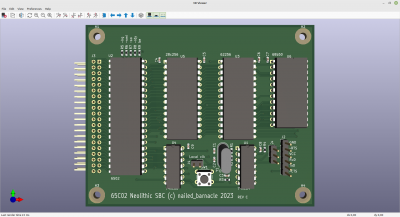

 Post subject: Re: Current 6502 Kits
PostPosted: Sat Jan 28, 2023 7:31 pm
Posts: 1117
Here is a 6502 kit idea: You can buy kits on eBay with collection of IC. Here is $10 + $6 shipping for "Barebones/minimal 6 chip 6502 computer IC kit". I just ordered one, it says "118 sold". Yes, I understand 6502 from eBay is particularly problematic but this one is Rockwell R65C02 which tends to be less problematic. The rest of the kit should be OK.
The idea here is to design an open-source pc board 100mmX100mm that'll work with this set of IC. It is cheap to order pc board and combine with the eBay kit to build a economical 6502 kit. I'll wait for the kit to show up and make sure they work, then I'll post a design challenge for a 6502 SBC using this kit. 118 kit sold, there MUST be a number of people have designed with this kit already.
PS, I have done this before: Almost 4 years ago I notice the same seller were selling a simple Z80 kit for $7. I bought one and designed a Z80 SBC called Simple80. That kit is still available almost 4 years later, 102 sold. I order two kits a month ago, built both up and both worked just fine.
PostPosted: Sat Jan 28, 2023 9:22 pm
Posts: 983
Well, as it happens, I'm currently playing with such a design - though caveat: mine requires a 74HC04 for the oscillator to work as designed. From the chips in the pack, it looks intended to be used with Grant Searle's minimal design - though I don't know what the LS07 is for.
Fits nicely onto a half-eurocard (80 x 100mm), I had it made by JLCPCB who deliver quickly into Germany, even on their slowest/cheapest mail.

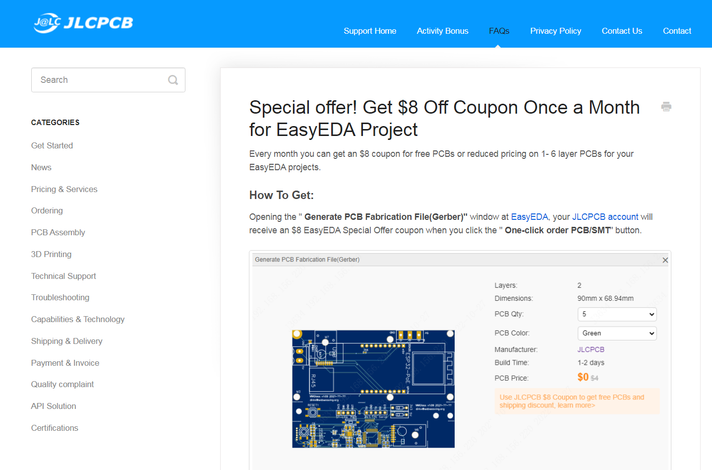

Posts: 589
There are a few 'public' PCB layouts for Grant Searle's 6502 design on the EasyEDA site. I think you could use most of the parts in that kit plus a few more bits and bobs. Here's one design (see below). Bring the design into EasyEDA and get the once-per-month $8 discount to get 5 PCBs from JLCPCB for almost free ($1, using the 'economy' shipping method).
