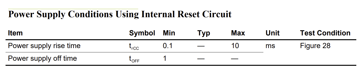

The Hitachi datasheets currently available online (excerpt below) state that the internal reset can fail if power supply conditions are outside the supported envelope. So that is a documented scenario in which the 3x initialization (which the datasheet calls 'initializing by instruction') is required. Of course I have no idea if that could have been what Garth experienced back then at work.
That said, I think OPs main problem (as I posted earlier) is the code they are using does not include the LCD busy flag checks - the code they posted is an interim simplified version designed for a 'slow' clock module. I know from experience it produces garbled output when run at 1MHz, which happens because at that clock speed it sends commands to the LCD controller while it is still busy executing prior commands.

I dug up and examined the old circuit, and I calculate that the power should have come up on the LCD in about 0.25ms.  I don't have any of the old hardware here to measure.
But yes, it is imperative that you check the busy flag if there's a possibility of going too fast for the LCD to process the inputs.
