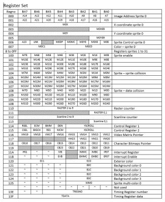

Re: Video Card - Registers
Planned register set for video controller. The video controller internally decodes the register set to address $D00xxx
Missing yet is possibly color palette control.
