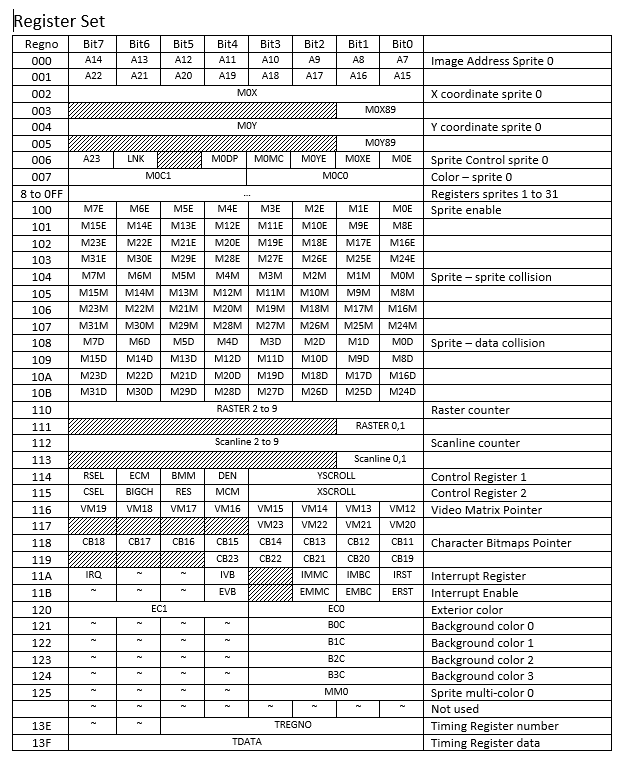

PostPosted: Fri Jul 22, 2022 3:40 am
Posts: 460
Planned register set for video controller. The video controller internally decodes the register set to address $D00xxx
Missing yet is possibly color palette control.
