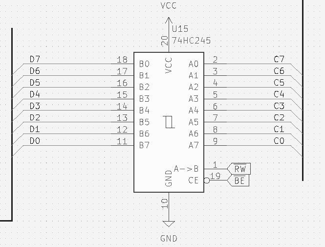

Just spent 4 hours probing this thing. I believe I found the databus contention.
Attached is the picture of the '245. The /CE line is connected directly to /BE, which means that it is active as long as the processor is active on the address bus. Cool.
What is not cool is that the C databus from the RAM is sometimes floating during that time when ROM is enabled but RAM is disabled. So the '245 is forcing a floating value (whatever it feels at the time) onto the D databus when the ROM is also pushing data onto the D databus.
How I found this was that I removed everything besides 6502, ROM, and clock stuff and it worked fine. NOP test ran perfectly. I put the RAM back in, and it still worked, but when I put the '245 back in it was not working. I changed out the '245 with another one and same results. And I put all these chips back into my working board and it's fine. So:

\CE on the HC245 should only be low if BE is high and A15 is low, i.e. the CPU is accessing RAM. So you need some more gates - unfortunately it doesn't look like you've got any spares on the existing chips, so you'll need to add another chip to the board, probably bodged on 'dead bug' style.

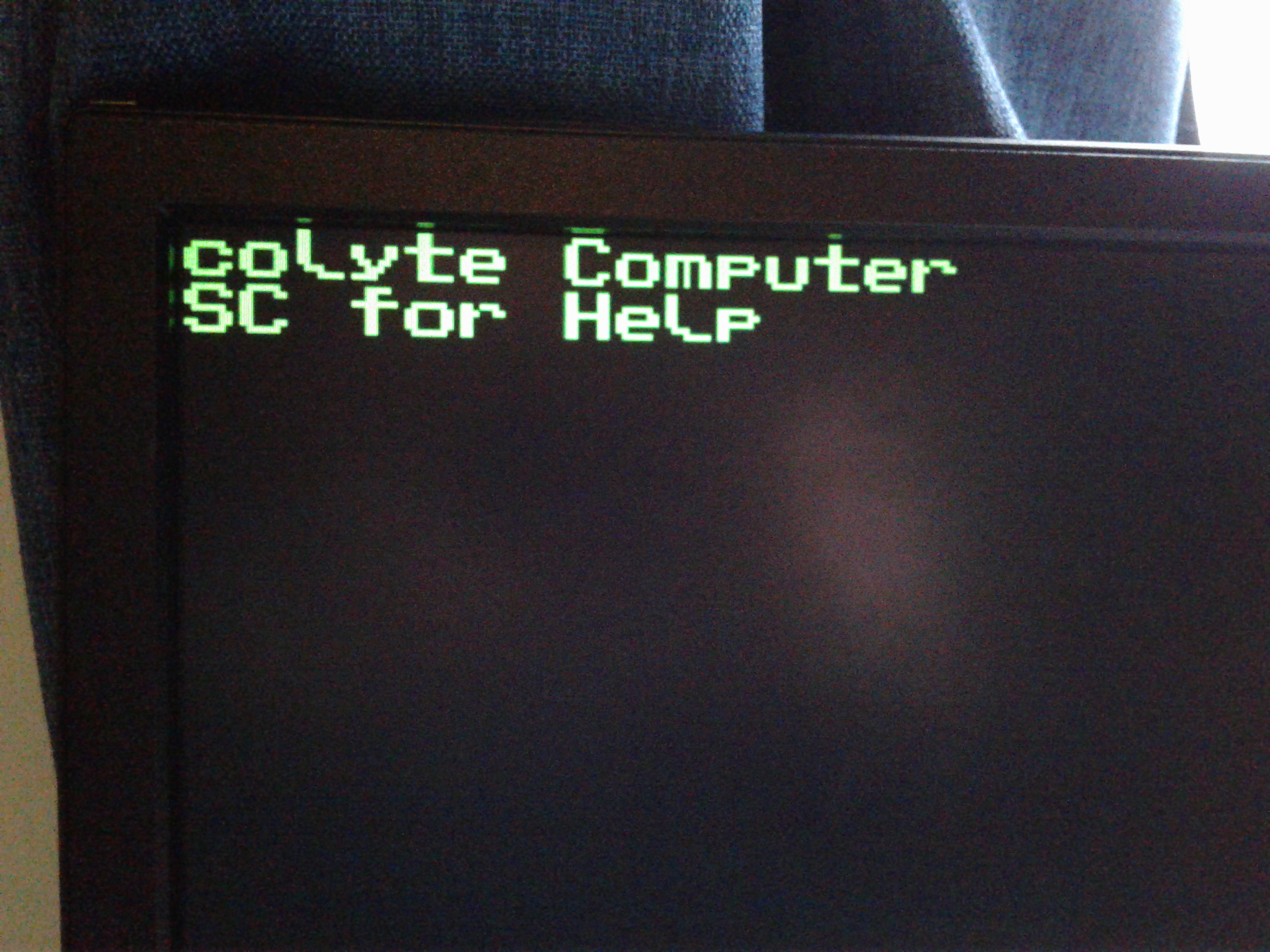

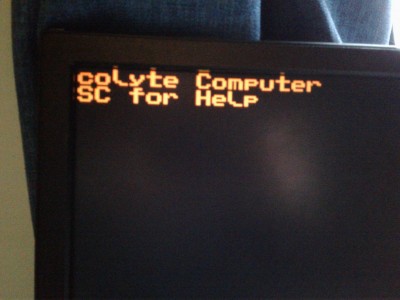

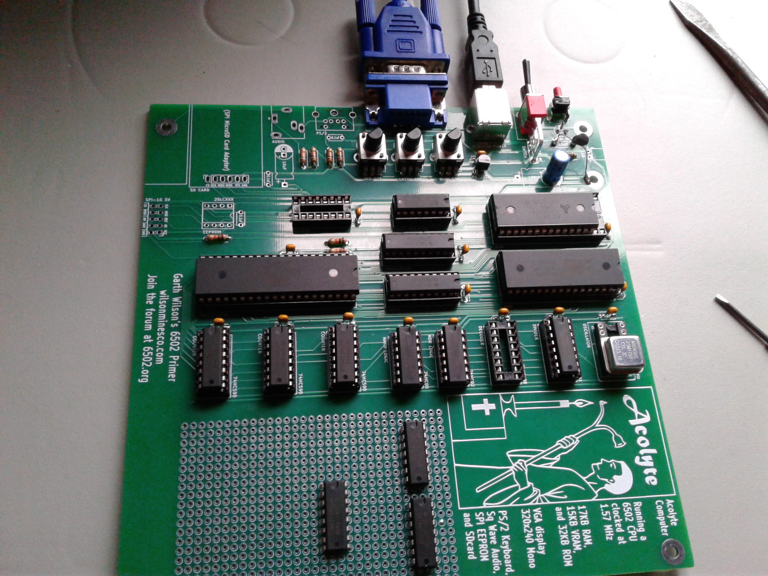

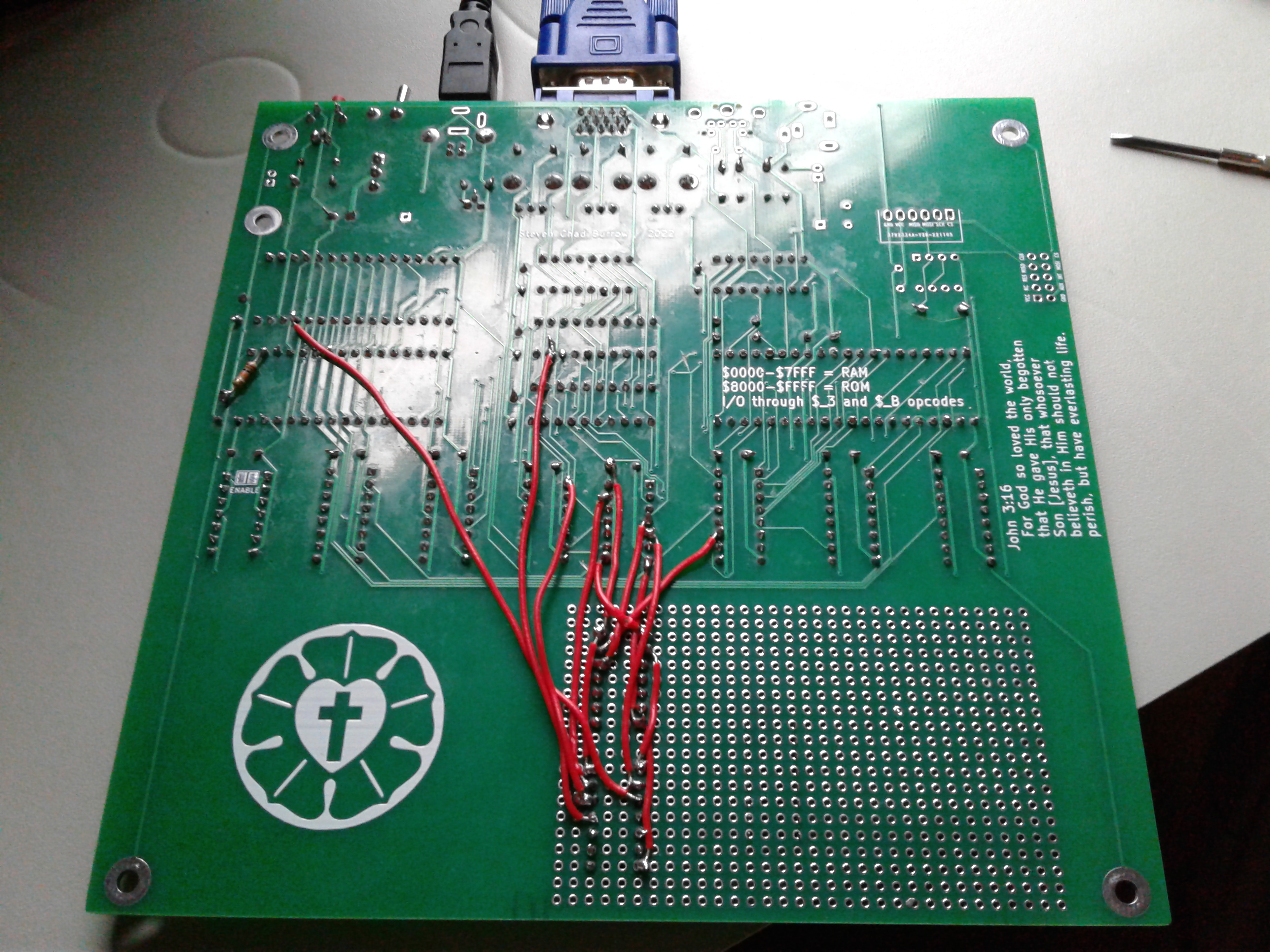

It works, it works!!!
Attached are some pics. The board had locked up because my PHI2 was touching /PHI2 with my bodge wires. I thought 2.5V on that line was strange!
Anyways, the *main* change was that transceivers /CE now is only selected when PHI2 is high AND /ROM is high. That is, only when the RAM is being selected does the '245 send data through. I made other changes to the PHI2 and BE timing, but I doubt that really made a difference.
So, some things I have learned:
1) Put a through-hole testing area on the board, VERY easy to solder some additional chips on there, dead-bug style is way too hard for me.

3) 1.57 MHz is too slow. If you see in the pics, the first letter is always cut off. The reason for this is because the ROM sync signals I use are just spread too thin, divided down too much. The VGA monitor is also complaining because it is saying it is 59 Hz, instead of the 60 Hz it should be. I've never had issues running the ROM sync signals at 3.14 MHz though.

If you move the position of the horizontal sync pulse by 1 character (the period of your 1.57MHz clock is equal to 16 VGA pixel times, which is 1 character position in your set up, as far as I can see) would that not correct the missing character at the beginning of the line?
Also, the monitor complaining about wrong refresh rate seems a bit suspicious. Surely if your pixel clock is correct and your division ratios for horizontal and vertical timing (800 total pixels horizontal, of which 640 are visible; 525 total lines vertical, of which 480 are visible) the refresh rate should be as expected?
PostPosted: Sun Nov 20, 2022 7:41 pm
Posts: 718
Congrats on getting it working!
Thank you! Yes about shifting the character over. But that's yet another sign that it is not working properly.
I use a ROM for all of the video sync and reset signals. Obviously it's working, but because I'm dividing it down 16 times, the resets and all that are just barely off. The missing character demonstrates that indeed those values are just slightly off. I could try to adjust my ROM, that was my first guess, but I went back over it recently and found it... exactly as I figured would work.
None of this happens when running it at 3.14 MHz of course, so that's my next board's goal. Also, running it at 3.14 MHz allows for 80-column mode, which this board is simply incapable of doing.
