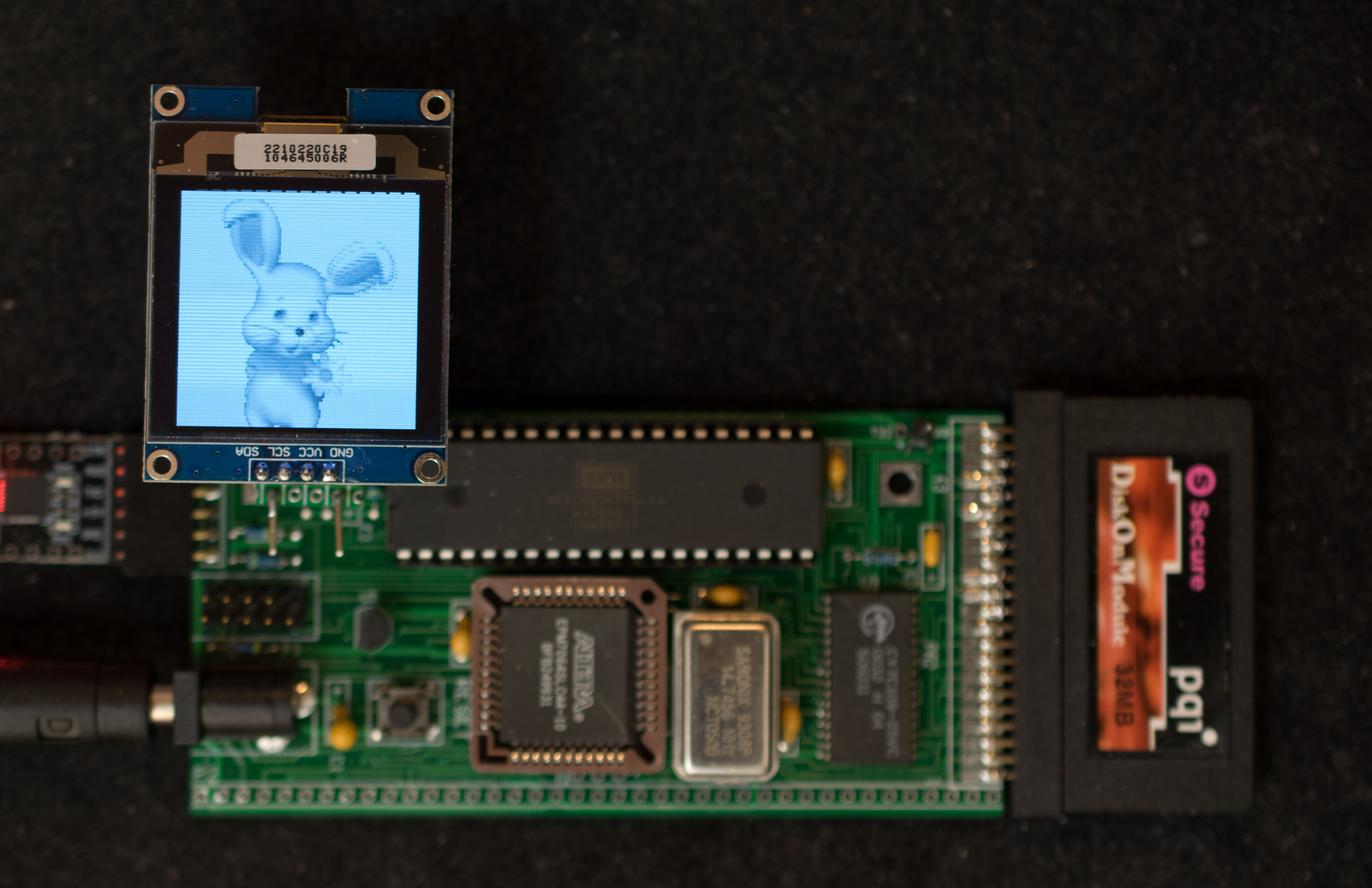

I started out with a random animated GIF from the Web, resize it to 128x128, extracted into individual files and stored them as collection of 4-bit .bmp files. Each .bmp file contains 8K of graphic data. The BMP animation program in CRC65 receives each file, reformat, displays, and stores it in memory up to six 8K files. It then display these files continuously in a loop. The frame rate is around 6 frames/sec.
The display loop is limited by the size of CRC65 RAM memory; a better program is storing the data in the CF for playback.

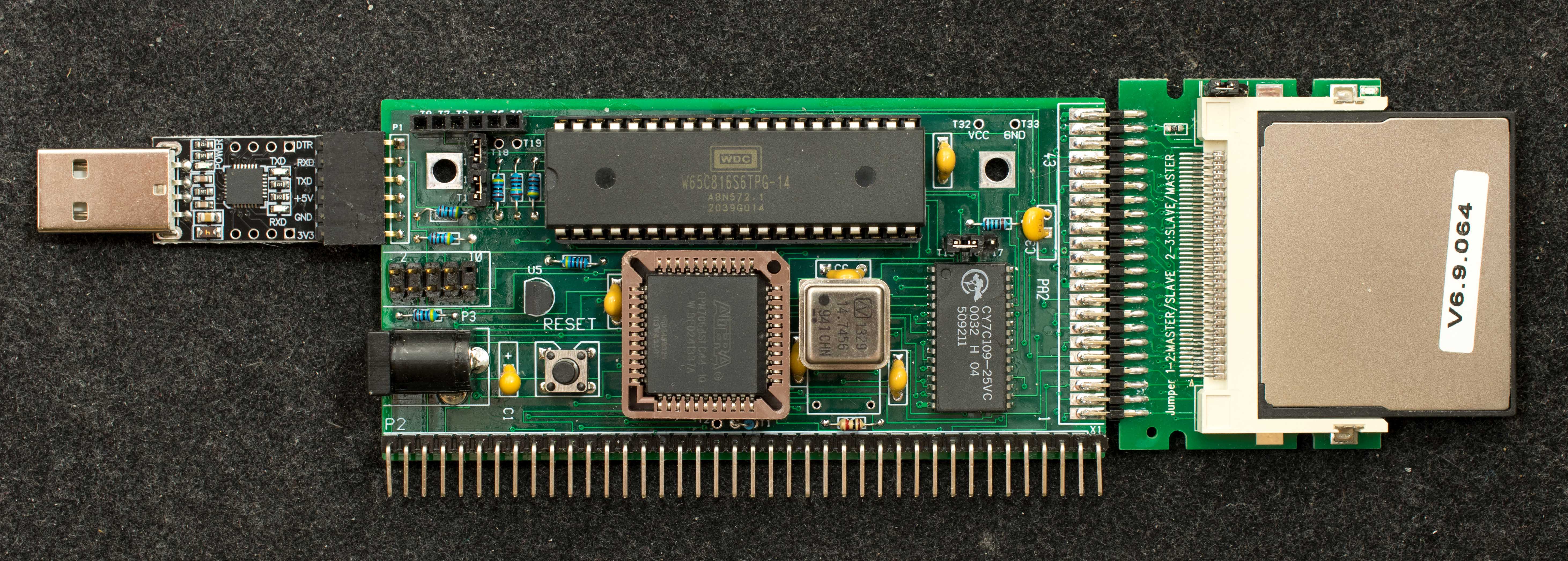

Since everyone is doing 65816 I might as well join the party and show rev2 of CRC65 which is dual W65C02/W65C816 design. Selection of 6502 or 65816 is via few jumper changes and a different CPLD firmware. The 128K (CY7C109) RAM provides 58K of RAM when configured to W65C02 or 116K of RAM while configured to W65C816. The nominal CPU clock for both 6502 and 65816 is 14.7MHz. Pictures show CRC65 with W65C02 and with W65C816. Documentation is work-in-progress at here:
https://www.retrobrewcomputers.org/doku ... rc65r2home
File comment: CRC65 rev2 configured to W65C816
File comment: CRC65 rev2 configured to W65C02

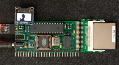

This is 25 second of BadApple!! on CRC65's I2C interface driving a 128x64 OLED. The original full length video is 155 seconds animated GIF at resolution of 360x270 playing.at 20 frames/sec. The original video is down sampled to 85x64 GIF then splited into 3100 frames of images and converted into format suitable for displaying on 128x64 OLED display. The resulting data file is 3.1meg and stored as a contiguous binary file on CRC65's CF disk. A BadApple player written in 6502 assembly retrieves data from CF disk and writes it to the 128x64 OLED display via I2C. It can write a frame in 31mS so 19mS software delay is inserted to produce 20 frames/sec video.

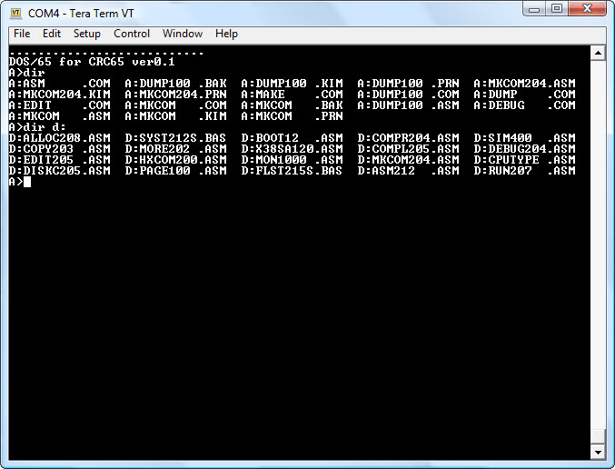

Porting DOS/65 to CRC65 is high on the list of my winter projects. I have made some progress and post it here, but to stay on topic I want to post further progress here.
I designed the DOS/65 disk format to be compatible with my CP/M disk format on Z80 so I can exchange files and debug problems. That particular disk format has 1 track (128KB) set aside for system files. So that is where I stored DOS/65 system files (CCM,PEM,SIM) along with CRC65 monitor. The auto-start code located in CF's master boot record is modified to copy 27 sectors of CF data on the system track to RAM from $b200 to $e7ff and then jump to start DOS/65, this way DOS/65 will boot directly after a power cycle. I still can access CRC65's hardware monitor by execute a "go $b400" in DOS/65 prompt. Since CCM and PEM are stored in system track of the CF, DOS/65's warm boot routine can simply copy CCM and PEM from CF's system track to memory.
I want to assemble DOS/65 programs natively on CRC65 but it is a chicken-egg situation where I need 6502 executable assembler installed first. Executable ASM.COM is not available since all the files on DOS/65 ver2 distribution are in assembly source text. So I assembled ASM212.ASM using CA65 assembler then transfer the executable over to DOS/65 and save as ASM.COM. It seems to assemble other source files correctly but it only generates KIM-1 compatible binary. The provided KIM-to-COM conversion program (MKCOM) does not seem to work at the moment. This is where I am stuck right now.
The attached screen capture shows CRC65 auto boot into DOS/65 after reset. Drive D are DOS/65 ver 2 distribution files and drive A are files assembled used ASM.COM. I'm making progress.

DOS/65 is now running on 29.5MHz CRC65. It uses exactly the same files as 14.7MHz CRC65, except the serial port is running at 230400 baud. Other than checking overclocked CRC65 has no unexpected software issues, the real motivation was to run Dan Werner's screen editor, sedit, which uses serial port to update the screen that can be somewhat slow even at 115200. sedit does work better with 230400 baud, but has the same bugs as 115200 baud. I did encountered a strangeness at 29.5MHz; that XMODEM receives file perfectly at 230400 baud at 12KByte/s, but with 14.7MHz and 115200 baud XMODEM is struggling with numerous retries.
Attached is CF image of DOS/65 rev0.2. Unzip and copy to a new CF disk (32MB or bigger) using disk imaging tool such as Win32DiskImager. It should autoboot into DOS65 and you should see the same files as the screen capture below. Works are in progress for the 3 programs below:
DBASIC.COM is EhBASIC ported to DOS65 but LOAD and SAVE do not work
SEDIT.COM is Dan Werner's screen editor
XMODEM.COM is flaky at 14.7MHz as noted above.
DOS65_r02_CF_image.zip [1.47 MiB]
Downloaded 55 times
