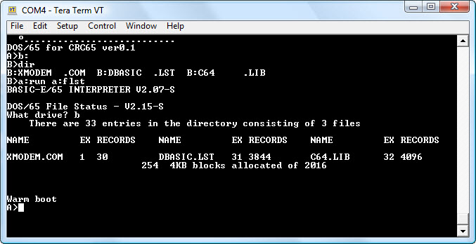

Porting DOS/65 to CRC65 is high on the list of my winter projects. I have made some progress and post it here, but to stay on topic I want to post further progress here.
I designed the DOS/65 disk format to be compatible with my CP/M disk format on Z80 so I can exchange files and debug problems. That particular disk format has 1 track (128KB) set aside for system files. So that is where I stored DOS/65 system files (CCM,PEM,SIM) along with CRC65 monitor. The auto-start code located in CF's master boot record is modified to copy 27 sectors of CF data on the system track to RAM from $b200 to $e7ff and then jump to start DOS/65, this way DOS/65 will boot directly after a power cycle. I still can access CRC65's hardware monitor by execute a "go $b400" in DOS/65 prompt. Since CCM and PEM are stored in system track of the CF, DOS/65's warm boot routine can simply copy CCM and PEM from CF's system track to memory.
I want to assemble DOS/65 programs natively on CRC65 but it is a chicken-egg situation where I need 6502 executable assembler installed first. Executable ASM.COM is not available since all the files on DOS/65 ver2 distribution are in assembly source text. So I assembled ASM212.ASM using CA65 assembler then transfer the executable over to DOS/65 and save as ASM.COM. It seems to assemble other source files correctly but it only generates KIM-1 compatible binary. The provided KIM-to-COM conversion program (MKCOM) does not seem to work at the moment. This is where I am stuck right now.
The attached screen capture shows CRC65 auto boot into DOS/65 after reset. Drive D are DOS/65 ver 2 distribution files and drive A are files assembled used ASM.COM. I'm making progress.

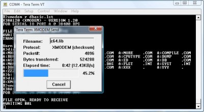

Re: CRC65, A frugal 6502 SBC
Larry,
I'm very interested in your feedback.
Another strangeness with XMODEM: I can transfer 481K file to DOS/65 OK, but when I try to transfer 1meg file, it stuck at 524288 bytes which is exactly 1/2 meg. When I use the file status program (flst215s.bas) to read the directory info, I see the directory has 32 Extends and 4096 Records. Either DOS/65 has a 32 extends limit or XMODEM can only transfer 512KB of data.
DOS/65 is now running on 29.5MHz CRC65...I did encountered a strangeness at 29.5MHz; that XMODEM receives file perfectly at 230400 baud at 12KByte/s, but with 14.7MHz and 115200 baud XMODEM is struggling with numerous retries.
XMODEM is an inefficient, compute-bound protocol of very questionable value in a hardwired data link that spans only a few meters. Reducing the Ø2 rate by one-half is likely leading to some sort of overrun condition as your host system sends XMODEM packets faster that your client (CRC65 unit) can process them. That would explain the errors and retries.
That your machine can only generate a throughput of 12 KB per second running with a 29.5 MHz Ø2 rate and a 230.4 Kbps serial link rate (note: it is bits-per-second, not baud, when using a hard-wired link) is telling. Using 8N1 data format and accurate UART clocking, 230.4 Kbps results in a transfer rate of exactly 23,400 bytes per second, disregarding the effects of flow-control. An XMODEM packet is uniformly 132 bytes in length, hence it is possible for packets to arrive at 5.64 millisecond intervals (~177 packets per second), assuming your client is checksumming and ACKing packets with alacrity. Of those 132 bytes, 128 of them are payload data, so the effective data throughput on the serial link is ~22 KB per second, best-case, nearly twice the rate at which your client is processing packets.
On my POC units, I transfer data via Motorola S-records. In a hard-wired link, especially one that is only a few feet in length, TIA-232 can be considered 100 percent glitch-free, assuming use of a connection of reasonable quality. Therefore, I limit error-checking to the checksum that is sent as part of each S-record. Since the likelihood of an error is vanishingly small, I simply terminate the transfer session if an error does occur. Hence I avoid the back-and-forth overhead that is part of XMODEM.
On POC V1.3, which runs at 16 MHz, I achieve ~13 KB/sec throughput during a load, with the serial link running at 115.2 Kbps. I/O accesses are wait-stated for one clock cycle, said accesses occurring in the UART interrupt service routine. An S-record is an ASCII hex representation of the data being transferred, which means a lot more bytes have to be moved than in a same-size XMODEM transfer. Considering that and the throughput I am achieving on a slower machine using a slower data link should help you understand why XMODEM is such a poor choice.
XMODEM packets are sequentially numbered from 1 to 255. Due to the way in which the packet number is processed, this pattern can repeat as many times as necessary until all data has been transferred. Hence there is no theoretical transfer size limit, since the XMODEM session won’t terminate until the host sends ASCII <EOT> ($04) to the client.
Well, a couple things:
1- The Xmodem utility that is packaged as part of DOS/65 is very inefficient, i.e., very very slow. It's the code itself, not the connection speed. It also uses the older single byte checksum. I have my own Xmodem CRC-16 code that I use with my C02Monitor and it's very quick, runs at full speed and the CPU has enough time to generate the CRC-16 checksum for each packet on the fly (no lookup table). I've considered writing a Xmodem utility for DOS/65 but have yet to really think about it, much less get started.
2- It would appear that DOS/65 has a limit of 512KB for a single file... I found the same thing, albeit with the same Xmodem utility. I'll probably write a small utility to create a disk file and just throw 128-byte records into it until it forces an error. I also want to try creating a larger disk than the 8MB, which I just stuck with when Rich sent me his ROM version.
