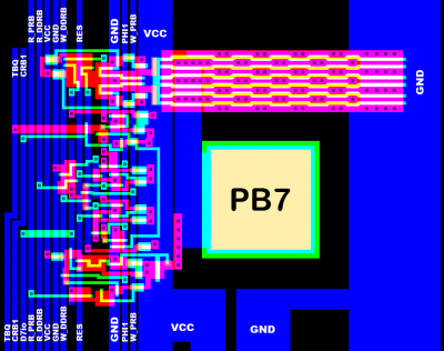

4c) PB6 and PB7 have "open collector" outputs with a pullup to VCC.

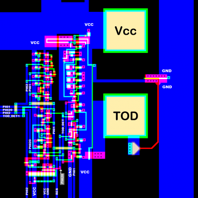

5b) TOD pad has a pullup to VCC.

14) TOD (time of day) is a 24 Bit binary counter, counting rising edges on the TOD pad without a prescaler.

4c) PB6 and PB7 have push/pull outputs with a pullup to VCC.

5b) TOD pad has no pullup to VCC.

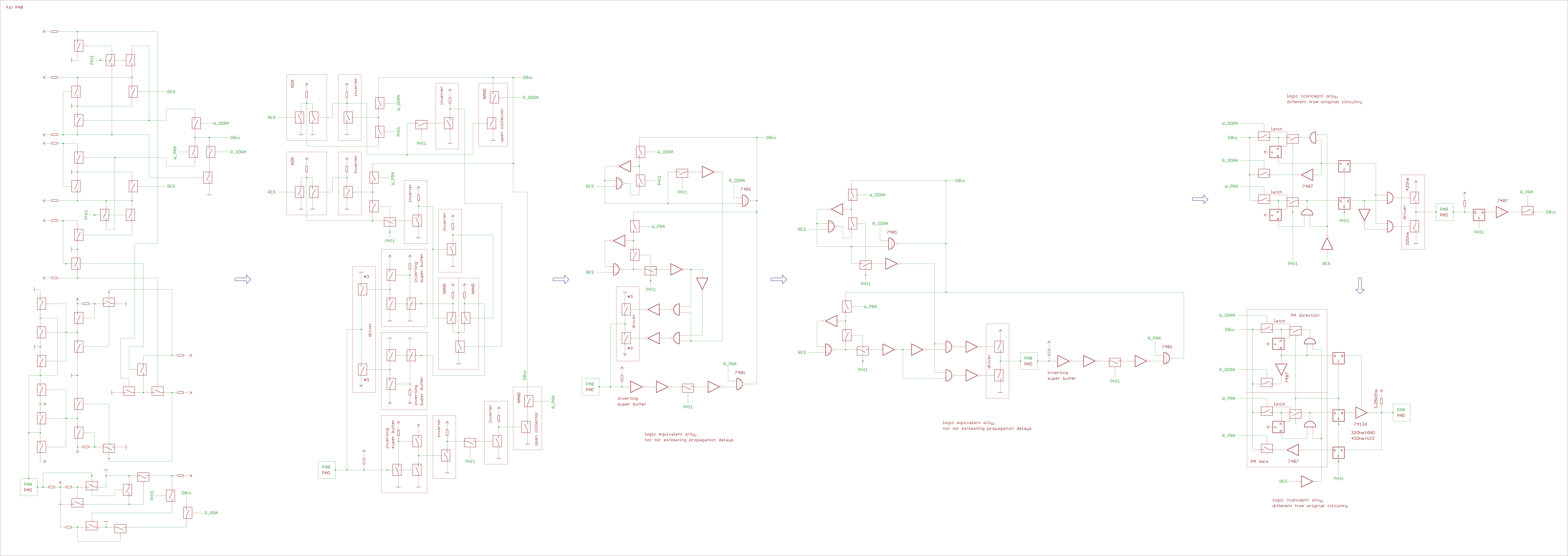

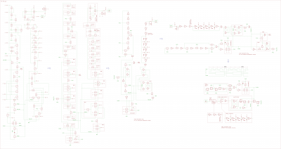

8520r4_dissect_schematics.zip [782.02 KiB]
Downloaded 75 times

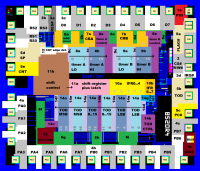

A picture of the 8520R4 silicon, with the interesting areas marked.

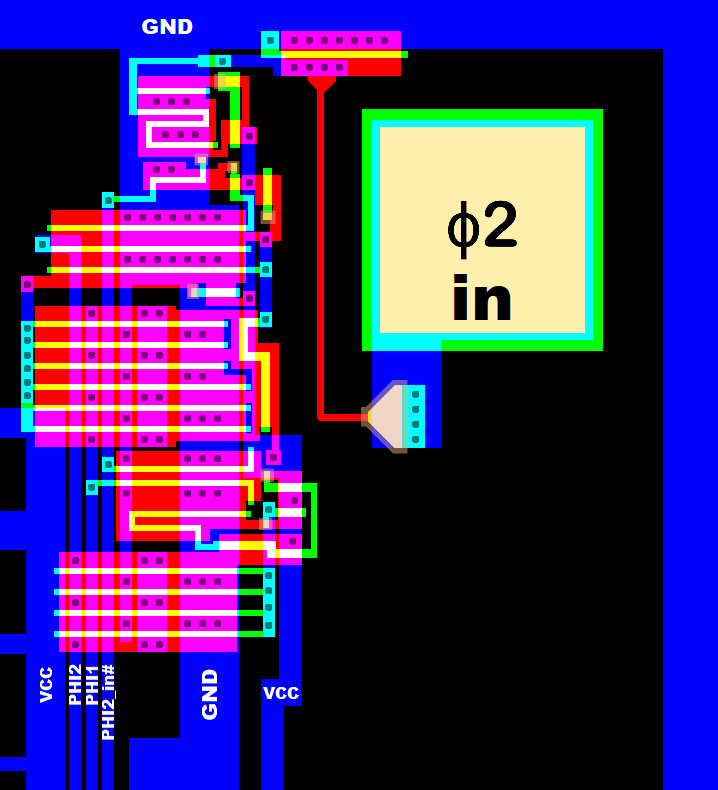

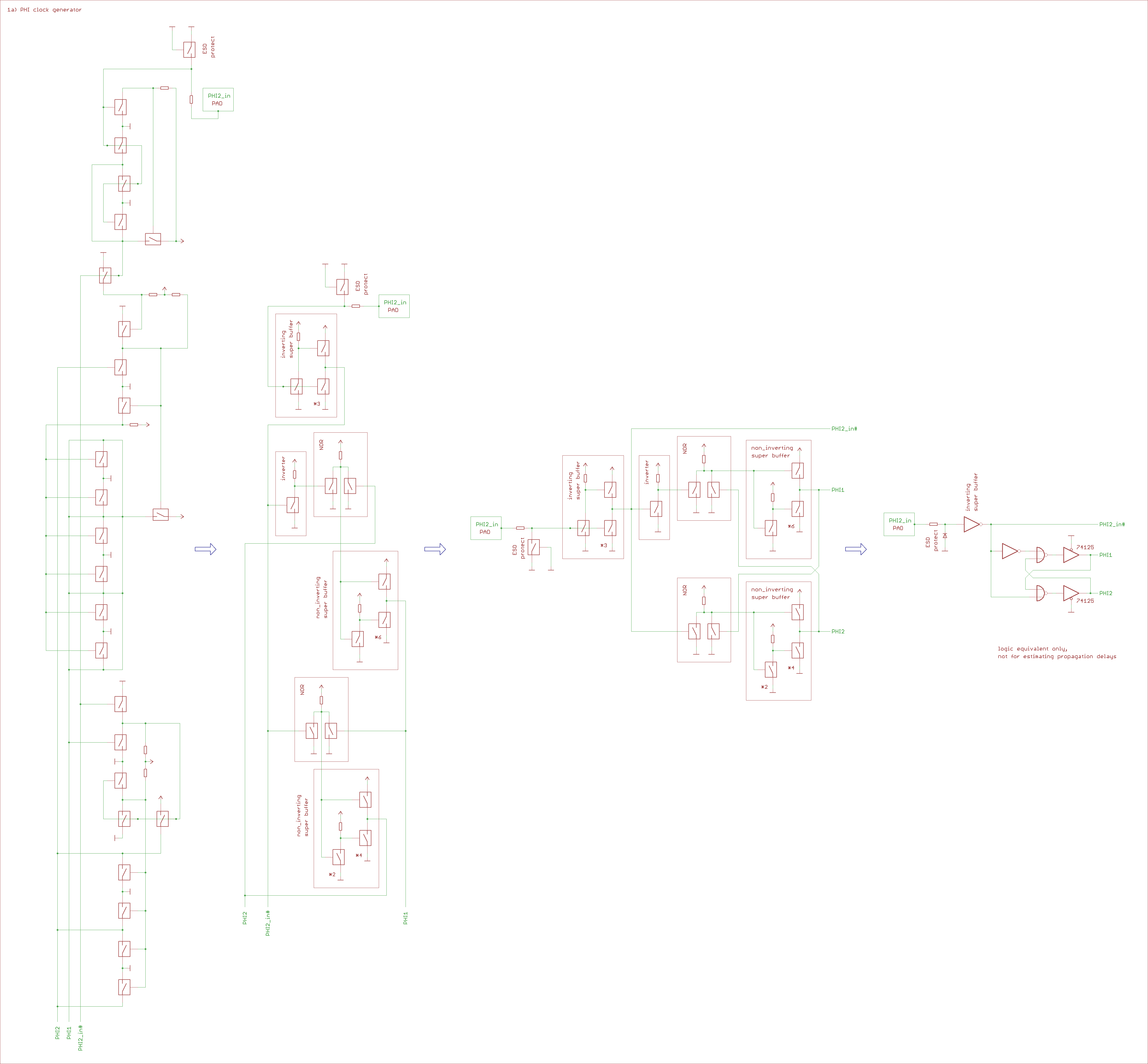

1a) PHI clock generator
Nothing special here.
The external high_active PHI2_in clock signal goes into an inverting super buffer,
which gives out the low_active PHI2_in# clock signal.
PHI2_in# controls a RS flipflop.
The RS flipflop is built from two NOR gates,
the output of every NOR gate is boosted with a non_inverting super buffer,
the super buffers emit the chip internal non_overlapping high_active clock signals PHI1 and PHI2.
Also, PHI2_in# goes into the "2) CS#, R/W#" circuity for generating
the low_active read/write control signals RD# and WE#.

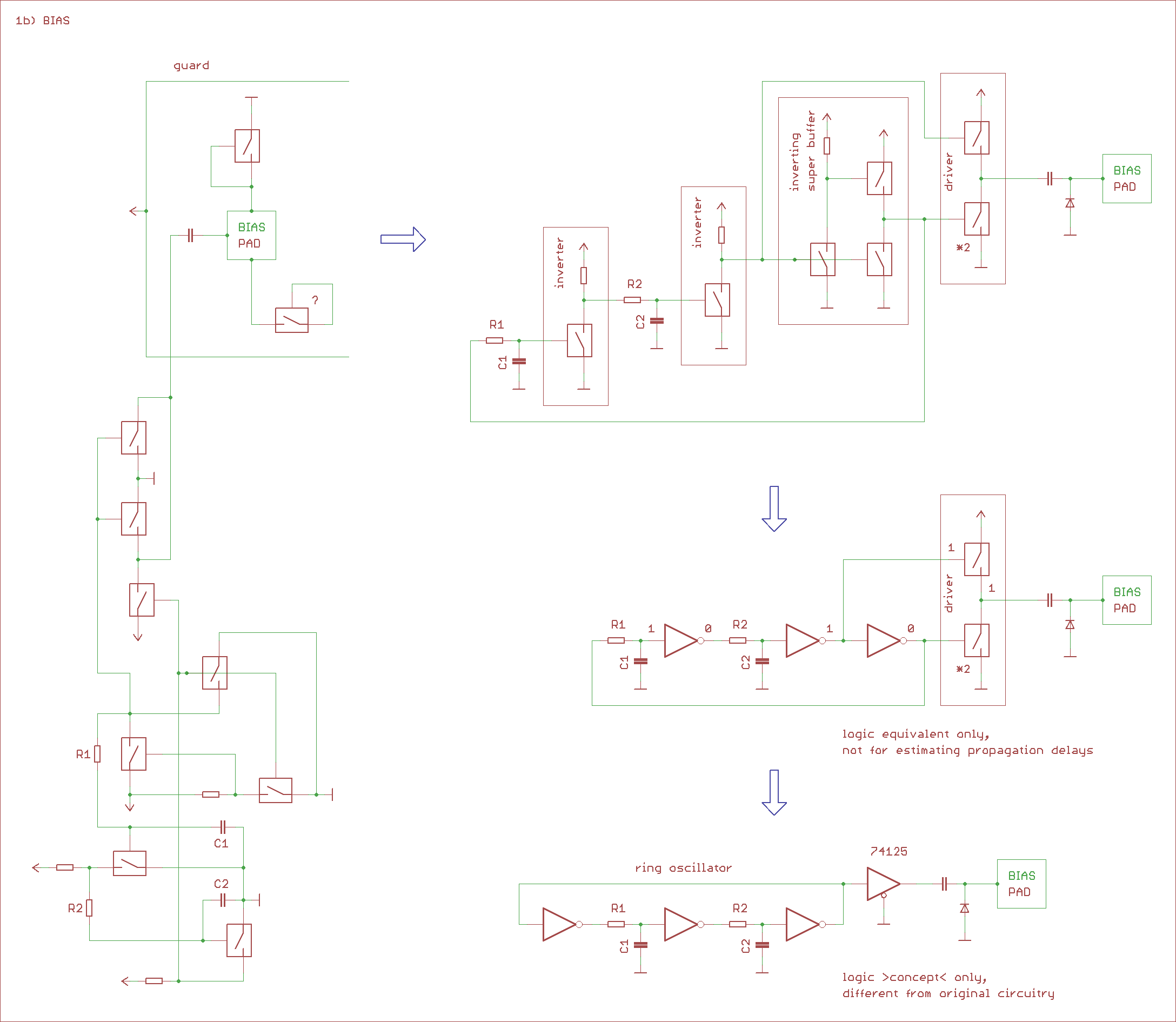

1b) bias generator
Basically we have a ring oscillator, buit from three inverters.
In the signal path of the oscillator, R1\C1 and R2\C2 set the frequency.
The oscillator output goes through a driver, then through a big capacitor,
at the other end of the big capacitor we have a FET working as a rectifier diode
for generating the negative bias voltage.
The big capacitor is hidden below the BIAS pad.
There is another FET at the East of the BIAS pad,
marked with "?" in the silicon picture.
I don't know how to interpret that FET,
but I assume it was added for smoothening the switching transients.
Also note, that there is a guard tied to VCC at three sides of the BIAS pad,
for shielding the rest of the chip against the hot end of the bias generator.
In the 8521 layout, the layout of the bias generator looks completely different,
I assume that MOS did a lot of tinkering with these bias generators
until them bias generators had worked as intended...

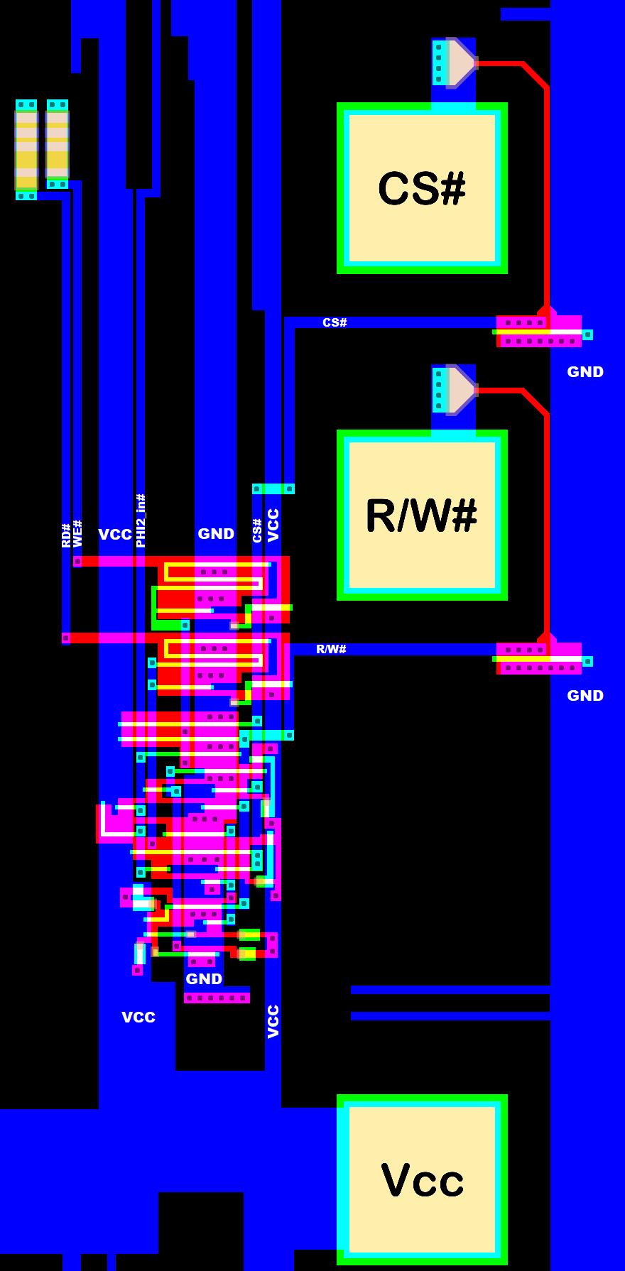

2) CS#, R/W# circuitry
It generates the low_active read/write control signals RD# and WE#,
which go into "6) address decoder".
Conceptually, the game is similar to what we had in the 6702 SuperPET dongle chip.
The RD# and WE# signals also go into "3c) D0..D7"
for controlling the buffers/drivers sitting between the external and the internal data bus.
Note, that RD# and WE# also go into "14b) TOD control".
The low_active RD# read control signal comes out of an inverting super buffer,
which is fed by the push/pull output of a three input NOR gate.
At the inputs of the (three input) NOR gate, we have:
PHI2_in# (which is LOW when PHI2_in is HIGH), generated in "1a) PHI clock generator",
The low_active signal from the CS# pad (which indicates that the chip is selected),
The inverted signal from the R/W# pad.
To make it short:
RD# goes active when the chip is selected with CS# = LOW,
and when R/W# = HIGH indicates a read,
and when the system clock PHI2_in = HIGH.
The low_active WE# write control signal comes out of another inverting super buffer,
which is fed by the push/pull output of a four input NOR gate.
At the inputs at the (four input) NOR gate, we have:
The low_active signal from the CS# pad, which indicates that the chip is selected,
The R/W# signal from the R/W# pad,
the R/W# signal from the R/W# pad delayed by an inverting super buffer plus three inverters.
To make it short:
WE# goes active when the chip is selected with CS# = LOW,
and when R/W# = LOW indicates a write,
and when R/W# was LOW for some time (where "time" is defined by the propagation delays of an inverting super buffer plus three inverters)
Means the falling edge of R/W# is delayed.
In the C64, the VIC-II uses the bus during PHI2 = LOW, and the CPU uses the bus during PHI2 = HIGH.
Because of this, it takes some time after the rising edge of PHI2 until the R/W# signal generated by the CPU is valid.
I think that's why the designers had added a delay to the 8520 responding to R/W# = LOW writes.

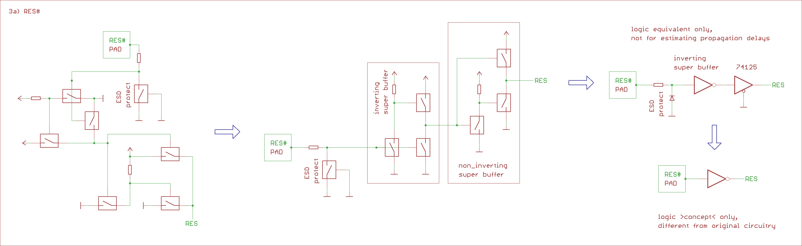

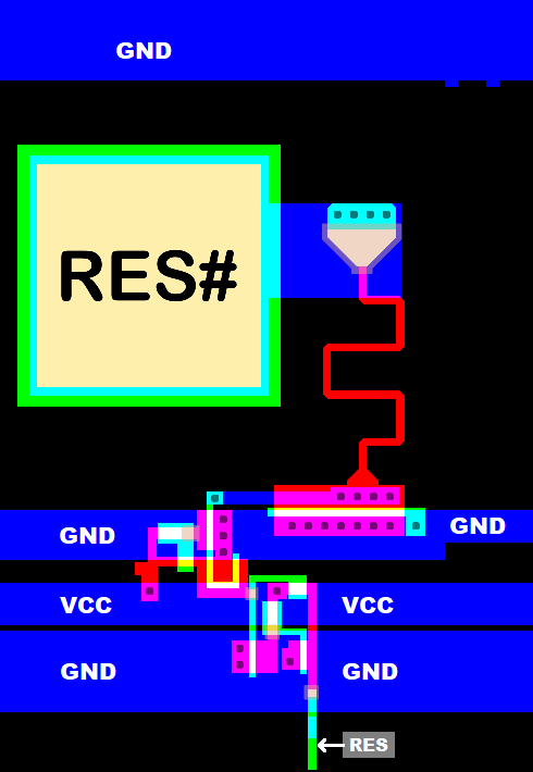

3a) RES#
The low_active signal from the RES# pad goes through an inverting super buffer,
then through a non_inverting super buffer, which emits the high_active RES signal.
RES resets the circuitry on the chip.
Note, that RES# is not synchronized with any clock signal when it becomes RES.

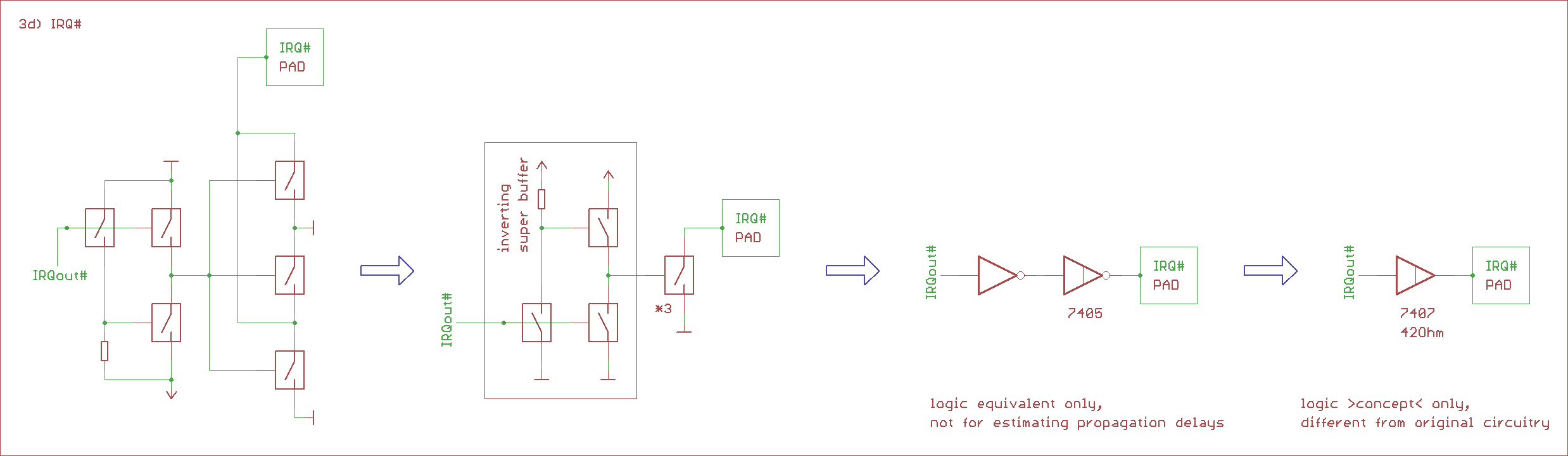

3d) IRQ#
The low_active IRQout# signal is generated in "10) ICR".
It goes into an inverting super buffer, which drives a FET that switches the IRQ# pad to GND.
Means that when IRQout# is active, the IRQ# pad is switched LOW.
The other end of the IRQ# pad is supposed to be connected to a pullup resistor (to VCC),
and to the IRQ# interrupt input pin of a 65xx CPU.

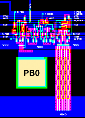

4b) PB0
PORT B has "open collector" outputs with pullup resistors (FETs).
Note that when a PORT B pin is configured as an output,
what you are getting when reading the PRB data register is
what's on the PB0..PB7 pads.
So you better be a bit paranoid/careful when using read/modify/write instructions
on the PRB register, like when driving a large capacitive load,
when an external source might be able to switch PB0..7 to GND,
or when trying to go for faster speed.
Layout for PB0..PB5 is pretty similar, so we just focus on PB0.
Registers and logic related to PB0 are attached "to the other end" of the PB0 pad driver.
PORT B Register read/write control signals are generated in "6) address decoder".
The layout for PB0 is just a variation of the layout for PA0
(so I'm not going to explain almost the same circuitry again here),
except that the designers had converted the driver FET switching the pad to VCC
into a second driver FET switching the PA0 pad to GND.
So that the PB0 pad can only be switched to GND,
but when switching to GND, the PB0 pad driver has half of the impedance of the PA0 pad driver.

4c) PB7
PB7 (and PB6) circuitry builds on the PB0..PB5 circuitry.
The difference is, that if the CRB1 Bit in control register B is set,
PB7 is forced to work as an output (ignoring DDRB7) and is assigned to timer B,
emitting either a pulse or a toggle signal at timer B underflow.
For PB6, it's the CRA1 Bit in control register A, and timer A.
Now for what's different in PB7 when comparing it with PB0:
A multiplexer controlled by CRB1 switches either the output of the
PRB7 data output register to the PB7 output driver circuitry,
or the high_active signal TB_Q which is generated in "9e) timer B control logic".
//For PB6, TA_Q is generated in "8e) timer A control logic".
To prevent glitches (during PHI2 register writes), the inverted output of the
DDRB7 data direction register Bit is sampled by a transparent latch at PHI1,
and goes into a NAND gate together with the CRB1 signal.
If the output of the NAND gate is LOW, the PB7 output driver is disabled.
In other words: if DDRB7 = 1, or CRB1 = 1, the PB7 pad output driver is enabled.

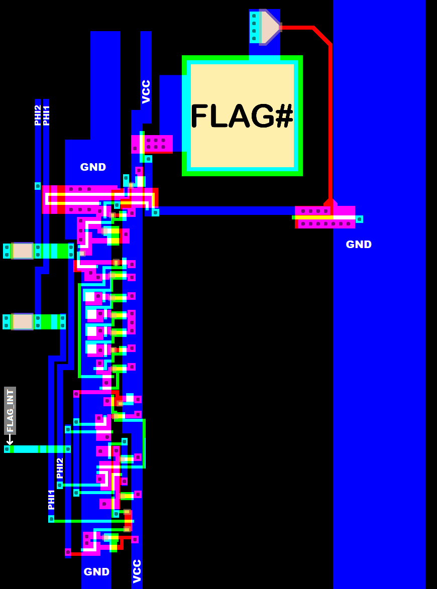

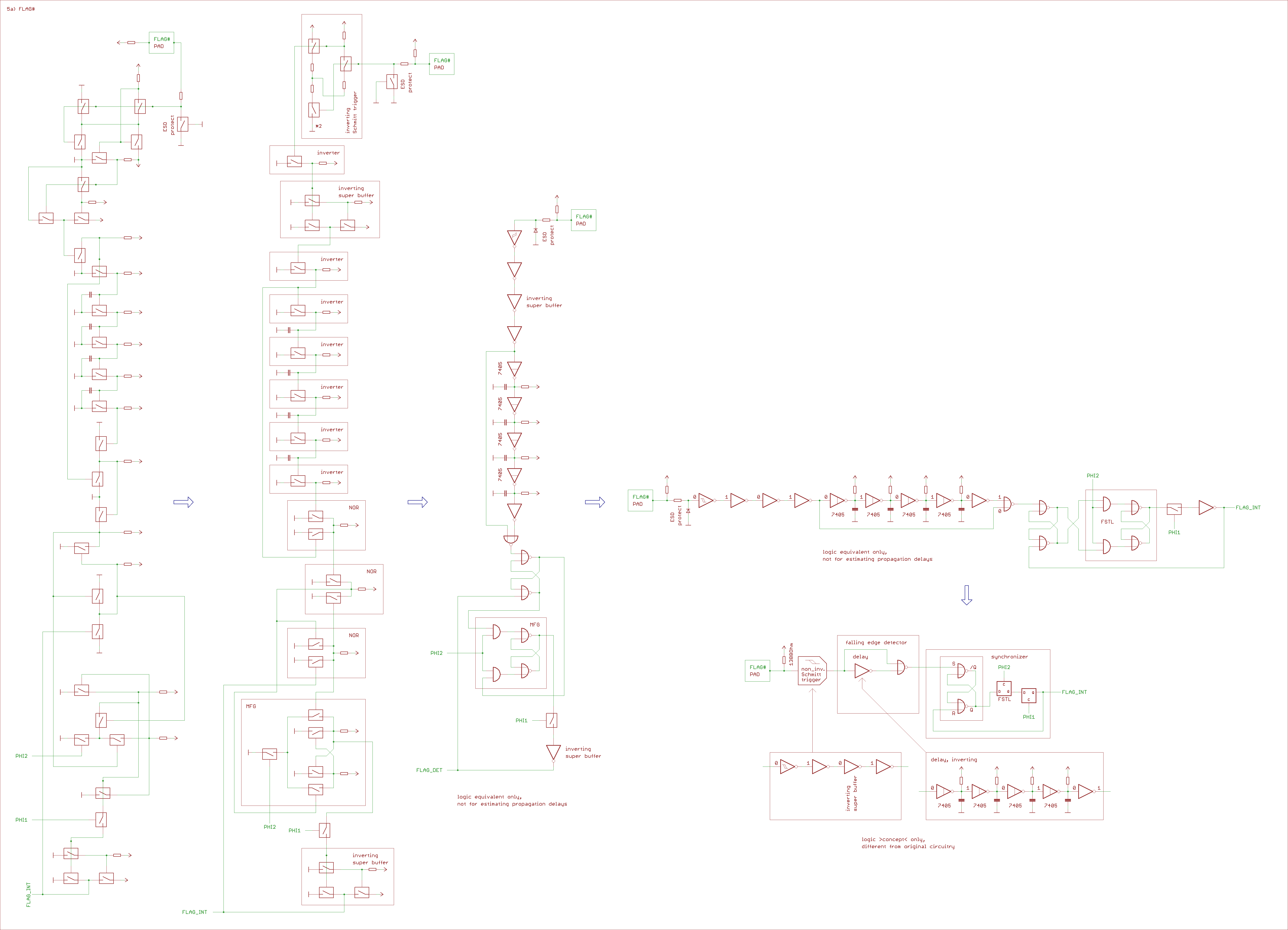

5a) FLAG# pad
A falling edge at the FLAG# pad sets the FLAG Bit in the ICR. //Interrupt control register.
FLAG# is a handshake input related to the parallel I\O ports.
Note, that there is a pullup resistor (FET) on the chip which ties the FLAG# pad to VCC.
The signal from the FLAG# pad goes through an inverting Schmitt trigger,
then through an inverter, an inverting super buffer, and another inverter, into a falling edge detector.
At the output of the falling edge detector, we have a NOR gate.
One input of the NOR gate directly is fed with the edge detector input signal,
the other input of the NOR is fed with the delayed/inverted edge detector input signal.
So when a falling edge is detected, the NOR gate emits a HIGH pulse
(the width of the pulse is set by the delay).
The inversion/delay is done by four "open collector" inverters which have a pullup
to VCC and a capacitor to GND at their outputs, plus a normal inverter.
We have the first RS flipflop which indicates that there was a falling edge on the FLAG# pad,
it is set by the output of the detector NOR,
and cleared by the FLAG_INT signal (which sets the FLAG Bit in the ICR).
The output of the first flipflop goes into a multifunction gate,
which basically is a second RS flipflop gated with PHI2.
The (inverted) output of the second RS flipflop is sampled at PH1 by a dynamic latch,
goes through an inverter, and becomes the FLAG_INT signal,
which now nicely is synchronized with the system clock.
Signal FLAG_INT goes into "10) ICR".
//Funny thing is: when I had tried building a TTL implementation of the 6522, I independently came up with the same concept.

5b) TOD pad
A rising edge at the TOD pad enables one counting step for the TOD counter.
Also, close to the TOD pad we have a ring counter which generates the PHI20 clock
for the TOD pad edge detector and synchronizer, and for the TOD counter.
I had labeled that clock signal "PHI20", because it is HIGH at PHI2 in every fourth PHI2 clock cycle.
Means that the TOD counter is clocked with PHI2/4, and enabled with a rising edge at the TOD pad.
Note, that there is a pullup resistor (FET) on the chip which ties the TOD pad to VCC.
The TOD edge detector and synchronizer circuitry builds on the FLAG# edge detector and synchronizer circuitry,
but there are some differences:
There is one less inverter between the TOD pad and the edge detector,
so we have a falling edge detector scanning the inverted signal from the TOD pad.
//And that's like having a rising edge detector scanning the non_inverted signal from the TOD pad.
The multifunction gate containing the second RS flipflop is gated with PHI20 (instead of PHI2),
for sampling the state of the first RS flipflop,
to synchronize the output signal with the TOD counter clock PHI20.
A transparent latch samples the (inverted) output of the second RS flipflop at PHI2,
sends it into a NOR gate together with the RES signal.
The high_active TOD_DET output of the NOR gate resets the first RS flipflop,
aknowledging that the rising edge at the TOD pad was recognized.
Means that if there was a rising edge at the TOD pad while RES is active,
TOD_DET goes active after RES goes inactive.
TOD_DET is sampled by a PHI20 controlled latch, then by a PHI1 controlled latch
(that's one PHI20 cycle delay), and becomes the TOD_DET1 signal which goes into
"14b) TOD control".
There is some odd (but dead) circuitry attached to the PHI20 controlled latch,
circuitry looks like remnants from a previous revision of the chip,
so we just ignore it.

So we just ignore that part.
