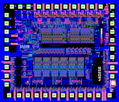

A picture of the 8520R4 silicon, with the interesting areas marked.
Just as a reference, another picture of the MOS 8520R4 silicon without the markings.

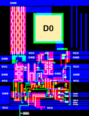

3c) D0
Layout of the D0..D7 buffers/drivers is pretty identical, so we just focus on D0.
The D0 pad connects to the external data bus.
D0io is the internal databus inside the chip.
To make it simple:
"read" means that the internal D0io..D7io signals are placed on the D0..D7 pads.
"write" means that the signals from the D0..D7 pads are placed on the internal D0io..D7io bus.
At the "write" side, the signal from the D0 pad goes through an inverting super buffer,
is sampled at PHI2 by a transparent latch, and then goes through two more inverters,
and from the inverters into two NOR gates controlling a driver which places the signal on the D0io bus.
The low_active WE# write enable signal which is generated in "2) CS#, R/W# circuitry"
is delayed before it goes into the two NOR gates controlling the driver.
If the low_active write enable signal WE# is LOW, the driver is enabled.
At the "read" side, the signal from the internal D0io bus goes through a non_inverting super buffer,
then through an inverting super buffer and an inverter, controlling two NAND gates
which set/reset a RS flipflop built from two NOR gates which have push/pull outputs.
The outputs of the RS flipflop are controlling the driver FETs which are switching the D0 pad to GND or VCC.
Means that said driver FETs do non_overlapping switching.
Now for the trick:
The low_active RD# read enable signal which is generated in "2) CS#, R/W# circuitry"
goes through an inverter, then into both NAND gates.
So when RD# is HIGH, the outputs of both NANDs are HIGH, forcing both outputs of the RS flipflop to LOW,
what disables the driver FETs which are switching the D0 pad to GND or VCC.
Conceptualy, the game is similar to what we had in the 8726 dissection.

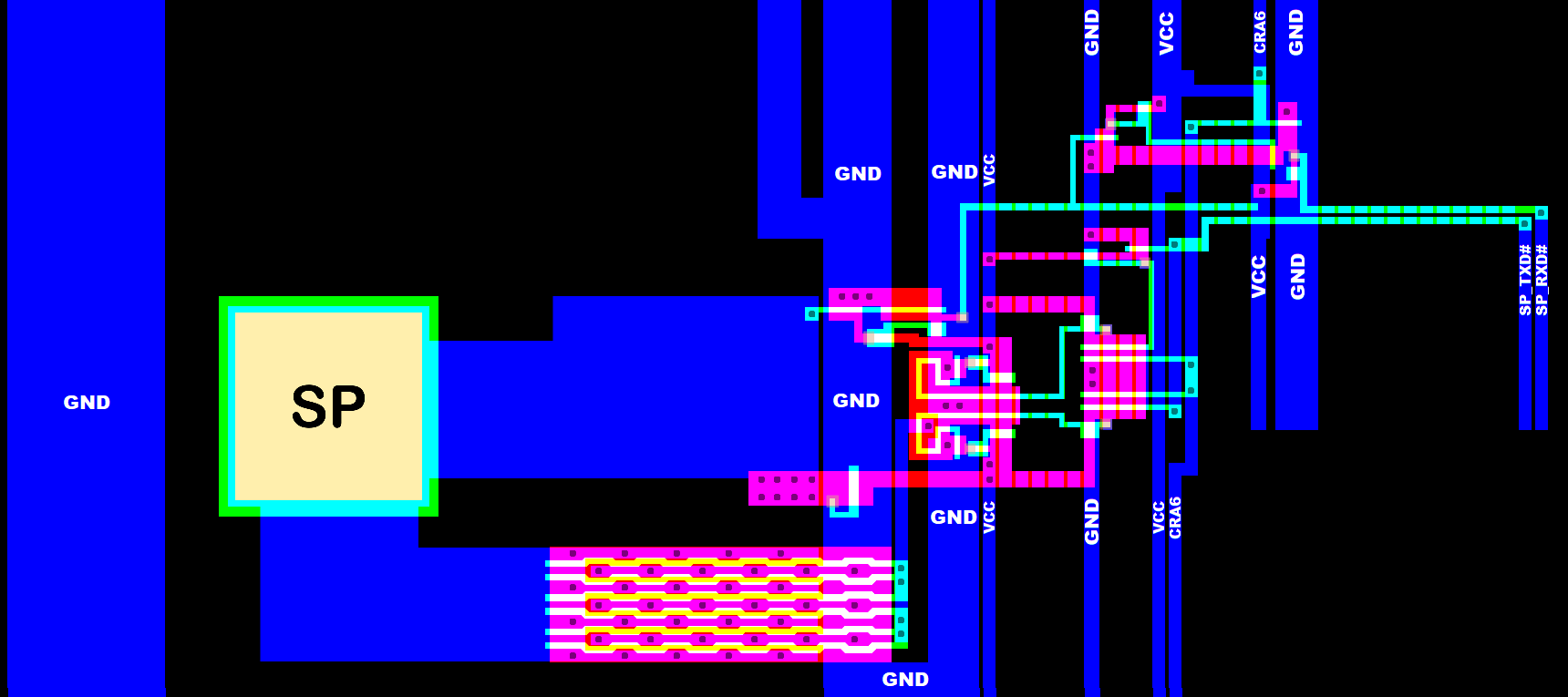

5d) SP pad
SP pad is the data input/putput pad for the serial port (shift register).
CRA6 control register A Bit configurates the serial port to either work
as an input (CRA6 = 0) or as an output (CRA6 = 1).
In output mode, SP has an "open collector output".
Note, that there is a pullup resistor (FET) on the chip which ties the SP pad to VCC.
At the input side,
the high_active signal from the SP pad goes through an inverting super buffer,
then through an inverter, then together with CRA6 into a NOR gate,
which emits the low_active serial data input signal SP_RXD#.
In output mode, when CRA6 is HIGH, SP_RXD# is forced to LOW (active).
SP_RXD goes into "11a) shift register plus latch".
At the output side,
the low_active serial data output signal SP_TXD# goes together with CRA6 into a NAND gate.
The output signal of the NAND gate goes into an inverting super buffer,
which controlls the driver FETs switching the SP pad to GND.
When CRA6 is HIGH (serial port in output mode), and SP_TXD# is HIGH (inactive),
the SP pad is switched to GND.
SP_TXD# is generated in "11b) serial port control".
Note, that there is some dead circuitry (maybe from a previous chip revision),
to me it looks like the designer who did the SP pad buffer/driver was not sure
whether he would be getting a high_active or a low_active serial data output signal
from the shift register... and he wanted to be on the safe side.
So we just ignore that part.
