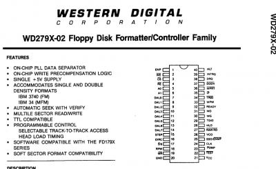

WDC is not Western Design Center - it is actually the people that make hard drives and SSDs etc - Western Digital Corporation. The WD2793 is a floppy controller as the IDC header gives that part away. I actually used reversible 3" hard jacket diskettes that Amstrad used but 3.5" became the defacto standard after Mac started using them.

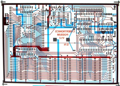

Ah, found a photo of the original artwork, Remember that these were done 2:1 so reduced photogs could be made for the top and bottom negs as they did back then.
