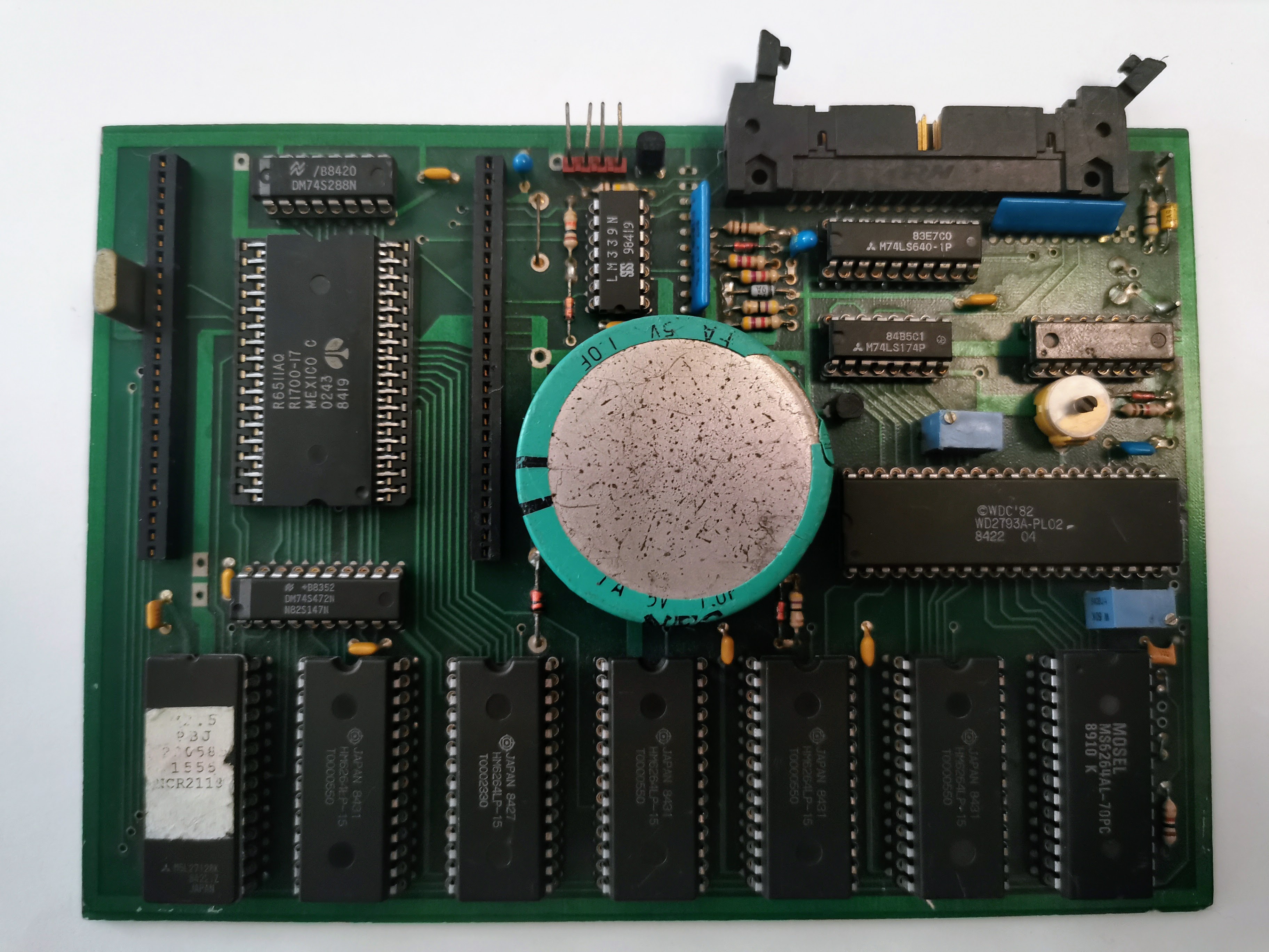

After seeing a photo of the Sontec board, I thought about my many 65xx boards, but the very first one was based on a R6511AQ (romless) where I merged and hacked the Rockwell Forth kernel and dev ROMs with a few extras. So this board was used for development purposes but ended up in some early POS terminals in 1984 until I then shrunk the CPU+ROM+RAM etc into a credit card sized module. I don't think I've posted this before but here it is.

Very nice!  What did you use to lay it out?  It doesn't look like crepe tape!  Did you actually have access to some kind of CAD back then?  I'm not sure I had even seen a color monitor yet in '84, only TVs used as very low-res monitors.  What's the WDC IC?

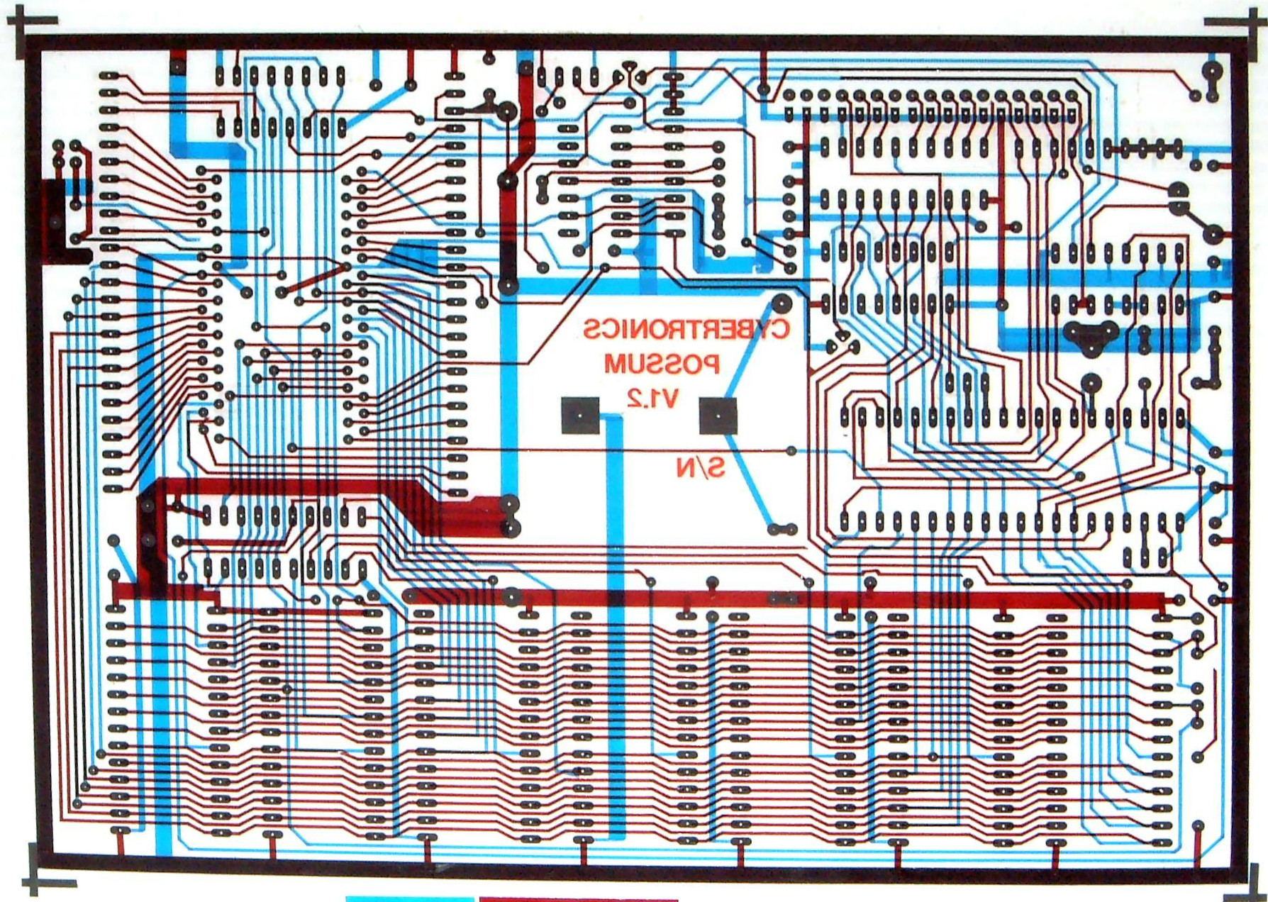

The artwork was done 2:1 with red and blue tapes but within the year I was using MacDraw with a custom library to layout these PCB manually. I did have a MacPCB package but it had too many restrictions.
WDC is not Western Design Center - it is actually the people that make hard drives and SSDs etc - Western Digital Corporation. The WD2793 is a floppy controller as the IDC header gives that part away. I actually used reversible 3" hard jacket diskettes that Amstrad used but 3.5" became the defacto standard after Mac started using them.

Ah, found a photo of the original artwork, Remember that these were done 2:1 so reduced photogs could be made for the top and bottom negs as they did back then.
