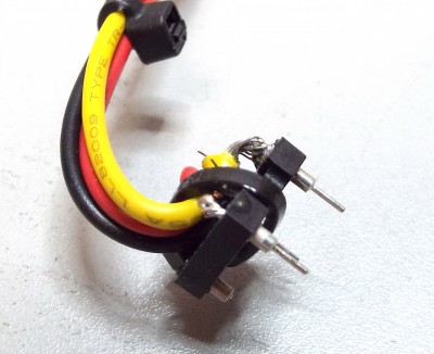

The new and improved clock stepper has been built and actually works.
File comment: Clock Single-Stepper Assembly
File comment: Clock Single-Stepper Detail
File comment: Clock Single-Stepper Wiring
If anyone is interested in acquiring one please PM me. I've got enough parts to build four more.
