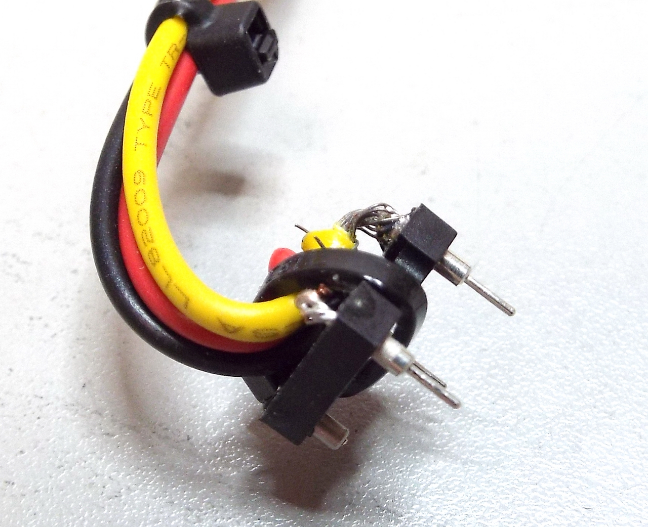

The new and improved clock stepper has been built and actually works.
Clock Single-Stepper Assembly
Clock Single-Stepper Detail
Clock Single-Stepper Wiring
If anyone is interested in acquiring one please PM me. I've got enough parts to build four more.
