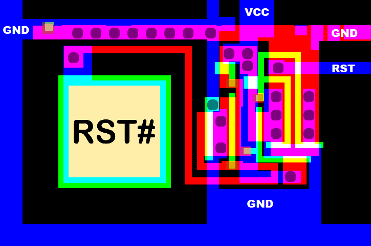

2e) RST# input //low_active hardware reset
RST basically goes through an inverter, and becomes the high_active RST signal.
Note, that like in the 6530, the 6522 hardware reset is not synchronized with any clock.
It's an asynchronous signal.

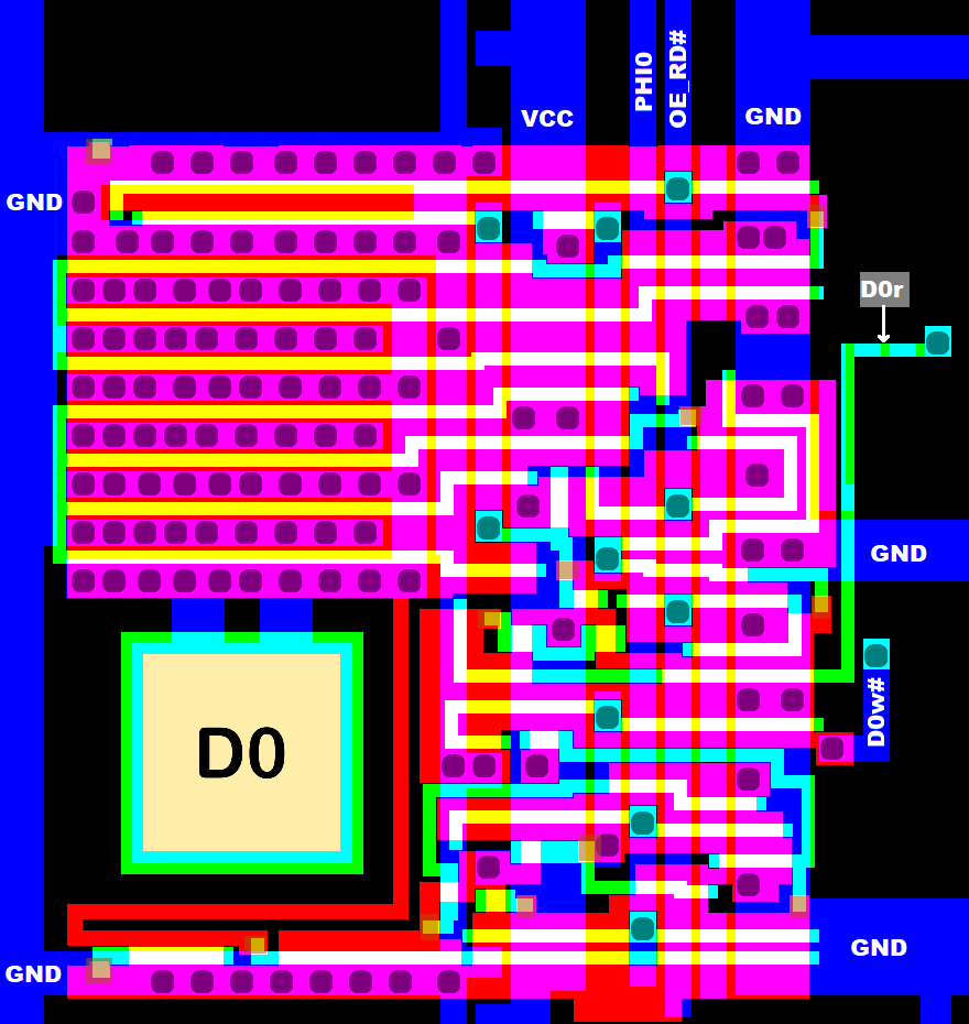

4) D0 input/output
D0..D7 pads connect to the external data bus.
Chip layout for the D0..D7 circuitry looks pretty identical,
so we just focus on D0.
On the output side, basically we have a non_inverting push/pull driver,
fed by the internal read data bus signal D0r.
If the low_active output enable signal OE_RD# is low,
the driver puts D0r on the D0 pad, and that's all there is to it.
OE_RD# is generated in "18) bus control, handshake".
OE_RD# is active during PHI0, when the 6502 reads a 6522 register.
Note, that we have precharge FETs which pull D0..7r to VCC during PHI1.
See "17) D0..7w inverters, precharge".
On the input side, we have a fully transparent static latch
which samples the D0 pad during PHI0.
The output of the flipflop goes through a driver which feeds
the low_active D0w# internal write data bus line.
Note, that the driver has no output enable,
and that the way how the driver is attached to the latch makes sure
that the FETs in the driver do non_overlapping switching to GND/VCC.
Also note, that we have 8 inverting super buffers which turn D0..7w# (low_active)
into D0..7w (high_active), see "17) D0..7w# inverters, precharge".
They are ocated between the D2..5 pads and "16c) Timer 1 low" on the chip.

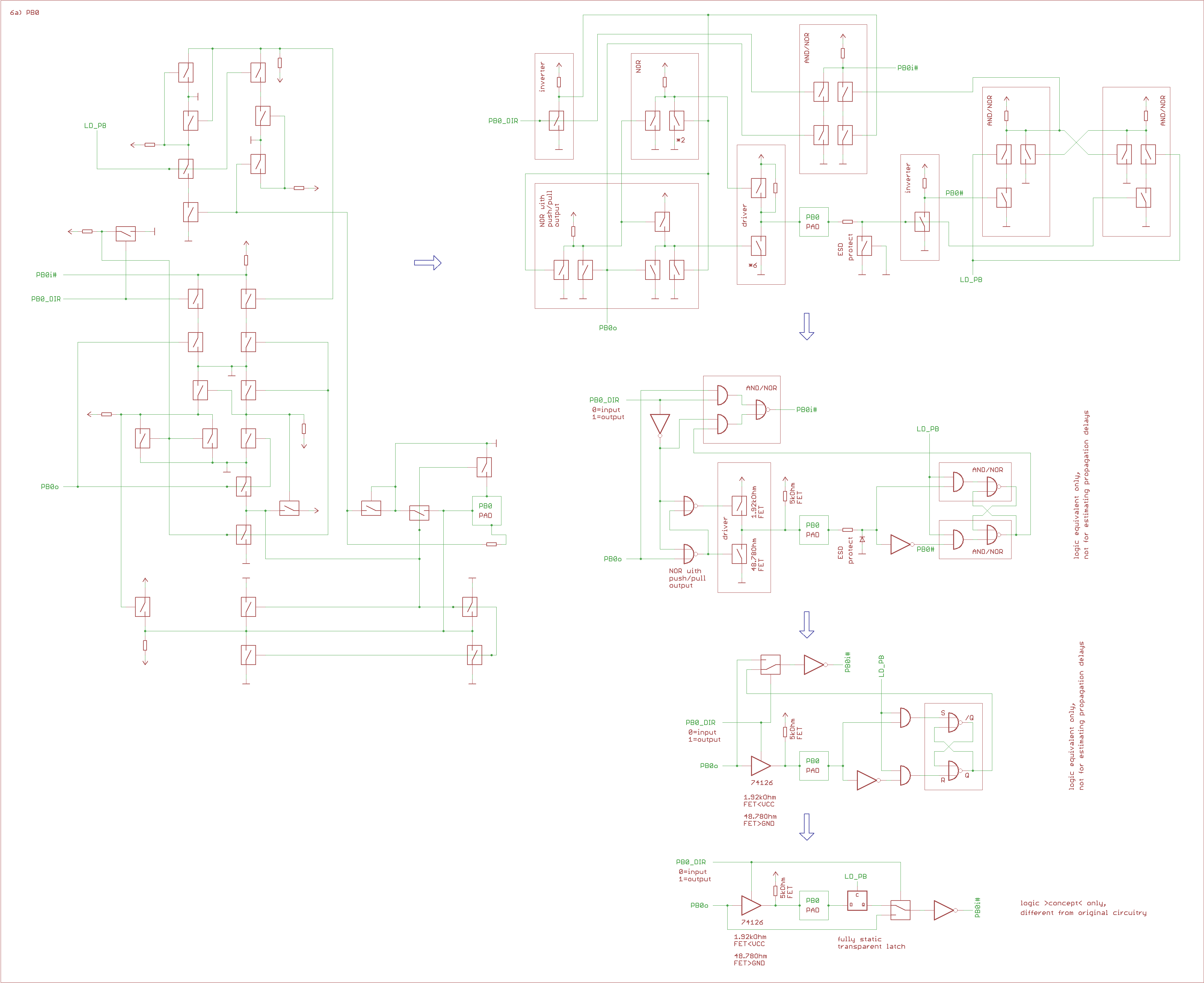

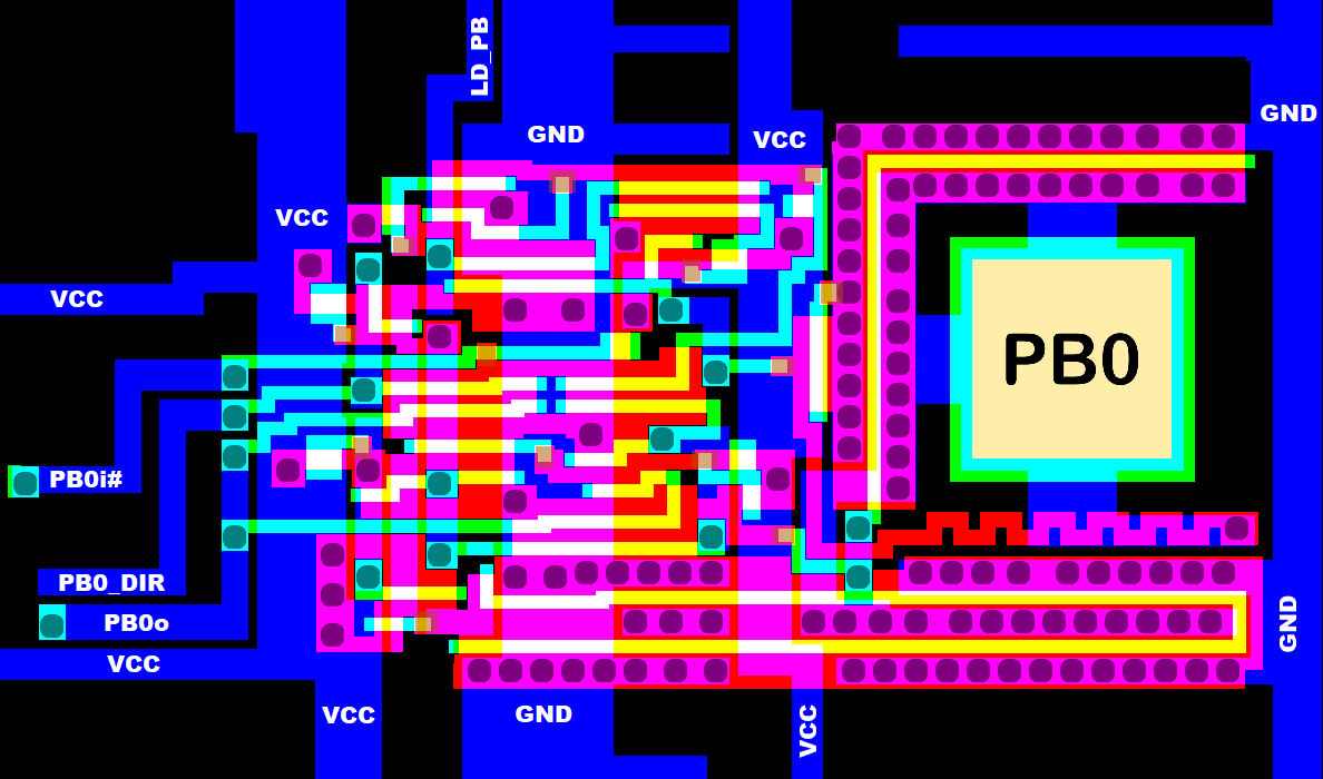

6a) PB0
PB0..7 is another 8 Bit I\O port.
Chip layout for PB0..6 is pretty identical,
so we just focus on PB0.
On the output side, wa have a non_inverting push/pull driver,
fed by the high_active PB0o signal, which switches the PB0 pad to GND/VCC.
If the high_active PB0_DIR signal is high, this enables the driver.
A ca. 5 kOhm pullup ties the PB0 pad to VCC.
PB0o and PB0_DIR are generated in "7) PA,PB registers".
On the input side, we have a fully static transparent latch which samples PB0
when high_active control signal LD_PB is high.
A 2:1 multiplexer controlled by PB_DIR either routes
the output of the latch (if PB0_DIR=0, PB0 direction is input)
or the PB0o signal (if PB0_DIR=1, PB0 direction is output)
into an inverter which emits the low_active PB0i# signal.
Background is, that if the PB0 output driver has to sink/source a lot of current,
we can't be sure if the voltage at the output of said driver matches high or low level.
So if PB0 direction is output, the 6502 reads what's in the register which feeds
the PB0 output driver input instead of what's on the output driver output,#
just to be on the safe side during read/modify/write operations and such.
PB0i# goes into "7) PA,PB registers".
Note, that Timer 2 can count falling edges on PB6.
The input of "21) PB6 falling edge detector" taps into the PB6# signal,
which is generated by an inverter from the PB6 pad.
//Said inverter belongs to the PB6 input latch.
LD_PB is generated by a NAND, which is located in "8d) PB input latch control".
The inputs of the NAND are fed by ACR1 and by the output of a transparent latch
which samples IFR4 during PHI1:
If PB latching is disabled by ACR1=0, PB input latches always are transparent.
If PB latching is enabled by ACR1=1, IFR4=1 (sampled during PHI1) freezes the PB input latches.
//IFR4 interrupt flag is set by active CB1 input edge.
