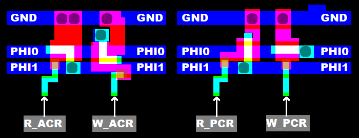

Read/write control signals enter the register block from the South.
North from the register block, we have FETs controlled by the clock signals,
switching the other end of every control signal to GND in the right moment,
to make sure that the control signals are inactive when they are supposed to be.
For every register in the 6522 it's implemented like this,
and we have seen that trick quite often in other MOS 65xx peripheral chips.

9) ACR,PCR registers
Not much to say, these registers are built in the same way as the DDRB register:
Every register Bit is a static RS flipflop, flipflops are set/cleared by the internal data write busses
D0..7w and D0..7w# by a high_active write control signal during PHI0=0.
The buffered outputs of the RS flipflops goes somewhere to control logic on the chip,
also switches controlled by a high_active read control signal place the output of a register
on the internal read data bus D0..7r during PHI1=0.
Note, that all of the register Bits are asynchronously cleared when RST is active.
Like with the PA,PB register block, read/write control signals enter the ACR,PCR register block from the South,
and at the North of the ACR,PCR register block we have switches which make sure that these control signals
are inactive during a certain clock phase.
Of course I'm simplifying things, because the RS flipflops are not built from two NOR gates,
they are built from two "open collector" inverters which have pullups to VCC at the outputs.
This trick makes the RS flipflops smaller than when using NOR gates.
For RS flipflops built like this, R# is identical to Q, and S# is identical to Q#.
