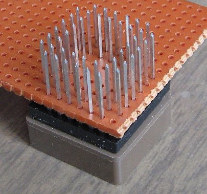

The other alternative is PLCCs, which can be put in sockets-- even wire-wrap sockets-- that fit into breadboards with the holes on a .1" grid. I got my McKenzie Berg PLCC wire-wrap sockets from Allied. Unfortunately Allied doesn't seem to have them anymore, nor does http://smt-adapter.biz/ . However, BigEd pointed us to a source that stocks WW PLCC sockets in many sizes: http://uk.rs-online.com/web/c/?searchTe ... ra=oss&r=t .
Here's a picture of one of my 44-pin ones:
As you can see, it's not one of those more-common monstrosities with a big PC board around the outside and all the WW pins outside the perimeter of the actual socket. It takes no more room than a non-wire-wrap PLCC socket.

The other alternative is PLCCs, which can be put in sockets-- even wire-wrap sockets-- that fit into breadboards with the holes on a .1" grid. I got my McKenzie Berg PLCC wire-wrap sockets from Allied. Unfortunately Allied doesn't seem to have them anymore, but I found this source. The 32-pin is shown there, but if you click on "Selection-guides" underneath the 32-pin one, it will give you a .pdf file, and the 44-pin is indeed there, part number 44PL-W. At $9.20, they're approximately what I paid quite a few years ago. Here's a picture of the 32-pin:
I couldn't figure out how to order the 20-pin ones from the selection guide, so I Emailed them and asked. The unfortunate response was that they're not making them anymore. Milos wrote:
We have to buy pins in very large quantities. As we sell only a few wire-wrap sockets and adapters, we did not buy pins anymore. We are selling sockets which are already pinned (32-pin and 68-pin). When we sell them, we will take them of our web site.
I haven't found any other sources. If someone else has, let us know. Otherwise, if you think you might someday want 32- or 68-pin WW PLCC sockets, better get them now! [Edit, 1/21/13: BigEd just pointed us to a source that stocks them in many sizes: http://uk.rs-online.com/web/c/?searchTe ... ra=oss&r=t ]
