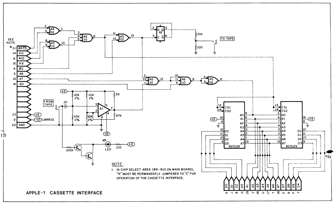

I'm returning to this topic, because I'm still interested, and I have a question that is still lingering.
I completely understand using the '373 with some resistors and stuff to make a DAC. And as Garth pointed out below, you could also use the VIA 6522 to do this.
But the phrase "Rx needs an opamp and some passives" is not enough for me! Need more details on how to receive :)
My first idea is this type of connection:
Audio Source -> OpAmp -> Diode -> 6522/6551 -> 6502
The OpAmp amplifies the smaller voltage into 5V, and the diode would cut off negative voltages leaving 0V to 5V. Yes?
Consider the cassette interface for the Apple 1:
https://www.applefritter.com/files/imag ... c-6889.gif
I was seeing that the OpAmp they use is an LM311. The rest are just logic components and some ROM. Again, I'm not worried about sending audio OUT from the circuit, I'm worried about receiving audio IN to the circuit. I don't want to lose signal, and I don't want to fry chips. Thoughts?
Last question, since I'm here (and so are you!), could I get away with a setup like this without needing 12V? It seems to me that using an OpAmp to step up a voltage requires a voltage even higher than that to begin with. BUT, what if I were to supply with 5V and only care to output 3.3V from the OpAmp? I'd use an 74HCT' chip to pick up the signal and send it off to it's 74HC' friends. I'm not scared with 12V, but it is inconvenient for my particular projects.
Thank you all!

Good persistence points there! I think going back to simple and cheap early systems is going to be the closest match to your needs - I don't have analogue design skills, so my best shot is to look at other schematics out there. Here's one Eric Schlaepfer made which seems to fit the bill:
http://tubetime.us/index.php/2017/09/05 ... interface/
Their op amp is supplied by 0 and 5V, which is handy because you'll already have those, and also handy because it means the output of the op amp is certainly going to be between those two levels.
Wow Ed, that is RIGHT ON! Very neat, good find, thank you for that!
I went to the datasheet for the CA3140:
https://www.electroschematics.com/wp-co ... A-3140.pdf
and found this:
"Figure 4 shows some typical configurations. Note that a series resistor, RL, is used in both cases to limit the drive available to the driven device. Moreover, it is recommended that a series diode and shunt diode be used at the thyristor input to prevent large negative transient surges that can appear at the gate of thyristors, from damaging the integrated circuit."
Thyristors?! Anyways, it is saying that a diode could be used as well. Also, from the circuit you gave me, that 22K resistor seems like a lot. I would probably replace it with a pot, or at least experiment with a breadboard and the 'scope first. Also, the datasheet says a 6.2V zener would be a nice addition for TTL usage. Interesting.
Ok cool, this is a great start. Thank you again Ed, great help. It seems I'm diving into analog circuits now!

PostPosted: Tue Mar 22, 2022 10:23 am
Posts: 10800
Experimenting with component values, on a circuit which works, is a good way to learn!
But sizing components by random exploration on a circuit which doesn't work, that's another thing...
PostPosted: Tue Mar 22, 2022 10:24 am
Posts: 10800
I think their Zener is there because they want to allow a great range of supply voltages - so, not needed, I think.
PostPosted: Tue Mar 22, 2022 10:26 am
Posts: 10800
Likewise, the extra components illustrated for switching mains power with a thyristor - that's kind of interesting, and useful for some purposes, but not the territory we're in.

Yes, something like that is what I meant. I haven't had the time to test but that's basically what I would do - I think I have an actual comparator in my arsenal though.
I got the idea from Don Lancaster's design, which seems to have been the basis for the Kansas City Standard, if you ask Wikipedia.
https://www.tinaja.com/glib/bitboff.pdf
Using a 6502 you can throw away most of his rx circuit though. I plan to use a VIA's PB6 to count negative pulses, after the comparator/opamp.
That schematic works!
I just got parts in today, tested them. After a couple breadboarding goofs I got it to work. The OpAmp feeds into a 74HCT00 and outputs a beautiful inverted signal. I also tested it with an 74LS' chip and that works great too. The only thing I changed was the 22K resistor into a 50K audio-style pot. And yes, 22K is about right.
I connected it to my line-out from the desktop, and ran this command on my Linux box:
play -n synth square 1200 gain 2
"play" is a derivative of "sox" by the way.
I altered the volume and about 25% worked for me, I got a clean signal. Using both the volume control and the pot is good because I can adjust BOTH to make it just right. Too little resistance and I get fluctuations. Too high resistance and I get no signal at all.
Soon I will make a little bash script to 'play' alternating high/low signal. I also want to test different volume levels and pot levels, and test this in a headphone jack and on my wife's laptop. I think I might record something and see if this also runs off of my phone, that'd be cool. And lastly I'm going to connect the breadboard to my VIA and see if I can read signals in to the 6502! That will be fun :)
If this all works, I will try the reverse direction, making a little resistor DAC from the VIA out to my desktop, and see if I can record it, and then play it back without signal/data loss.
Neat! Thank you again Ed, this was really a cool side-project. I will be integrating something like this into my next board for sure :)
