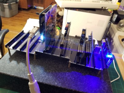

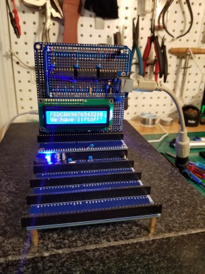

Blue April now (finally!) has an I/O board. LCD output and keyboard input are provided by something other than breadboards! :D Here are a couple of side / back views. I kind of like the one with all the lens flare - I didn't do that on purpose!

Great job! Glad it's working well. Did you end up going with the 74HC or 74AHCT parts in the end?
So, you have 3 backplane boards, and to connect them you made a little staircase!
I see you have gotten wire-wrap figured out. That's neat to see, glad that is working for you.
Any starting places for the video? As some have told me, "it is best to start with a working model". And they were right. I was having major difficulties, but when I used George's (gfoot) design, everything worked out nicely afterwards.
Great job again! Thanks for the updates and pictures.
I did switch to 74HC while troubleshooting the old circuit, but with this rebuild all the ICs are back to 74AHCT. (Actually, if you look REEEEELY closely at the photo, one of the 595s is still an HC - I must have reached into the wrong parts compartment! - but I have since noticed and swapped it out, so they really are all AHCT now. :)
Yep. :) TEBL made a kind of bridge connector for extending the backplane, but it took up two bus slots and only provided one. I figured rather than making another PCBWAY order, I could just make a third backplane and solder on some upside-down male headers. Sacrifice two bus slots to gain three. Also the front backplane module can be swapped out for the RC Project Platform board - that's the one with the half-breadboard and 6522 on it.
It seems to be working OK; I followed Garth's instructions in the primer. :) There are still a few solder connections on this version, but all the bus signals are wire wrap to wire wrap.
