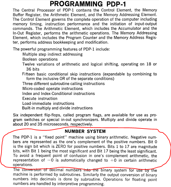

I don't remember ever seeing bits written with the least significant on the left and the most significant on the right, but I have seen them numbered in the opposite order. That is, the bits in an eight bit value would be numbered 01234567, where bit 7 is the least significant (the 2^0 = 1 place) and bit 0 is the most significant (2^7 = 128).
This was on PowerPC, which I believe inherited it from POWER. It was as confusing as you might expect.

The IBM 360 is the earliest computer I know in which bit #0 is the most significant.
Except for some bit test, set and reset instructions, it is not important to know which one is considered to be bit #0.

Post by commodorejohn »
Yeah, some computer manufacturers numbered bits with #0 as the MSB, for...reasons. Don't know what the rationale may have been, unless it was just that, well, you write the MSB first, but it's always driven me crazy as it fails the simple logical test that place value = 2 ^ bit #. TI is the only place I know of that continued it into the relative modern day, although they seem to have finally abandoned it going by the MSP430 documentation.
