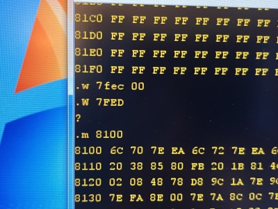

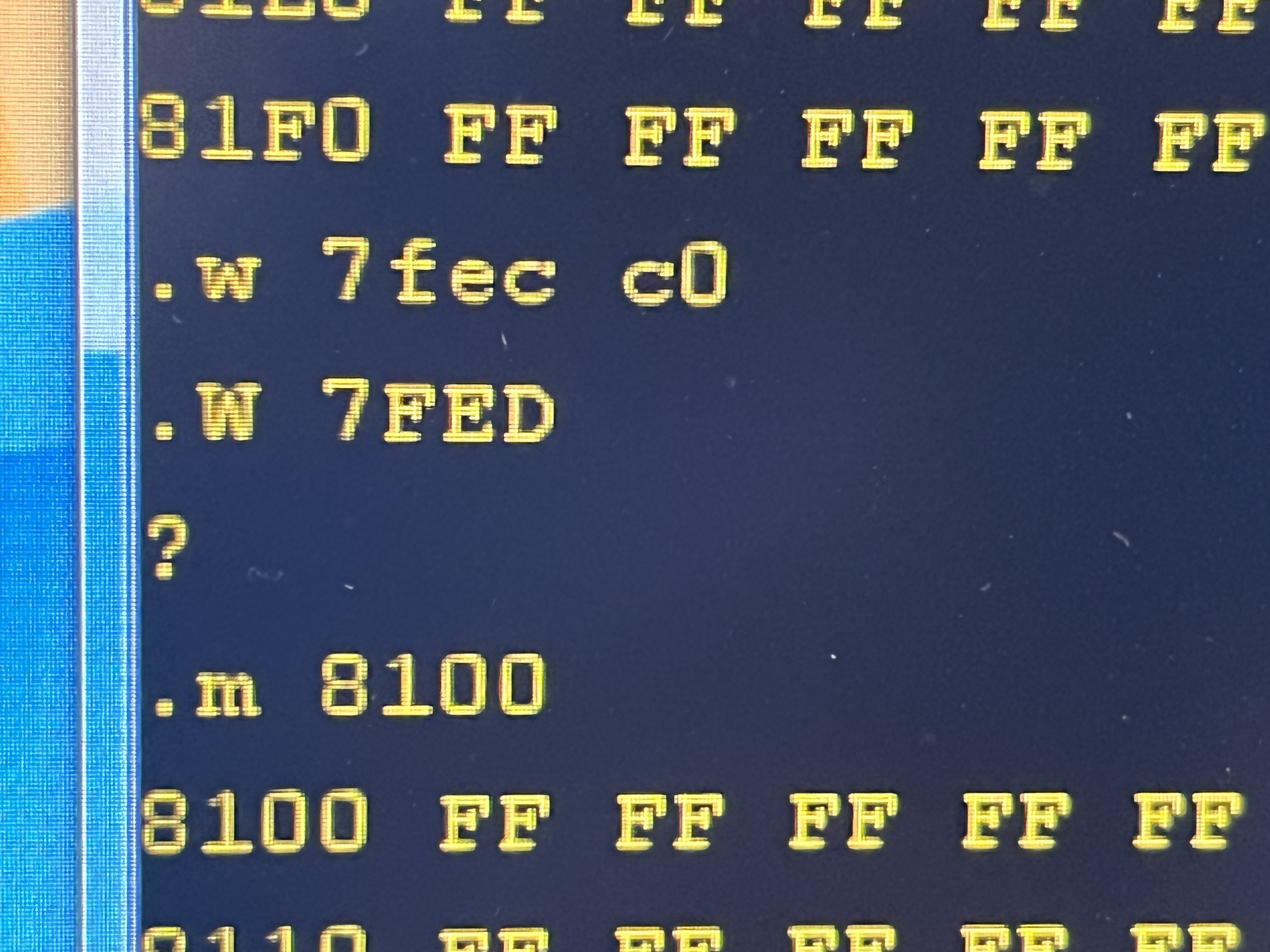

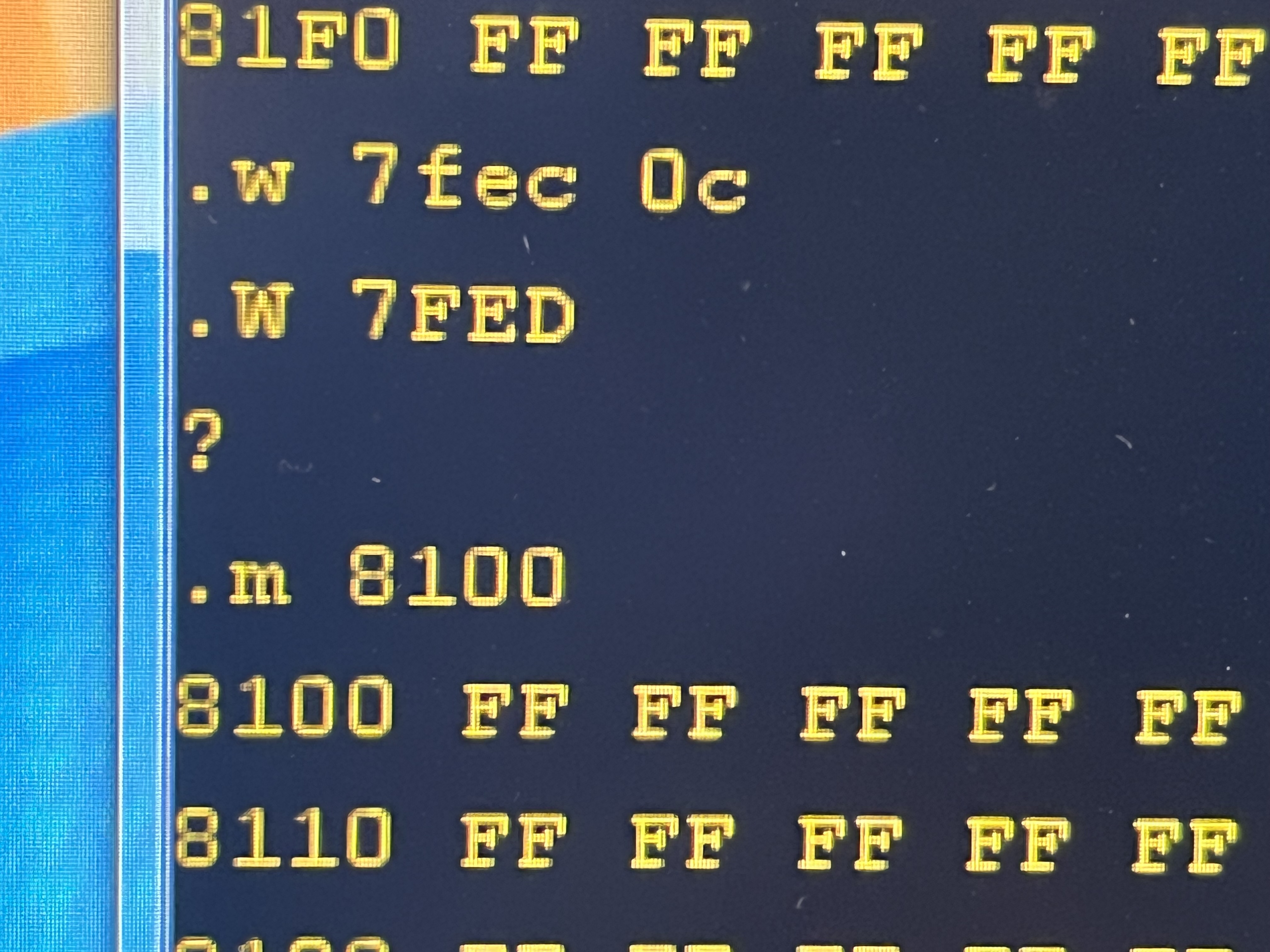

Confirmation of banks changed.
Banks 0 through 3.

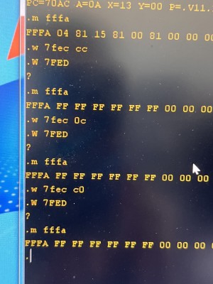

Very interesting… were able to take a look at what the interrupt vectors look like in the other banks? I'm really curious to see what happens if you get an interrupt when you're in anything but bank 0…
PostPosted: Sat Jun 11, 2022 7:48 pm
Joined: Wed Feb 17, 2021 6:54 am
Posts: 69
Looks like there are no provisions for anything if you swap the banks away from Bank 3. (Bank 3 is the default startup one, at the highest ROM address level).
All 0, 1, and 2 just $FF default blank.

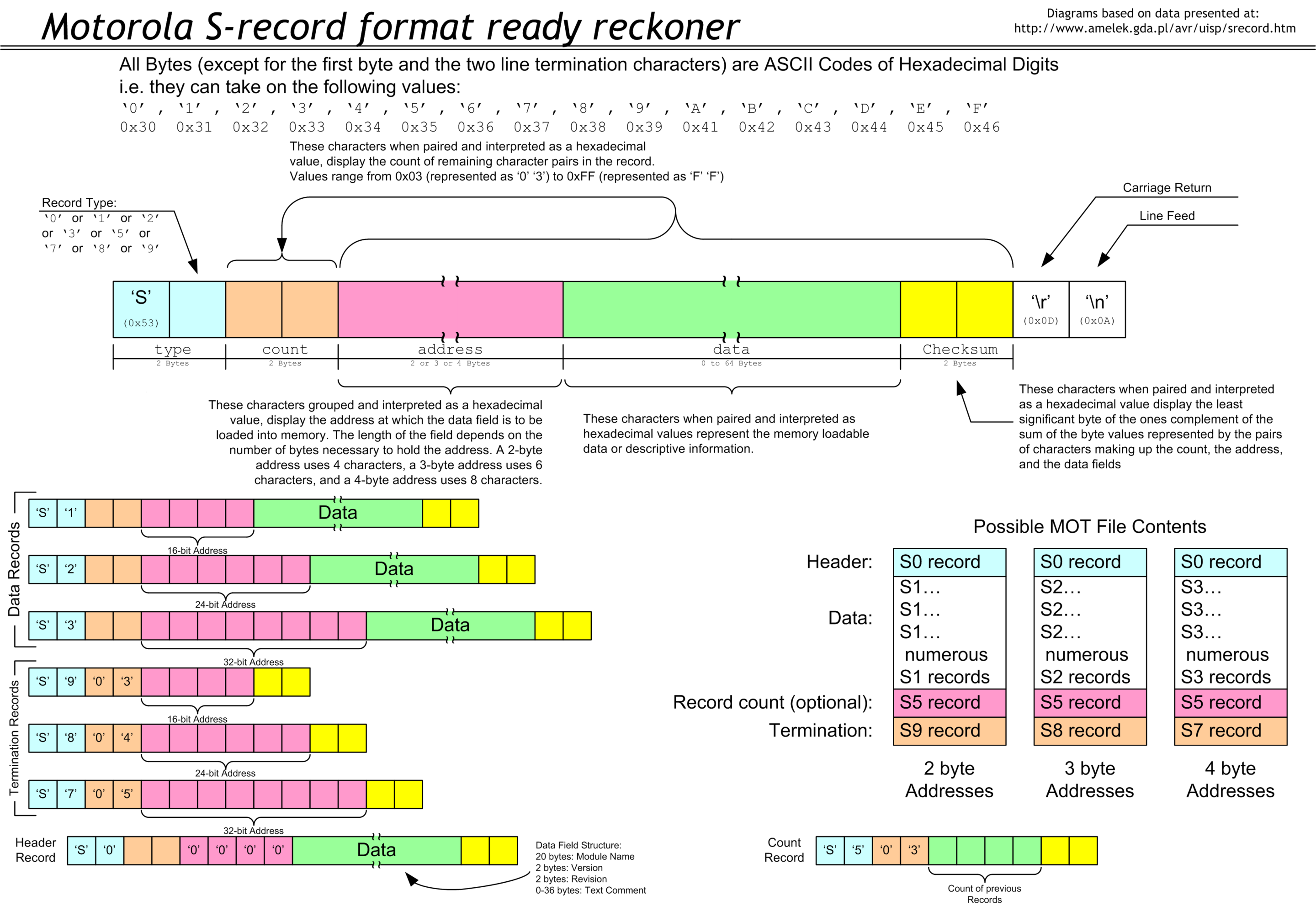

S19 Format
This is in contrast to the Intel Hex format described by Garth
http://wilsonminesco.com/16bitMathTables/IntelHex.html

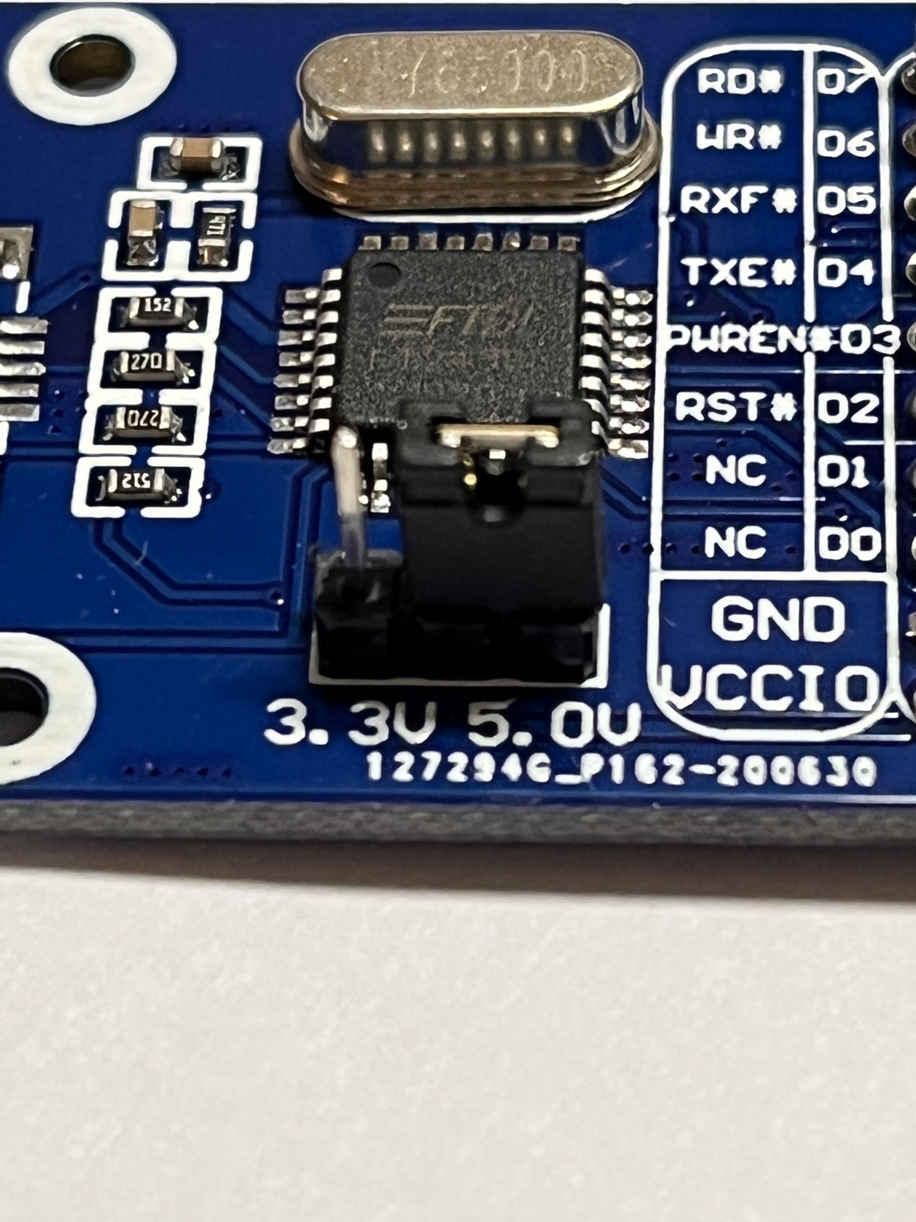

Bought this to experiment with.
Jumper selectable 3.3 or 5v.
