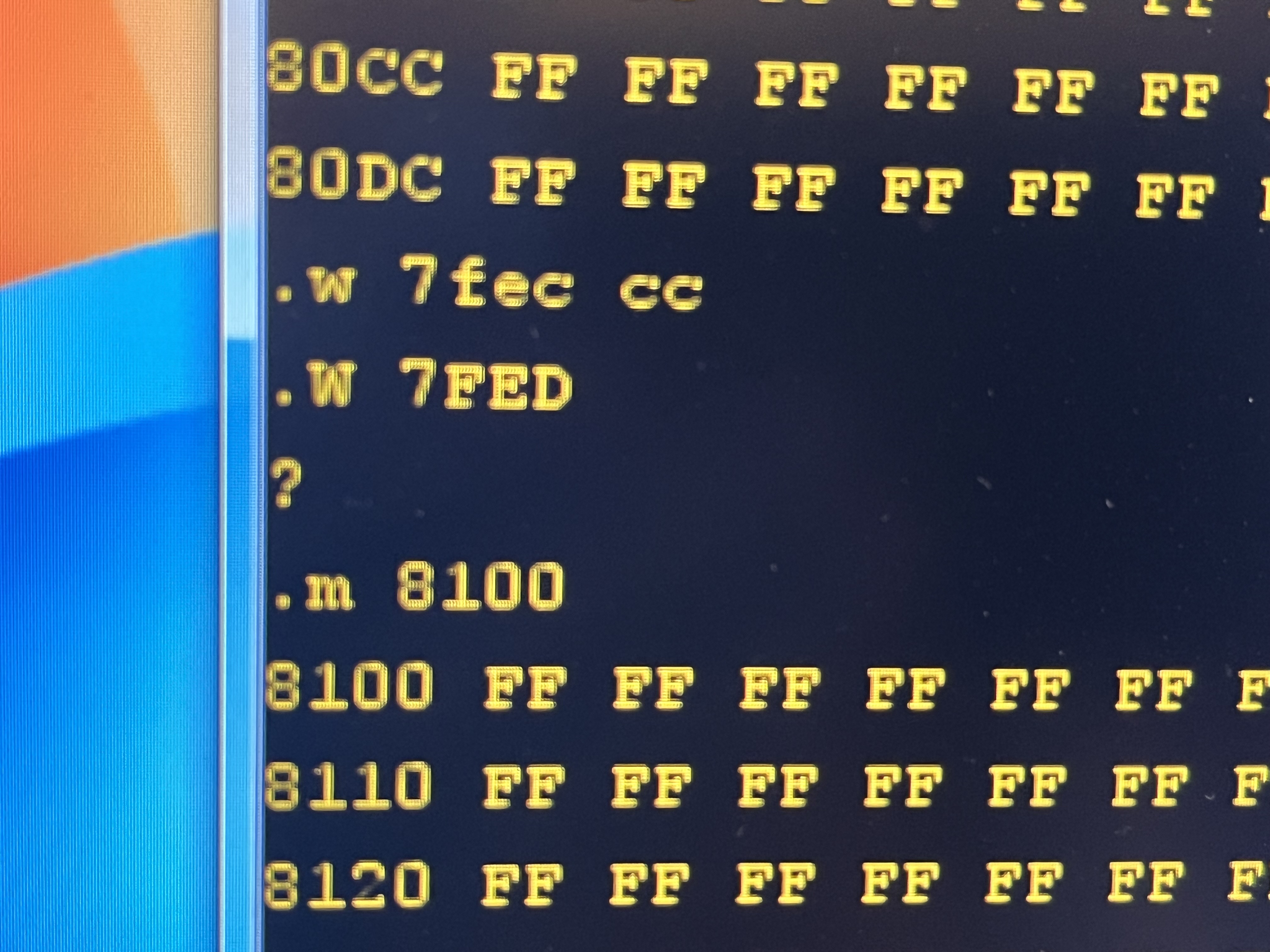

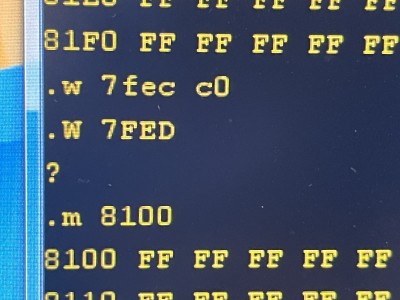

Re: Trying to decipher the mysteriously confusing WDC 65c02
Confirmation of banks changed.
Banks 0 through 3.
Banks 0 through 3.
Very interesting… were able to take a look at what the interrupt vectors look like in the other banks? I'm really curious to see what happens if you get an interrupt when you're in anything but bank 0…
All 0, 1, and 2 just $FF default blank.

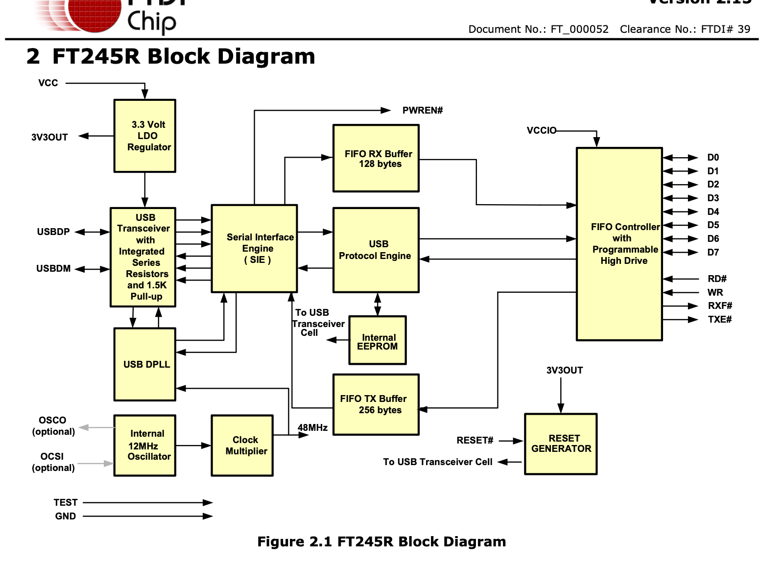

Vision for this project;
Have an onboard monitor with assembler, accessible via USB to a computer running a serial terminal program (ideally CoolRetroTerm haha)
Next steps;
A) Choose a monitor (I think I will go with SYSMON65)
https://github.com/jdimeglio/SYSMON65
I believe Joe Dimeglio is active on this forum (who isn't from the 6502 world!)
b) Figure out how to use the FTDI USB interface to handle serial connectivity to a computer.
(Datasheet attached)
Next steps;
- Attachments
- FTDI DS_FT245R.pdf
- (1.15 MiB) Downloaded 98 times

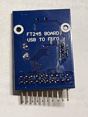

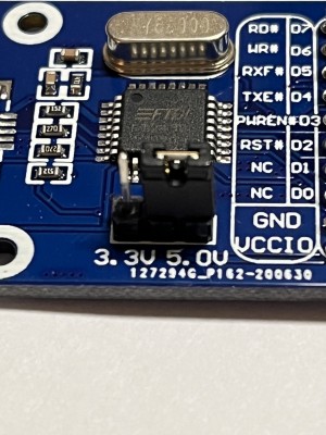

Bought this to experiment with.
Jumper selectable 3.3 or 5v.
