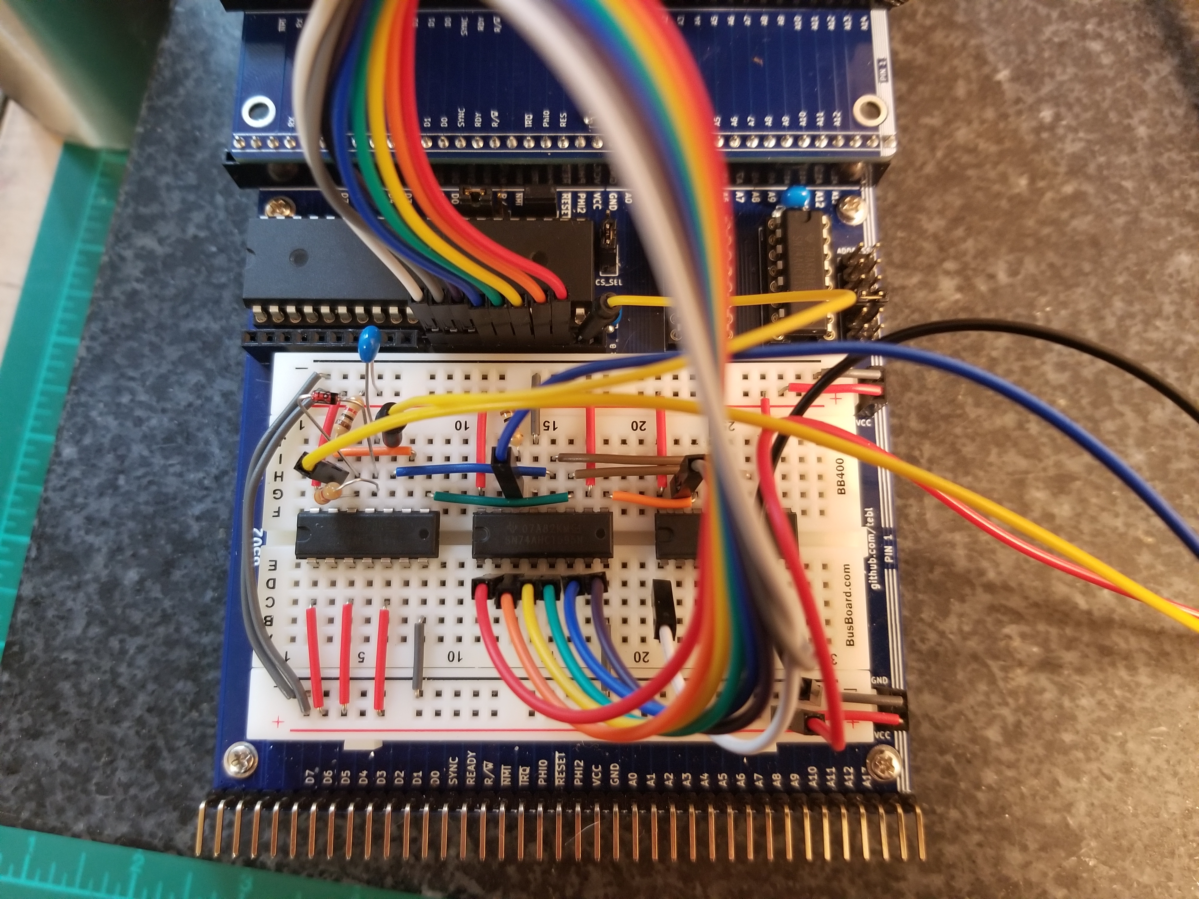

Here is my breadboard circuit:
It works great! As I mentioned up thread, it's pretty close to identical with the one from Ben Eater's video. If you're interested, I can sketch a schematic, or point you to the video, etc., but I mostly include the photo just to show the wiring - bit loopy data lines, long unshielded wires from the PS2 connector (that's what's going off the right side of the frame) and so on. This seems to run indefinitely with no errors.

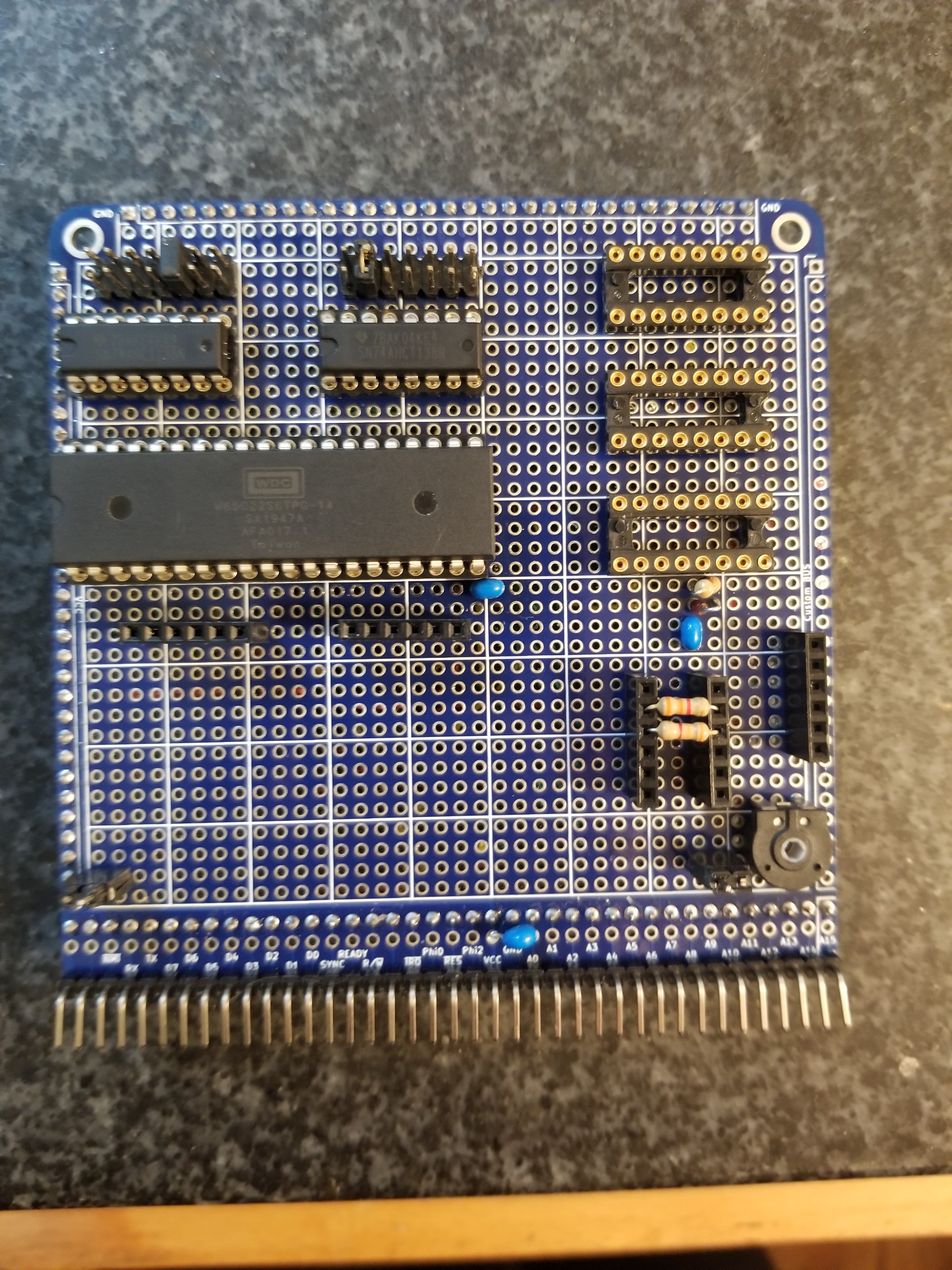

Since that was so, I thought now would be a good time to add it to my custom I/O card that holds my LCD circuit. Here it is:
The LCD plugs in just under the VIA on the left.
It... kinda works. The good part is, adding the PS2 stuff to the board did not make the LCD stuff that was already there stop working. I don't expect anyone to try and analyze that rat's-nest of wiring, I'm just posting it so you can see my technique (or lack of it!).
So, what's happening is, the keyboard circuit does work. When I push down the spacebar, I get a space... usually! But sometimes I get a random character. This is what happened on the breadboard circuit before I added the pullup resister on the data line. I've poked around with my multimeter and everything to do with the data line seems to be hooked up the right way. The other thing is that my voltage regulator (LM7805) is now getting REALLY hot. It wasn't doing that before, so something must be wrong with my power network. I'm not sure what though; there don't seem to be any shorts.
What I'm wondering here is, how to troubleshoot this with just a multimeter?
 Post subject: Re: A partial failure
PostPosted: Thu Jun 09, 2022 10:40 pm
Posts: 718
Paganini wrote:
It... kinda works.
Ahh, that takes me back. Love the pictures! Here was my first contraption. viewtopic.php?f=12&t=6818&start=120#p88404 It also worked... kindof. :)
If something is getting hot, gosh, I would be scared. The only time I had something get HOT was a small CPLD that Bill gave me to test things out on. It was FRIED because of... the power supply! Yep my little USB wall-wart was running 12V into it, when it should have gotten 5V. IT. GOT. HOT. So perhaps this is a place where you are getting 'noise'?
Sorry about no help, again, but thanks for posting the update!
Chad
 Post subject: Progress has been made!
PostPosted: Sun Jun 12, 2022 7:15 pm
Posts: 491
Here's another picture for Chad. :P
I don't seem to be able to be both operational and tidy. That big mess is working great at 8Mhz. My continuing mission uncovered a whole comedy of errors... wrong resistor value, wrong capacitor value, (both of these off by an order of magnitude), a crucial capacitor connected to VCC instead of GND (!) - yikes.
The really critical bit, though, that made it work without errors was altering the design slightly. I had to reduce the value of the resistor in the RC circuit from 3k3 to 2k2 to eliminate the intermittent errors I was getting. I was getting the right number of pulses, but they didn't always line up with the data, so I was getting garbled scancodes every so often. I did not do any math to figure out the resistor size, I am slightly embarrassed to say; I just grabbed my big ammo-pack book of resistors and applied the good old "cut 'n try" method. :D
I think that maybe the reason I had to reduce the resistor size is that I'm using 74AHCT logic instead of the 74HC logic in Ben Eater's reference design.
PostPosted: Sun Jun 12, 2022 9:33 pm
Posts: 718
Thanks for the picture :) It looks like a nice setup honestly. I like how you have a backplane to plug modules into, and out of. I have never used one, but it seems handy.
Is that breadboard that the LCD is attached to itself attached to the backplane?
This is my greatest failing personally. Little resistor values that change big things. I, like you, just "wing it" when it comes to those sorts of things. 3k3 for anything connected to control lines on the 6502, 4k7 for anything on an address bus (basically banked RAM with a VIA), and 10k for slow things like keyboards and whatnot. I have no clue if that is good or not, but it has worked so far!
Why are you using the 74AHCT logic in particular? Perhaps the fast edges were not happy with the 3k3 resistor, but ok with the 2k2 resistor?
It's coming along well! So what's next on the to-do list? :)
Chad
PostPosted: Sun Jun 12, 2022 11:41 pm
Posts: 491
The thing with the mini-breadboard is TEBL's "RC Project Board." https://github.com/tebl/RC-Project-Board I made a few of them; I think they're really handy. My favorite one has female headers for the VIA ports, so I can use jumper wires to attach them to the breadboard, but I think I melted the headers internally (they're really cheap ones) when I was soldering them on, because if I bump data lines I get a whole lot of chaos. The one in the picture has male headers, which are more of a pain to use, but it's working fine so I can't complain. :) The breadboard is held on with adhesive, but it's not actually on the bus unless you wire it up. You can see on the right hand side there are a couple of VCC/GND headers for the power rails.
I'm using -T logic in particular because in the long run I want to mix in some older components. I have some M6845 CRT controllers, for example. I went with AHC over HC because TI seems to market it as equivalent to HC but better. Retro Brew Computers has some good info that suggests AHCT is basically a drop-in upgrade for 74HCT/74LS. Just to see what would happen, I tried taking all of the 74AHCT logic out and replacing it with 74LS, and the computer ran fine at 4Mhz, but not at 8Mhz. I think you are probably right about the fast edges!
Next I think I will have another try at making a more permanent keyboard circuit on my perf-board. I ordered some better wire-wrap wire (I hope!). The wire I was using has PVC insulation that won't fit through my wire-wrap tool the way it does in Garth's primer. I ordered a spool of Kynar wire; hopefully that will work better!
