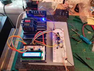

 Post subject: Progress has been made!
PostPosted: Sun Jun 12, 2022 7:15 pm
Posts: 489
Here's another picture for Chad. :P
I don't seem to be able to be both operational and tidy. That big mess is working great at 8Mhz. My continuing mission uncovered a whole comedy of errors... wrong resistor value, wrong capacitor value, (both of these off by an order of magnitude), a crucial capacitor connected to VCC instead of GND (!) - yikes.
The really critical bit, though, that made it work without errors was altering the design slightly. I had to reduce the value of the resistor in the RC circuit from 3k3 to 2k2 to eliminate the intermittent errors I was getting. I was getting the right number of pulses, but they didn't always line up with the data, so I was getting garbled scancodes every so often. I did not do any math to figure out the resistor size, I am slightly embarrassed to say; I just grabbed my big ammo-pack book of resistors and applied the good old "cut 'n try" method. :D
I think that maybe the reason I had to reduce the resistor size is that I'm using 74AHCT logic instead of the 74HC logic in Ben Eater's reference design.
PostPosted: Sun Jun 12, 2022 9:33 pm
Posts: 713
Thanks for the picture :) It looks like a nice setup honestly. I like how you have a backplane to plug modules into, and out of. I have never used one, but it seems handy.
Is that breadboard that the LCD is attached to itself attached to the backplane?
This is my greatest failing personally. Little resistor values that change big things. I, like you, just "wing it" when it comes to those sorts of things. 3k3 for anything connected to control lines on the 6502, 4k7 for anything on an address bus (basically banked RAM with a VIA), and 10k for slow things like keyboards and whatnot. I have no clue if that is good or not, but it has worked so far!
Why are you using the 74AHCT logic in particular? Perhaps the fast edges were not happy with the 3k3 resistor, but ok with the 2k2 resistor?
It's coming along well! So what's next on the to-do list? :)
Chad
PostPosted: Sun Jun 12, 2022 11:41 pm
Posts: 489
The thing with the mini-breadboard is TEBL's "RC Project Board." https://github.com/tebl/RC-Project-Board I made a few of them; I think they're really handy. My favorite one has female headers for the VIA ports, so I can use jumper wires to attach them to the breadboard, but I think I melted the headers internally (they're really cheap ones) when I was soldering them on, because if I bump data lines I get a whole lot of chaos. The one in the picture has male headers, which are more of a pain to use, but it's working fine so I can't complain. :) The breadboard is held on with adhesive, but it's not actually on the bus unless you wire it up. You can see on the right hand side there are a couple of VCC/GND headers for the power rails.
I'm using -T logic in particular because in the long run I want to mix in some older components. I have some M6845 CRT controllers, for example. I went with AHC over HC because TI seems to market it as equivalent to HC but better. Retro Brew Computers has some good info that suggests AHCT is basically a drop-in upgrade for 74HCT/74LS. Just to see what would happen, I tried taking all of the 74AHCT logic out and replacing it with 74LS, and the computer ran fine at 4Mhz, but not at 8Mhz. I think you are probably right about the fast edges!
Next I think I will have another try at making a more permanent keyboard circuit on my perf-board. I ordered some better wire-wrap wire (I hope!). The wire I was using has PVC insulation that won't fit through my wire-wrap tool the way it does in Garth's primer. I ordered a spool of Kynar wire; hopefully that will work better!
