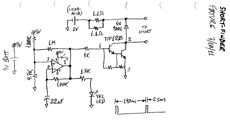

vmarcus wrote:
I got short between +5v line and a ground.
Did you find the shorts? I've been thinking I ought to post a number of circuits I've built, one being a short finder. We had a batch of very dense audio (not digital) boards with ground planes and a reference-voltage plane, and in some cases, there were shorts between the two planes. How do you find it, if anywhere you connect an ohmmeter, you get zero ohms? It was very frustrating, and at first I just considered them "beyond economic repair," and replaced the board. Then I had an idea to put a very low duty cycle high current (a couple of amps) through, and use the 'scope on a scale of 5mV/div and probe around and see where the voltage drop was the lowest, meaning that's where the short is. It worked wonders. Actually, it turned out the shorts were in a particular batch of capacitors we got, one voltage, size, value, manufacturer; so the seldom times I get one of these for repair now, I just replace all of those even if they haven't failed yet (although one always has, and that's why the repair is needed). Enough writing. I'll just scan it right now, from my 3"x5" loose-leaf binder. Here it is:
The unlabeled op amp is half an LM358.

Given that your description of your machine suggests a major short, I’d begin by focusing on the electrolytic capacitors. Electrolytics of that vintage didn't age well. The short-circuit detector Garth described may be able to help you find the electrolytic(s) that may be causing the most trouble. Or, if you are ambitious and know how to desolder capacitors without wrecking the PCB, you should consider replacing all of them (desoldering braid is your friend in clearing through-holes). Radial-lead electrolytics are cheap and readily available.

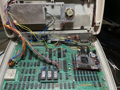

as a status update, alone way of my journey, I also got a hold of B128 – model CBM 610. This one had a with a 220-v power supply.
Being here in the US, I decided to replace the power supply on my own.
Lucky, I was able learned from others. Basically, I gutted out the original power supply circuit board and replace it with a MeanWell model PT-65B. Then I had to supply the 60Hhz timer feed, as required for the Video. Finally, taking the easier way out, I got pair of adjustable 555 timer module. Using a oscilloscope, I turned the variable resistors to desire frequency. Using one of the two +5v leads (at 5.5a) from power supply, I supplied the power as it, the timer module. Assuming, the module would pull in power as needed, would out burning out one of the modules. So, to remedy the situation, I limited the current with a 0.5 amp fuse, using the other module.
Well, while I was at it, since I had available +12v, I decided plug in the SBC Arm board that I had, into the mix.
So, now there are 2 video outputs from the same box, for this demonstration. I figure, I'll need fans at this point, but I'll need to first resolve issue some keys on not working on the original Keyboard. Yeah, some reason, the available ram in bank 3, is significantly reduced. Ugh, more hardware issues.
Ah, nothing like comparing an actual machine to the Vice (Commodore) emulator. A
File comment: The original power supply
