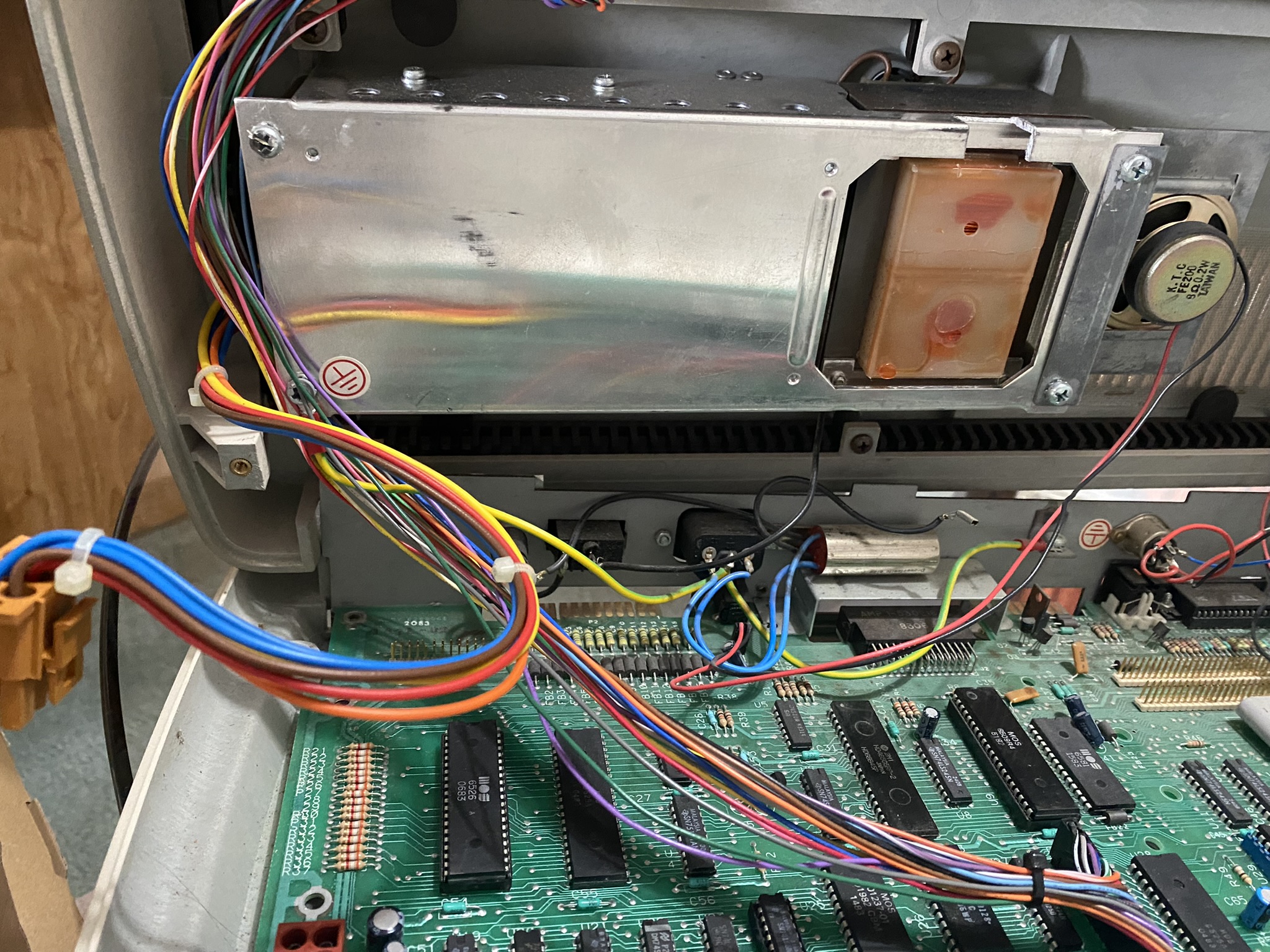

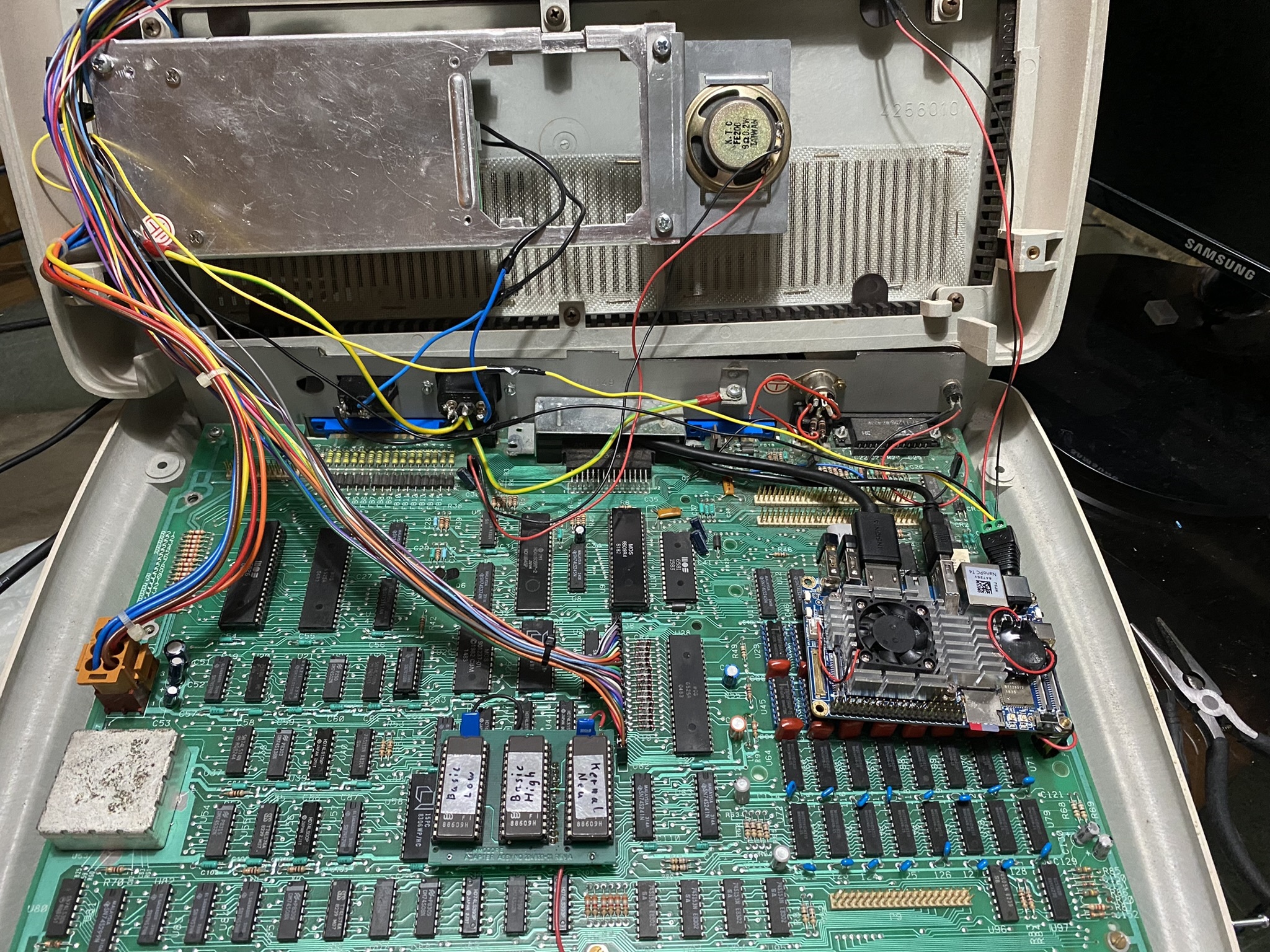

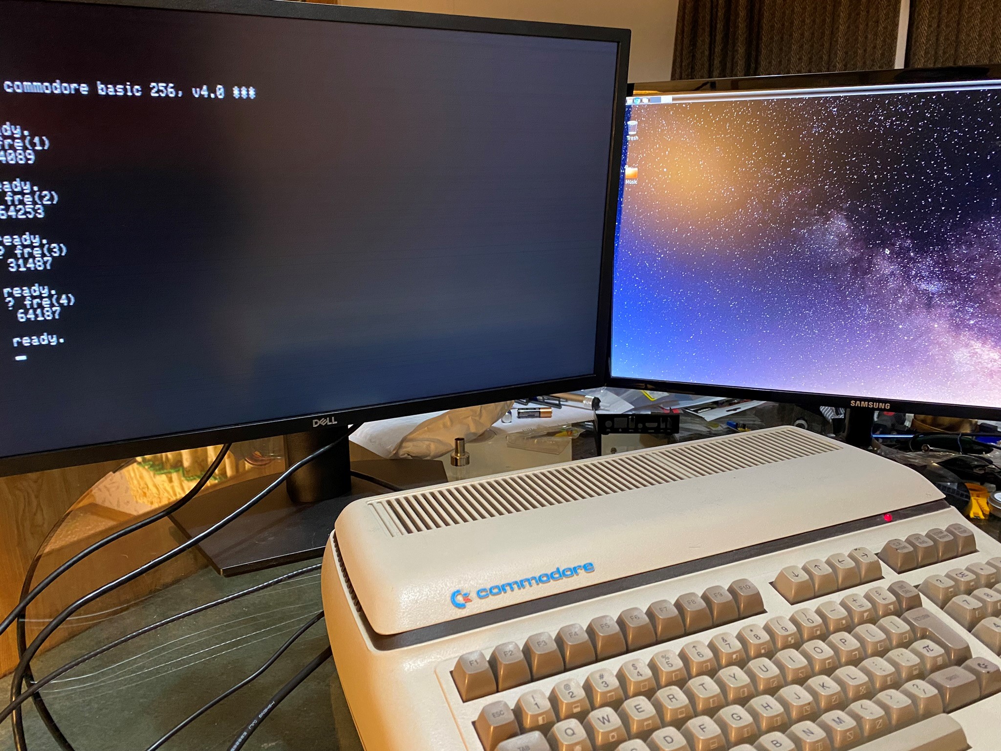

as a status update, alone way of my journey, I also got a hold of B128 – model CBM 610. This one had a with a 220-v power supply.
Being here in the US, I decided to replace the power supply on my own.
Lucky, I was able learned from others. Basically, I gutted out the original power supply circuit board and replace it with a MeanWell model PT-65B. Then I had to supply the 60Hhz timer feed, as required for the Video. Finally, taking the easier way out, I got pair of adjustable 555 timer module. Using a oscilloscope, I turned the variable resistors to desire frequency. Using one of the two +5v leads (at 5.5a) from power supply, I supplied the power as it, the timer module. Assuming, the module would pull in power as needed, would out burning out one of the modules. So, to remedy the situation, I limited the current with a 0.5 amp fuse, using the other module.
Well, while I was at it, since I had available +12v, I decided plug in the SBC Arm board that I had, into the mix.
So, now there are 2 video outputs from the same box, for this demonstration. I figure, I'll need fans at this point, but I'll need to first resolve issue some keys on not working on the original Keyboard. Yeah, some reason, the available ram in bank 3, is significantly reduced. Ugh, more hardware issues.
Ah, nothing like comparing an actual machine to the Vice (Commodore) emulator. A
