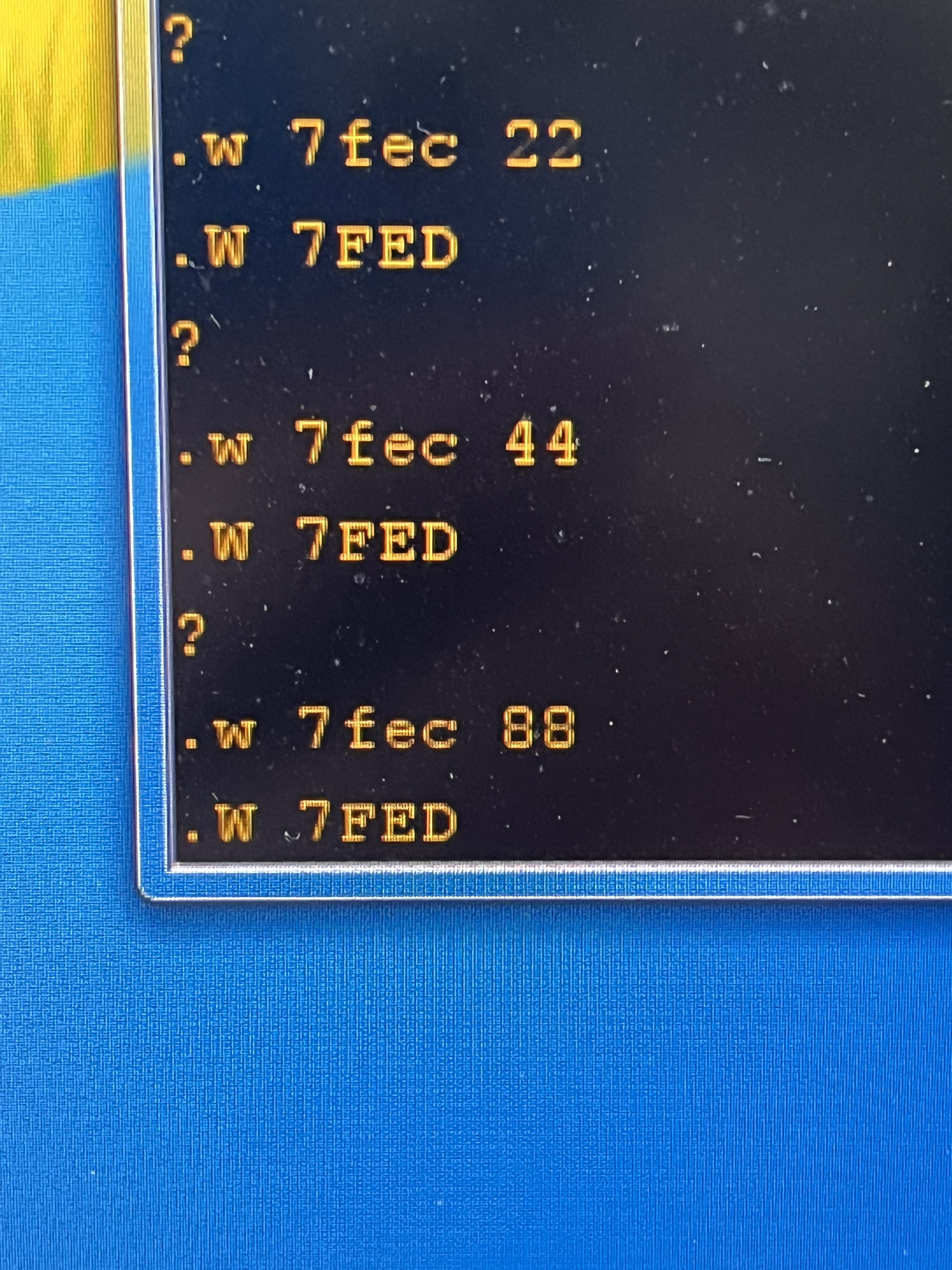

I managed to get his monitor running, although the fonts are a bit weird on my screen (he is using the Java Swing classes I think for the UI).
Anyway, I was able to do some basic testing via the monitor, and was able to test that the Accumulator could indeed be manipulated. However directly modifying the memory addresses (I just used A9 for LDA immediate) is hardly efficient LOL
But it was a quantum leap already in terms of what I have been able to do with the SXB board thus far.
I looked through the RAM (as opposed to the EPROM memory) using Andrew's monitor and there was a ton of stuff all over the place. I don't know if it is real code, or just random bits from powering up the RAM. Anyway I was able to write over portions of memory and hard code the above LDA test.

SUCCESS!!!
Finally found out how to turn on/off the lines!
I will show you the reset and interrupt vectors first.
And memory from $8100 onwards.

Turns out (no pun intended) that to turn on the LEDs, the lines have to be LOW from the perspective of the 65c22.
Here is the board at RESET / Power up.
PostPosted: Thu Jun 09, 2022 11:41 pm
Joined: Wed Feb 17, 2021 6:54 am
Posts: 69
Here are the LEDs for both lines turned on, after forcing the memory via the Java monitor.
Manual Write command to $7FEC.
PostPosted: Thu Jun 09, 2022 11:44 pm
Posts: 69
Writing using $8 and $C will trigger the LEDs.
$8 is %100X which is a "Handshake output" (I assume lines go LOW to begin handshake sequence).
$C is manual LOW output, %110X
