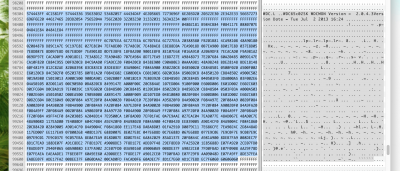

I used the cool HexFiend app to check out the binary dump on my Mac:
https://hexfiend.com

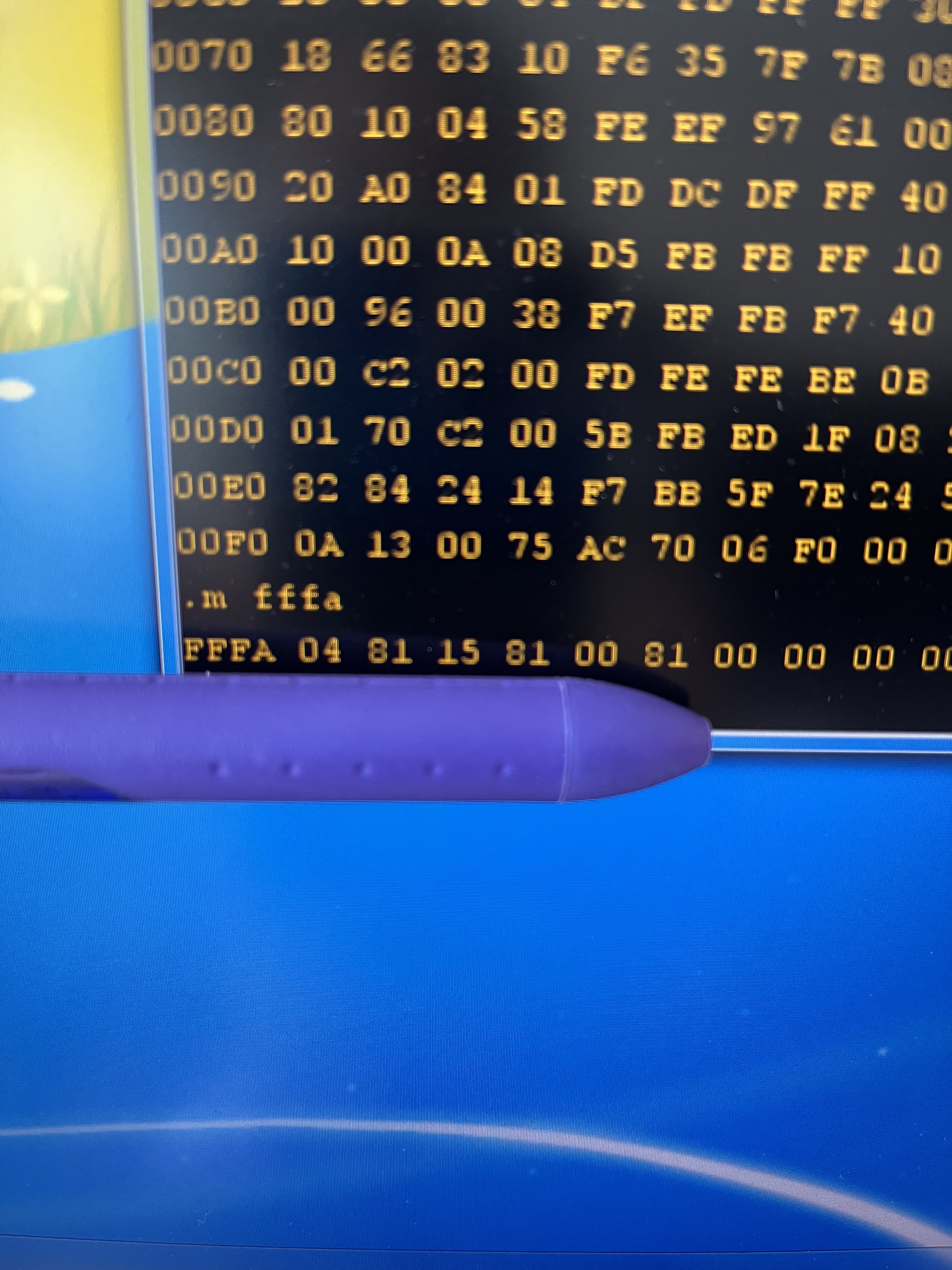

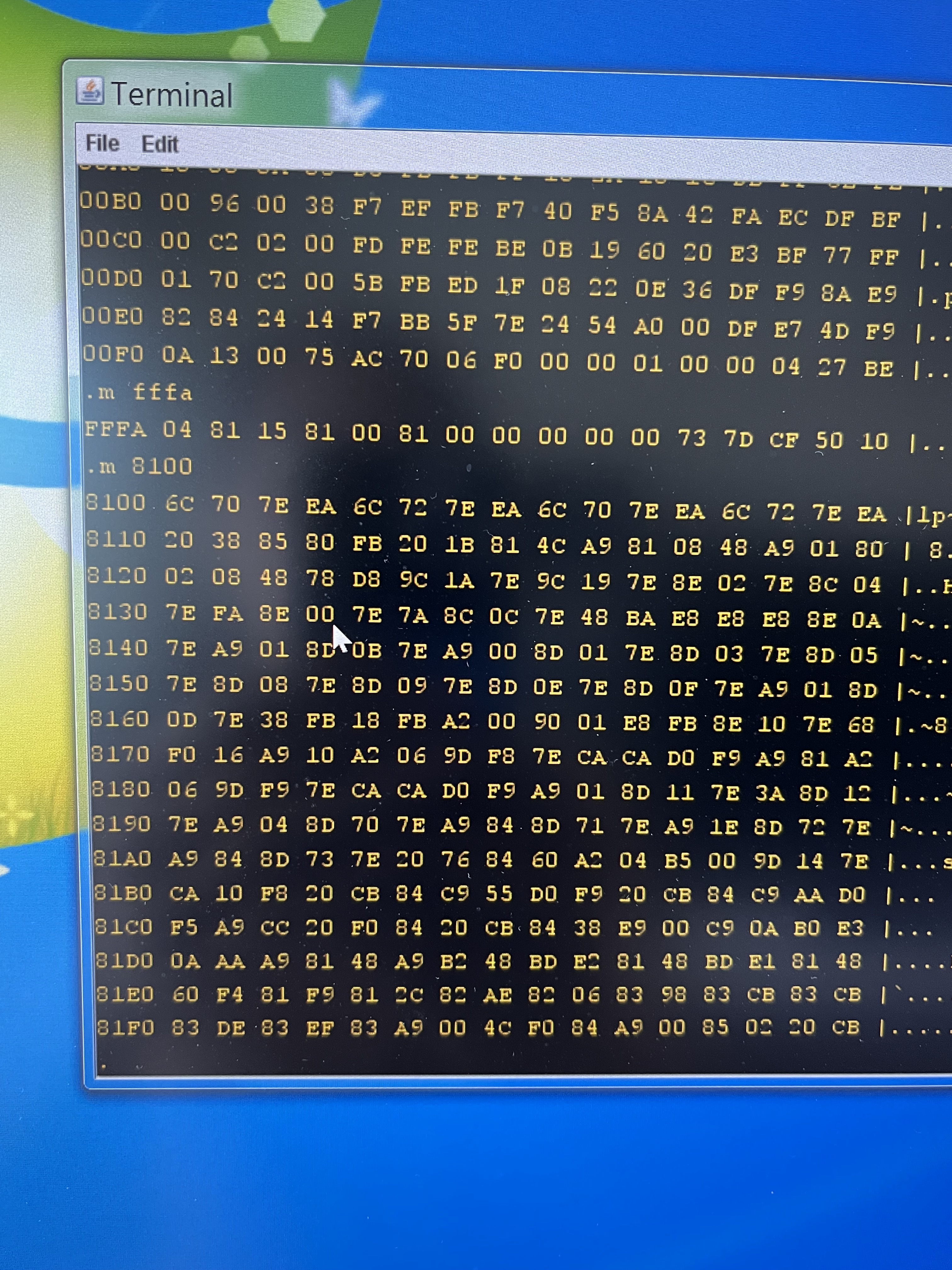

SUCCESS!!!
Finally found out how to turn on/off the lines!
I will show you the reset and interrupt vectors first.
And memory from $8100 onwards.

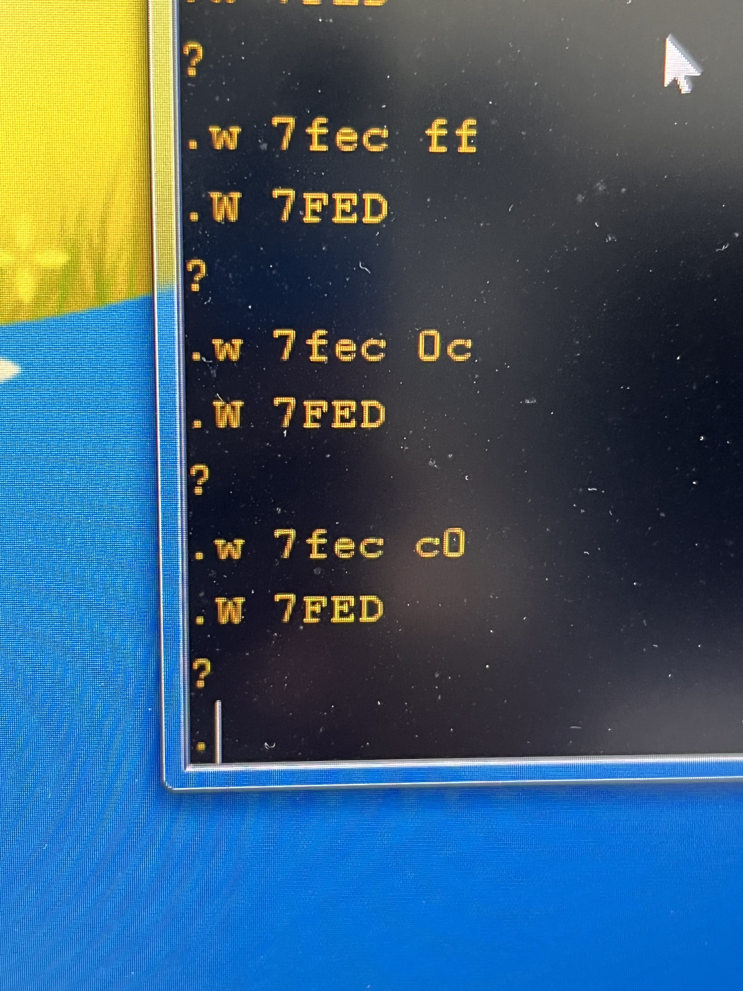

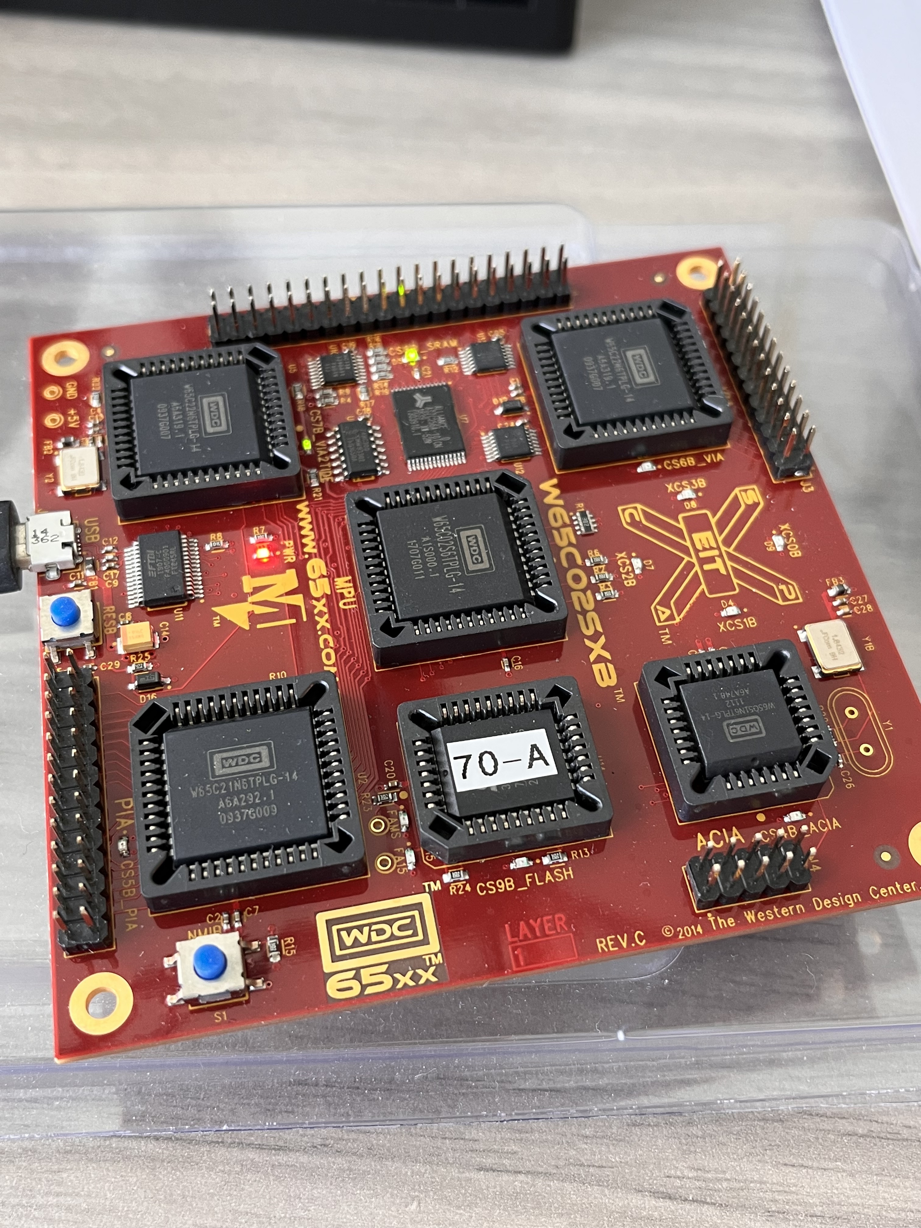

Turns out (no pun intended) that to turn on the LEDs, the lines have to be LOW from the perspective of the 65c22.
Here is the board at RESET / Power up.
PostPosted: Thu Jun 09, 2022 11:41 pm
Joined: Wed Feb 17, 2021 6:54 am
Posts: 69
Here are the LEDs for both lines turned on, after forcing the memory via the Java monitor.
Manual Write command to $7FEC.
PostPosted: Thu Jun 09, 2022 11:44 pm
Posts: 69
Writing using $8 and $C will trigger the LEDs.
$8 is %100X which is a "Handshake output" (I assume lines go LOW to begin handshake sequence).
$C is manual LOW output, %110X

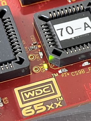

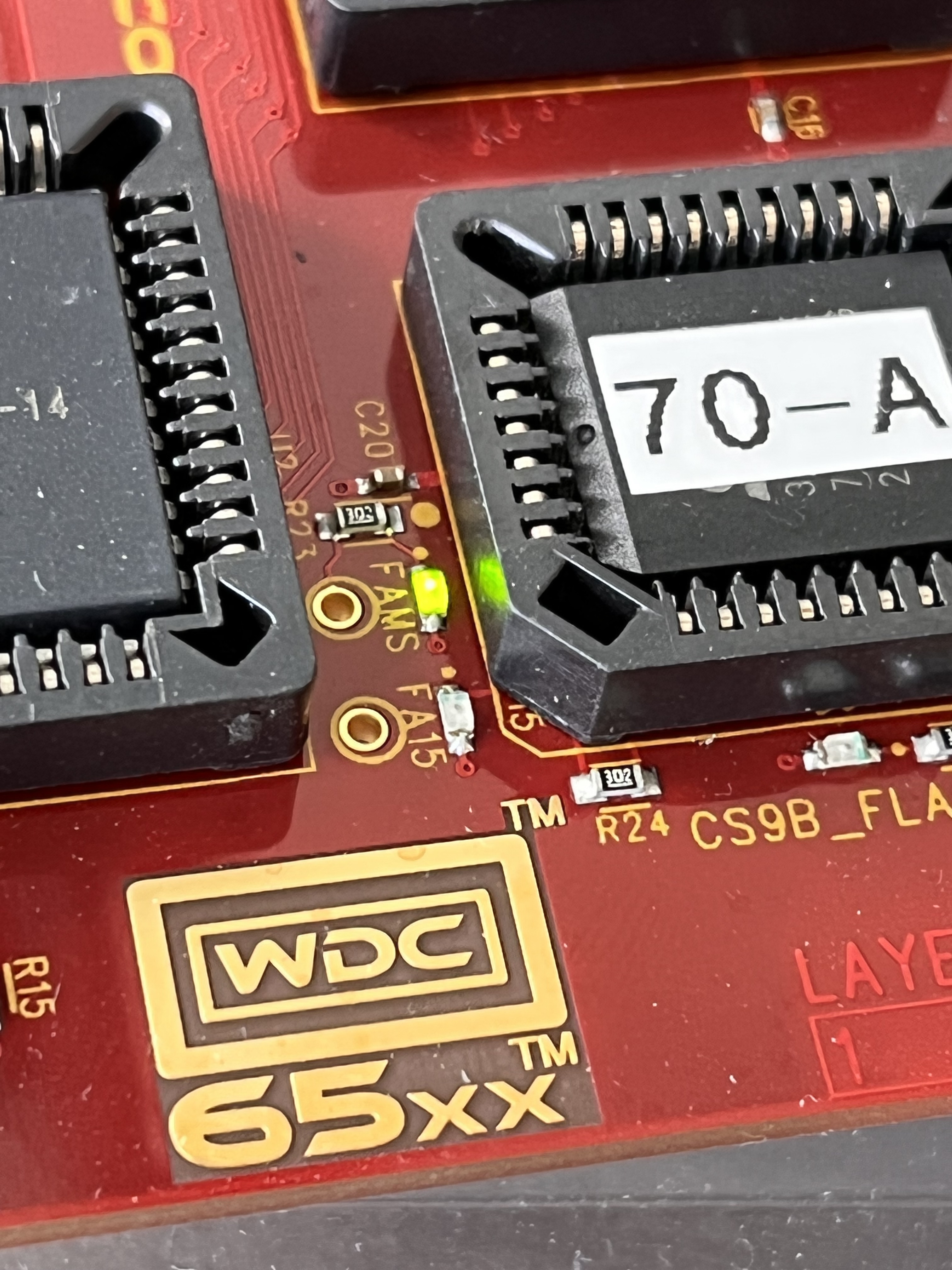

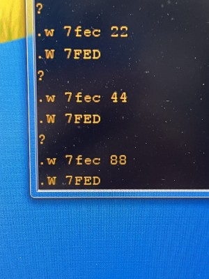

PostPosted: Thu Jun 09, 2022 11:45 pm
Posts: 69
Here are the FA15 and FAMS lines independently controlled.
