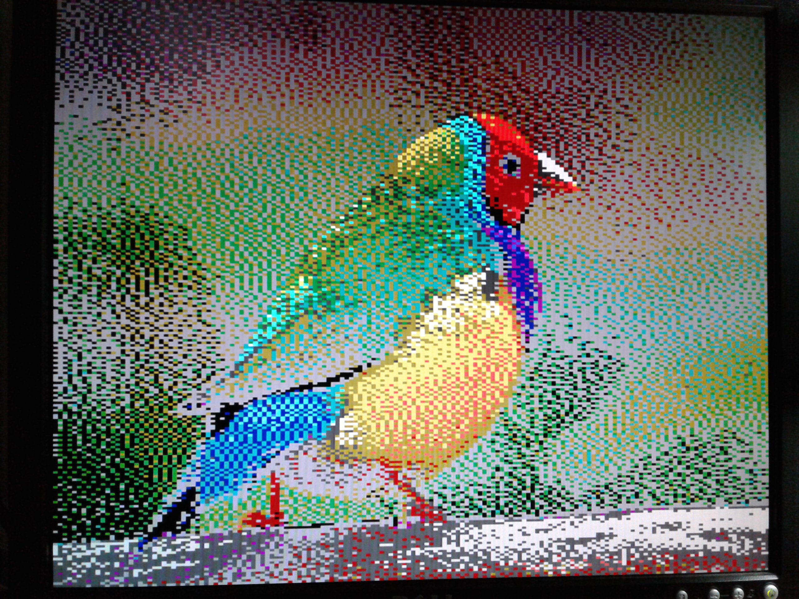

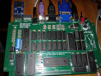

Hello everyone!
Revision 2 of the Acolyte 6502 Computer is now complete! Previous topic on the Rev1 board is found here:
viewtopic.php?f=4&t=7096
So for the past few weeks I have been working on revising the board, making small changes, adjusting color settings, and eventually adding audio-out and Genesis controller support. Attached are some pictures, commented code, and schematics. All extra info can be found here:
https://github.com/stevenchadburrow/Acolyte6502Computer
But I have a small story, and I'm sure you have had this happen to you to:
I soldered everything yesterday, and didn't want to even turn it on because I knew I'd be fiddling with it all night. Well, I turned it on anyways, and the screen was flickering. HUH? So I scrubbed the bottom with a toothbrush and the flickering went down, some. I was sure it was crud somewhere, so I went over my soldering again and again, and removed hairs and anything else I could find, yet it still flickered. I then pressed my finger on the expansion pin-holes and the flickering stopped! I touched in other places and it stopped, or got worse. WHAT? Surely I messed up a connection, or JLCPCB bit me again. The scope didn't help because if I scoped a problematic pin, the flicker would stop and the scope would read fine. UGH! What could it be? I whittled it down to my primary counter, a 74HC161. So I replaced it with another one, and the flicker entirely disappeared! YAY! This chip was *brand new* from Mouser, so what could have happened, I don't know. Glad I had replacements to test.
Other than that, nearly everything else worked as expected. I only had a very few small changes in the code I had been designing for this board. The software side is great, I have focused on using the keyboard Function keys to navigate. Some programs include a RPN Calculator, Music Composer, Assembler/Disassembler, Memory Dump, Data Movement/Transfer GUI, and a simple Snake game. I have had my 3 year old daughter test the system, and she has found many bugs along the way! Always have a young child test your 6502 computer, LOL! :)
Genesis controller is not yet working, but I'll be working on that later. I seem to have messed up my understanding on how it works, and basically I should have included 6x pull-up resistors on the board. I think I can navigate it in software, but that'll be for later. Other than that, all other things are working: EEPROM, SD card, PS/2 Keyboard, Audio Data In, Audio Sound Out, and of course VGA graphics.
Thank you all for the help and support along the way. I really couldn't do it without you. And, a very very special thanks to Garth, for his continual patience with me :)
Thanks everyone, have a wonderful day!
Yes, YAY! Congrats on your success, Chad. :)
As for that chip, did you try swapping the old one back in again? I wouldn't be surprised if the problem re-appears, but I also wouldn't be surprised if it doesn't.
You may already be aware, but I'll remind everyone that bad connections are an extremely common cause of trouble in electrical and electronic circuits. Solder joints are one example, but switches, potentiometers and connectors can be a point of bad connection, too. And it's not at all uncommon for the "bad" connection to fix itself after being disturbed.
An IC socket (and the IC pins) together work as a form of connector, and it's possible that removing the old chip and inserting another -- or reinserting the same original chip -- is the all the disturbance that's necessary to displace the problem. Maybe there was a bit of dirt or flux that landed in the wrong place? I'm purely guessing as to the exact mechanism, but experience has taught me to be wary of hasty conclusions (such as "must've been a bad chip").
PostPosted: Fri May 27, 2022 1:17 pm
Posts: 713
Thank you Jeff, I appreciate it. So I did just recover that old one from the trash, and replaced the good one with the bad one, and indeed the flicker came back. I put the good one back in, and the flicker went away. I probably couldn't even take a picture of the flicker, because it only happens in very particular circumstances and fairly minor. Last night I was showing it to my wife, and she couldn't tell until I pointed it out in a very specific spot on the screen. Of course I could tell immediately because I'm *looking* for issues like that. So, does the chip "work"? Yes, it functions. Does it work well? No, something is wrong with it, and I cannot tell what exactly.
So then, is this a "bad chip"? That is actually a good question. If I had 100 of these chips, and tested all 100 of them, would I get 99 of them without flicker? Or would I get 50 of them without flicker? Am I pushing margins and I just got lucky with this particular chip? Or in the end, is this just a bad chip? All good questions to ponder on. I will say that my "Half-A-Pi" and "AcolyteRev1" boards both used the exact same setup with this particular chip, and both of those worked immediately without any flicker. So we currently have 3 out of 4 chips work and as expected, and 1 out of 4 'works', but not as expected.
I'll hang on to this chip, for curiosity sake. But my curiosity isn't so great that I'm not going to move on to the next goal :)
Thank you again Jeff, good analysis.

Late to the discussion but I have a different view of your HC161 problem. The problem is not HC161 too slow but HC161 too fast is the problem!
Your original description of flickering going away when touching with your hand or scope probe suggested adding capacitance (your hand or scope probe) slowed down the signal thus reduced system noise (reflection or cross talk). Cold temperature speeds up HC device thus increases system noise; low voltage slows down HC devices thus decreases system noise. It all fit. You have a system noise problem most likely reflection.
Part of a new design qualification is sweeping the supply voltage and place the new product in temperature chamber, hot and cold while running diagnostics. It is an effective way to check for system noise and performance margin. Hobbyists do not have temperature chamber but adjustable power supply, small heat gun and cooling spray are useful tools to have.
BTW, not surprise at all your board working at 3.3V.

Signal Integrity (measurements of signal quality) is a difficult subject. There are tools that can take in the Gerber photoplots and bill of materials plus additional parameters and generate a list of signal integrity warnings but these tools are very expensive (at least 15 years ago). In absence of such tools and in the days before such tools were available, there are some rules that work (most of the times).
Filter cap and bypass cap are important but less so for multi-layer PCB with power and ground planes. Looking at your board design I see you've done an excellent job of forming power and ground grids on 2-layer PCB. That checks the box on good power & ground distribution.
Logic transition speed is the biggest problem affecting signal integrity. Transition speed is the transit time from 10% to 90% of final voltages. In most logic families falling edge is faster than rising edge so most signal integrity attention is focus on the falling edge. Termination is generally recommended if round trip propagation time is greater than the transition time. That boils down to the rule of 3 inch per nanosecond where "inch" refers to the circuit trace length and "nanosecond" is the logic transition time. So if your logic's transition time is 3nS then don't worry about signal length shorter than 9". Different components have different transition time; W65C02 is particularly troublesome because it is very very fast.
Signal integrity of data and address lines are not generally important because they are stable at the assertion and negation of controls. Control signals need to be as short as possible. Clock should be terminated because it goes everywhere and tend to be quite long.
Cross talk is difficult to analyze but it can happen especially when data and addresses are all switching from all (or mostly) high to all (or mostly) low. Failures due to specific data patterns are particulary difficult to troubleshoot.
Looking at your board with signal integrity mindset, I see good power & ground grids and fairly densely packed logic to reduce trace lengths, good. I see you are using fairly slow logic and RAM/ROM, good. W65C02 is fast, not so good and overall board size is quite large, also not so good.
It may be a good idea to serially terminate the clocks with 75ohm located as close to the clock source as possible. 74HC161 is your clock generator so I'll examine the traces coming out of 74HC161 carefully. The circuit of AND H1/H2/H4 to generate ~LATCH worries me...
Don't toss your "bad" HC161. It is the proverbial "canary in a coal mine". It warns you of the cliff ahead and tell you what operating condition may drive you into the cliff and what improvement you can make to back away from the cliff.
