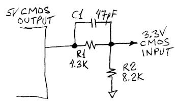

For a unidirectional line with a CMOS load, going from 5V to 3.3V is easily done with a pair of resistors; but to avoid slowing down the signal's edges due to the resistance and the load capacitance CL which is across R2, there should be a capacitor across R1:
The resistor values don't have to be these exact ones, the ratio of the two values should be kept the same. Standard 5% values go in the sequence 1 - 1.1 - 1.2 - 1.3 - 1.5 - 1.6 - 1.8 - 2 - 2.2 - 2.4 - 2.7 - 3 - 3.3 - 3.6 - 3.9 - 4.3 - 4.7 - 5.1 - 5.6 - 6.2 - 6.8 - 7.5 - 8.2 - 9.1 - 1 (and you can move the decimal place left one place or to the right up to about seven places). The value of the capacitor should be approximately CL*3.3V/(5V-3.3V), or nearly double the CL. Fortunately that doesn't need to be exact, because it may be difficult to predict the exact capacitive load of input(s), sockets, and board traces combined. Forum member akohlbecker posted a simulation of the effect of resistance and capacitance. Click on the L or H at the left end to change the input state, and on the switch in series with the 47pF capacitor to connect and disconnect the capacitor. You can see that without the capacitor connected, the rise and fall times are slow, but the when you connect the capacitor again, you get the square wave back. You'll probably have have more than the 3pF total load that he shows, so your edges will be slower. If you click the L or H at the left end quickly, you'll get kind of a triangle wave out, and if you do it quickly enough, you'll see it hardly reaches valid '1' and '0' states before turning around and heading for the other state. Re-connect the 47pF, and you'll get a nice square wave. Capacitor values don't generally come in the fine-grained sequence given above, and depending on where you buy yours, the next one down from 47pF might be 22pF. I would not go above 47pF.
This matter of capacitance is something the hackaday article missed.

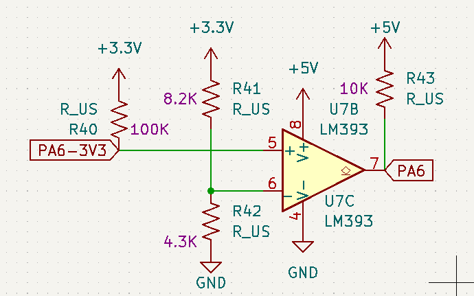

So I've been thinking about going in reverse with MISO for a while, and I have 1/2 of an LM393 left over from other stuff. Attached is what I *think* would work for MISO (mine is on PA6 in particular here). The 8.2K and 4.3K tied to 3V3 making a 'low' level of 1.1 V. So then comparing to 1.1V we get either high or low. Because the comparator could oscillate if left untied, I put a big 100K pull-up resistor on it, so leaving the comparator as high-Z. And then finally the 10K pull-up resistor brings it to 5V. Now, this MISO is tied to other 5V components, but... I think this should work? Thoughts? It's almost my first time trying this analog stuff out on my own. I'm open to all criticism!
Thank you again everyone!

That'll work. I give some tips on making the 339 or 393 work as fast as they can, at viewtopic.php?p=7612#p7612 .

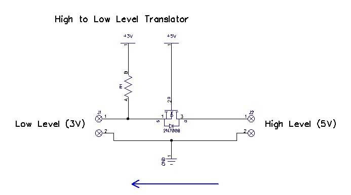

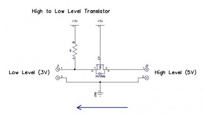

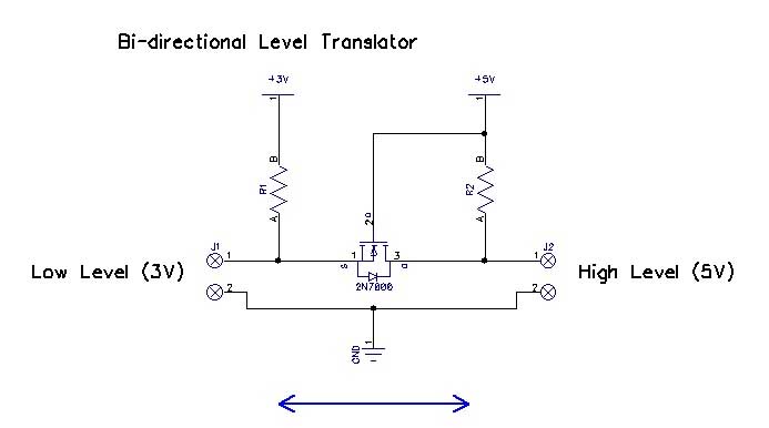

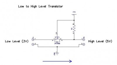

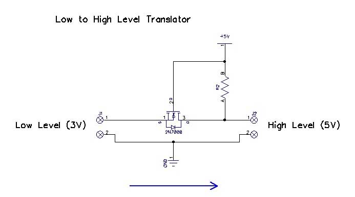

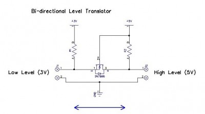

If your speed requirements are not too ambitious you can just use a simple 2N7000 MOSFET and one or two resistors.
This is a high to low translator: This is a low to high translator: And here is a bi-directional:

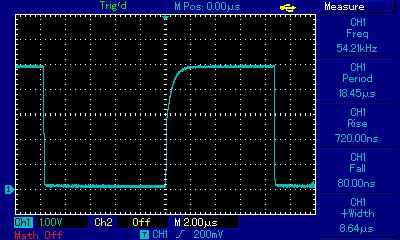

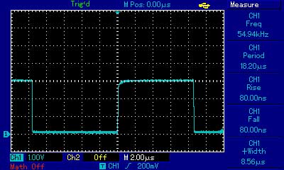

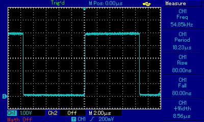

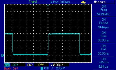

The following are waveforms @ 55Khz using 3.6K pull-ups. You can see they would work quite well up to about 500KHz. I have been able to do 1MHz using 470 ohm pull-ups, but I don't have any waveforms to show you. I did these measurements with 3V for low side. They will actually work a bit better with 3.3V
High level source: And corresponding low level output:
Low level source: And corresponding high level output:
