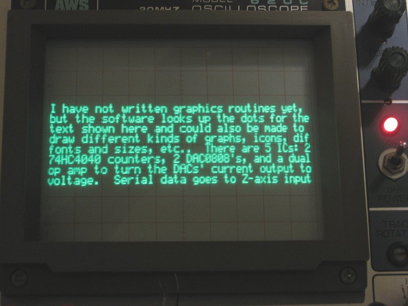

PostPosted: Sun Dec 13, 2009 4:37 am
A quote from the second page of this topic, regarding my raster-graphics circuit for use with an analog oscilloscope, mentioned on the first page:
Complete off-topic, but, any chance you have a collection of pictures of this thing in action?
As I wrote about it, I was thinking that I should take pictures of the screen with it working. I have not done that yet. It's one of many projects lacking from my project pages on this site. Some of the project pages that are there need to be updated.
Ok, finally, a picture:
Actually there's a little more description on previous pages. The beam is too fat and blurry to get higher resolution. It can be made more of a pinpoint by turning the brightness down, but the analog oscilloscope is not really made to be operated in this mode and you kind of have to turn the brightness all the way up and the room lights way down to see it the way it is in the picture. (Edit, 12/14/09: I tried another oscilloscope, and it worked better. It's brighter, and can be scanned faster without losing clarity.)
