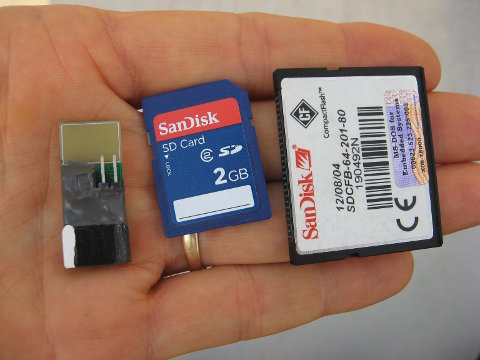

My own first application for SPI-10 is 4MB flash memories that come in a wide SO-8 package about 0.2"x0.3". Here's one of my home-made modules, and to the right, a standard SD card and a CompactFlash card. On the SPI-10 module, pin 1 is marked by a white stripe (I used white-out), and the two-pin 90° header is to put a jumper on for write-protect. 40% of the board is just there as a handle to unplug it, and/or to have a small space to label what you have stored on the module. You can make your own file system, or even use the module without any file system at all.
I've used this flash memory before, but only on an SO-to-DIP adapter, plugged into an 8-pin DIP socket. The SPI-10 module makes it much more convenient to insert and remove, and it won't get damaged in handling like a DIP's pins would.

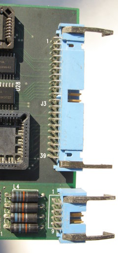

As for which side of the module is the component side, after checking the way pins are numbered on several VME and STD-bus boards I have (or have used), I lean toward making it the side with the odd-numbered pins. Here's a 3U VME board with two 90° shrouded pin headers with ejector hooks, with pins 1 and 39 labeled on the 40-pin one and pins 1 and 9 labeled on the 10-pin one, numbered top to bottom when the card is oriented the normal way in the card cage. If it were turned component-side up, the odd-numbered pins would be on top.
When we have a final spec., I guess I should put it in another post, and just put notes in the first one saying something like, "This portion has been changed, See the
Nth post for the final version."
