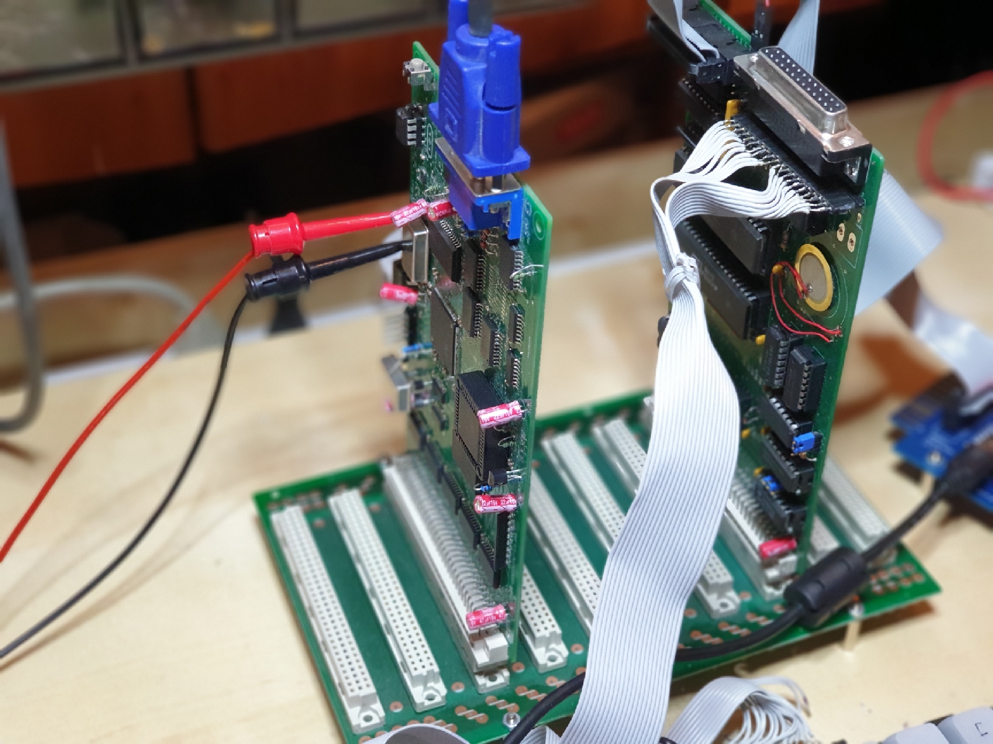

Ahem, yes, sorry, I rather missed the point. I was comparing the two over-chip caps in your picture, Jeff, where there is a very small difference between the relatively conventional and the micro-optimised.
I completely agree, of course, that bypass caps are needed and need to be pretty well connected to the chips in question, and also, of course, that power and ground need to be solidly routed and connected.
(I don't like phrases like "as close as possible" because they don't quite convey the real tradeoffs.)
tmr4 wrote:
akohlbecker wrote:
Yeah, I know that my decoupling capacitors do little on my breadboard, wired as they are.
I'd opine that they increase the stability of your build, even wired as is. I've seen many breadboard builds that were unstable without decoupling capacitors. It's an easy test. Take your decoupling capacitors off and see if your build still runs.
Agree with both of you!

Do you mean just the physical form factor and use your own signals? PCIe has the advantage of the simple board edge.
I am more concerned about the actual signals. I've been designing a backplane recently to use AppleII, RC2014 as well as RC6502 boards with my bus linked above. Apple II mostly had the address decoding. RC2014 had some signal conversions for the Z80 bus - which to the unknowing eye looks utterly strange - but was doable. The RC6502 although included is almost useless as it has no separate select line that disables the device in any of the non-dedicated bank.
Some RC2014 boards have quirks too in that they require e.g. the system to run at a specific speed to get the rs232 timing right on the serial interface. Some require latch timing on /wr, others on /mreq... it's just weird...
If your and my bus could be made compatible, I think it would be good for both sides.
Happy to discuss, also on a call if you like.

I don't want to throw a wet blanket on things; but especially if you hope to increase device speeds in the future, you'll need to distribute the grounds and bypassed power lines more evenly among the signal lines, rather than clumping them together at the ends like André's scheme. See this video, long but good, which makes the point that the signal energy does not travel in the copper, but rather in the dielectric space between the conductor and the return path. The copper merely guides it. The bigger that space between the signal line and the return path is, the greater the space has to be charged up, and the harder it is to get good performance. Mutual inductance will cause the closest neighboring lines to try to carry the return current; and if those are signal lines, you'll get unwanted crosstalk. As edge rates increase, so does the risk of going non-op.
I totally agree with your comments on ground and supply lanes on the bus for anything "faster" than my bus.
My newest board (to be revealed soon) is a uPET-based 12 MHz Colour-PET clone with VGA video, that runs at 12MHz entirely on its own Euro-PCB. It currently runs the cross-board bus at 1MHz, and will probably never go above 2 MHz, as I feel this is the maximum for this type of system (and works, as proven by my previous 2MHz-only designs).
I am just worrying about the type of signals. Mostly, is there a select line for memory, is there a select line for I/O on the bus, can the bus be slowed down for slower devices. The rest can be done on an adapter between busses (if a bus can be slowed down e.g. using RDY)
After all, the memory is the stuff that needs to be lightning fast. Byte I/O can be slower (depending on which type of course). Mass storage is maybe in the middle (potentially high latency but fast throughput once data is there) - but if the CPU is fast, it can compensate for that.

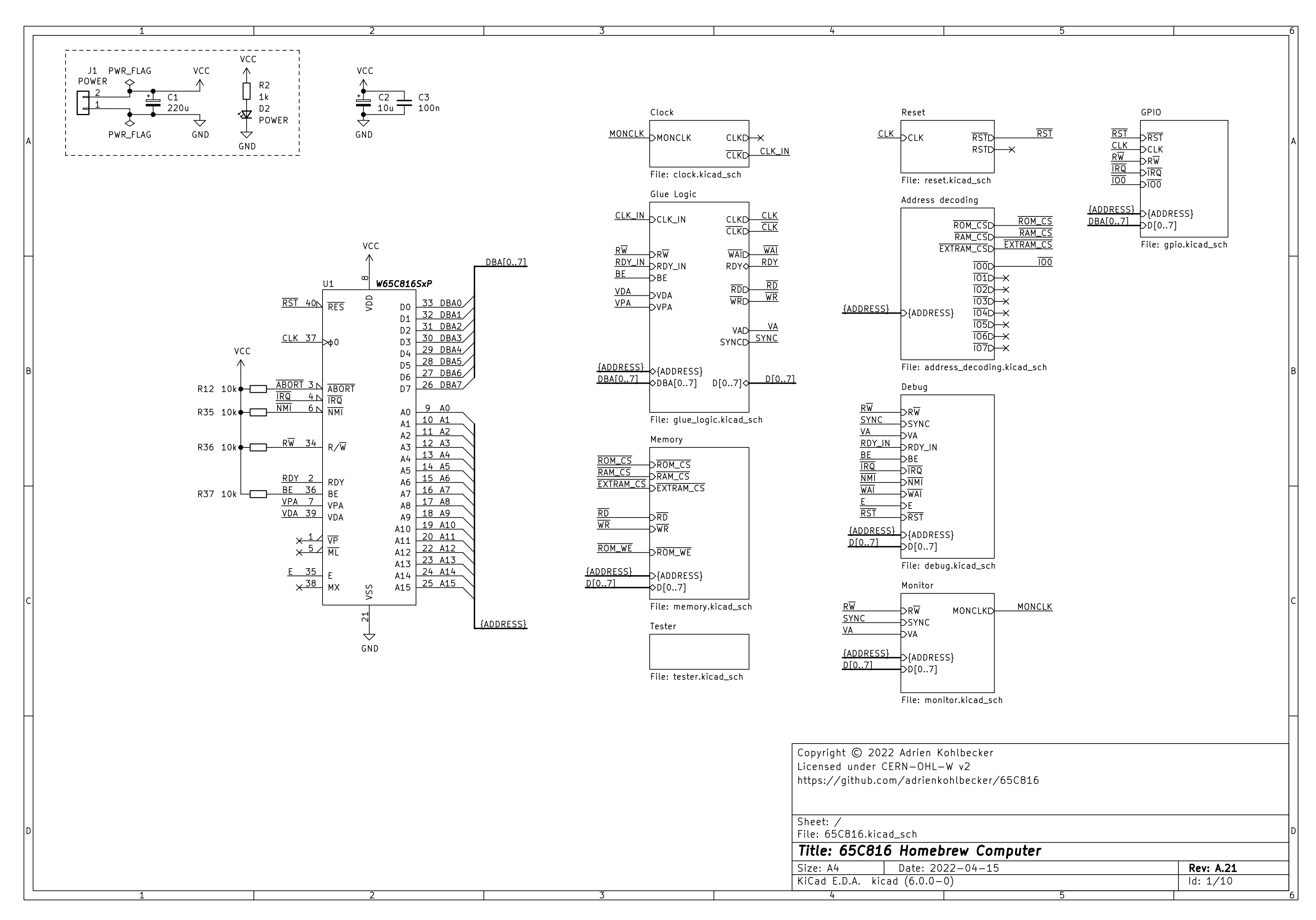

I'm leaning towards PCIe for the physical connector because of ground distribution and the issue that Garth has raised. The connector has 164 positions, and for the real PCIe standard, around half of those are ground, leaving 82 for signals. This is what it looks like physically:
82 signals would be plenty of space for what I want to include. If you look at my KiCad schematic, it is already grouped mainly by what would be a card in the future, so the signals that need to be on the bus are the ones connecting all the hierarchical sheets below. I might group one or two in a single card, like the glue logic and the CPU for example, but it is a rough approximation of what I need.
Going with DIN41612 would have the advantage of being period-accurate and being a bit easier to solder. You can also purchase pre-made prototyping cards. However the connectors are more expensive, I priced them on Mouser at around 2.5€-3€ per connector, of which you need 2 per card, whereas PCIe is less than 1€ per connector. I could also design my own prototyping cards.
That's all in the future though! The plan for now is to add a VIA so I can validate that I have all the right signals to drive the WDC bus interface, then do a 65C816 breakout board. It will contain everything needed to run this CPU with all the glue logic, demultiplexing etc. I'm thinking it will be useful for people getting into this CPU.
Good point. Seems to make a good choice for a high speed bus.
Do you have a link to a specific connector? I looked it up at Mouser, but all that were currently available did not seem to fit, or at least > 6€...
Looks like a good plan!
Question to your schemaitcs: where is /ROM_WE coming from?
These are the DIN connectors I looked at :
https://nl.mouser.com/ProductDetail/Amp ... r8Iw%3D%3D
https://nl.mouser.com/ProductDetail/Amp ... hoXA%3D%3D
And these are the PCI express connectors I looked at : https://nl.mouser.com/ProductDetail/649 ... 8410203TLF
At the moment from nowhere, it just has a pull-up. I plan to wire it up to the Teensy but first I need to solder the optional header on it to get access to more GPIO
