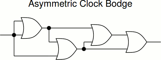

I like to be wowwed and you never disappoint. 20MHz is becoming routine. However, 20MHz, 64KB RAM *and* 32 I/O strobes is very impressive.
Your work often leads to disbelief but I never doubt your figures. Actually, you've inspired me to adapt your address decode strategy. It is possible to eliminate the 74x688 and make one tier of address decode (and extended address latching) which all runs in parallel.
I am alarmed by your lack of capacitors but you can't argue with success.
BigDumbDinosaur on Fri 22 Apr 2022 wrote:
I tested the read/write circuit at 50 Mhz, observing its behavior on the scope.
On Tue 22 Mar 2022, I confirmed that 74HC138 and 74HC139 inverts a 64MHz crystal and implements BigDumbDinosaur's suggested circuit without encountering latency from two sets of clamp diodes. Actually, I ordered 64MHz, 72MHz and 80MHz crystals from dubious suppliers. Of these, one arrived and claims to be 64.000MHz crystal. From data-sheet inferences and cursory test in a limited temperature range, a system with 30MHz RAM and eight or more I/O strobes is possible. With clock stretching, asymmetric clock and 74AC logic, 40MHz might be possible.
74HC139 has become relatively scarce but I only considered 74x00 as a substitute rather than 74x138. Radical Brad shows empirically that 74x138 works for read/write qualification at 20MHz.
Regarding asymmetric clock, akohlbecker has been very formal in a 65816 tutorial video series and has introduced two 10ns delay lines to obtain timings which are completely conformant with data-sheets. 5ns delay line and one OR gate would provide a useful quantity of clock asymmetry. This would compensate for the bus capacitance and clamping diodes which are encountered during 6502's external bus phase. It would otherwise allow 6502 to run at maximum speed. If you don't have a delay line, you can bodge it with two or more OR gates. (A delay line is vastly preferred and I apologize for making professionals wince.) Four sections of 74AC32 should add approximately 6ns and two sections of 74HC32 should add approximately 5ns. Unfortunately, you might get 74x32 which barely meets specification. In this case, asymmetry may be skewed far more than required.
Due to marginal components which remain within data-sheet specification, I prefer to use the address lines of 74x138 before using the enable inputs. 74x138 data-sheet diagrams suggest that the three enable inputs are aggregated and then fed into a final stage. Timing specifications are consistent with this arrangement. However, I understand that 74x138 is commonly implemented with six input logic gates to reduce signal glitching. In either arrangement, enable inputs may be slower than unused address inputs.
Although Radical Brad may be strongly dis-inclined to use 65816, it is possible to add one or two 74x157 chips in a loop-back configuration to obtain 20 bit or 24 bit addressing. This averts the latency of the inverted latch signal shown in the 65816 data-sheet. Ignoring the additional capacitive load (and fragmented memory which is a deal-breaker for many people), using 74AC157 as latch may be no slower than the 4ns latency claimed by Radical Brad.
asymmetric-clock-bodge0-0-0.odg [5.75 KiB]
Downloaded 30 times
