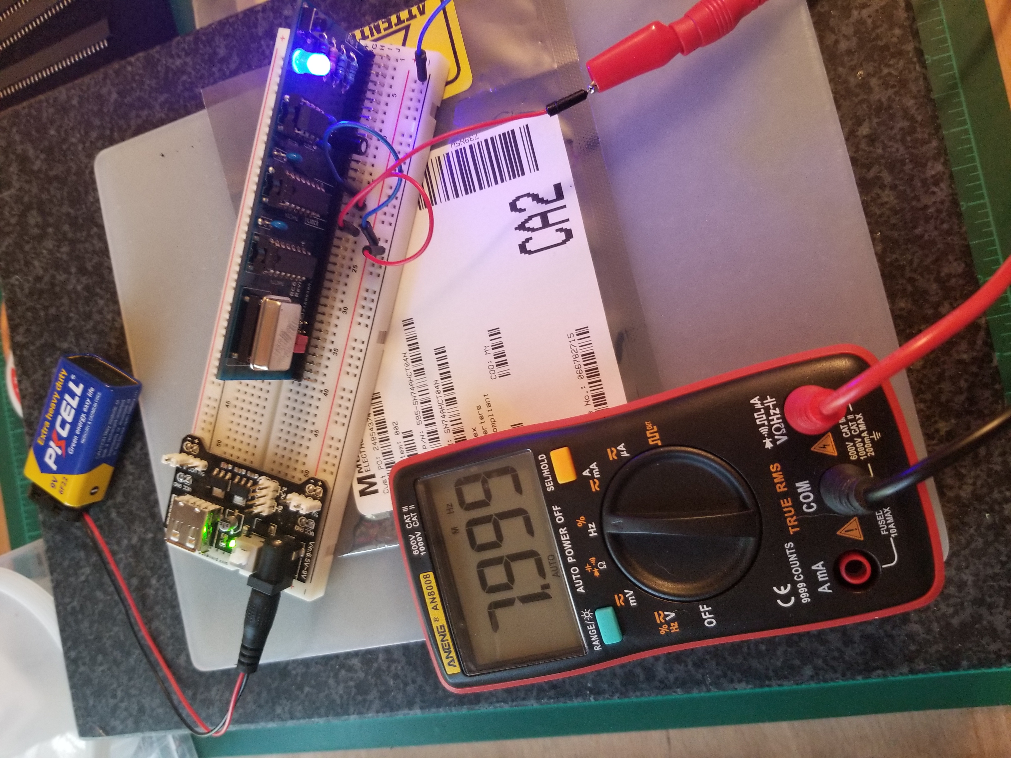

I had in mind to make this thread a step-by-step chronicle of building my first kit computer, an RC6502. I figured I would name the computer "Blue April," since... it's April, I was born in April, and I grew up in the '80s, when exciting computers with "Blue" in their names featured prominently in magazine ads that I gazed at.
The plan was to start with the simplest board (the backplane) and work my way up to the most complicated, meticulously testing as I went. Since I hadn't soldered anything since high-school (and that was stained-glass windows, not electronics), I figured I shouldn't get anywhere near anything more expensive than a resister with a soldering iron until after I had some practice.
All the PCBs I ordered came right away - *except* the backplane! It *still* never showed up (it fell into the black hole that is the USPS Atlanta Peachtree NW Distribution Center) and I ended up ordering a bunch of them from PCBWAY. Meanwhile I practiced soldering on the other boards, but with no backplane to power and connect them to each other I didn't really have a good way to test them.
Anyway, here are some photos of the project, my little workspace, and a couple shots of my home-made EPROM de-programmer, just for fun:
As far as I can tell with my little multimeter, everything is working out OK. The voltage regulator on the backplane seems to be working, the clock module is producing a steady 8Hmz. However, I have encountered a puzzlement. Here is my testing setup:

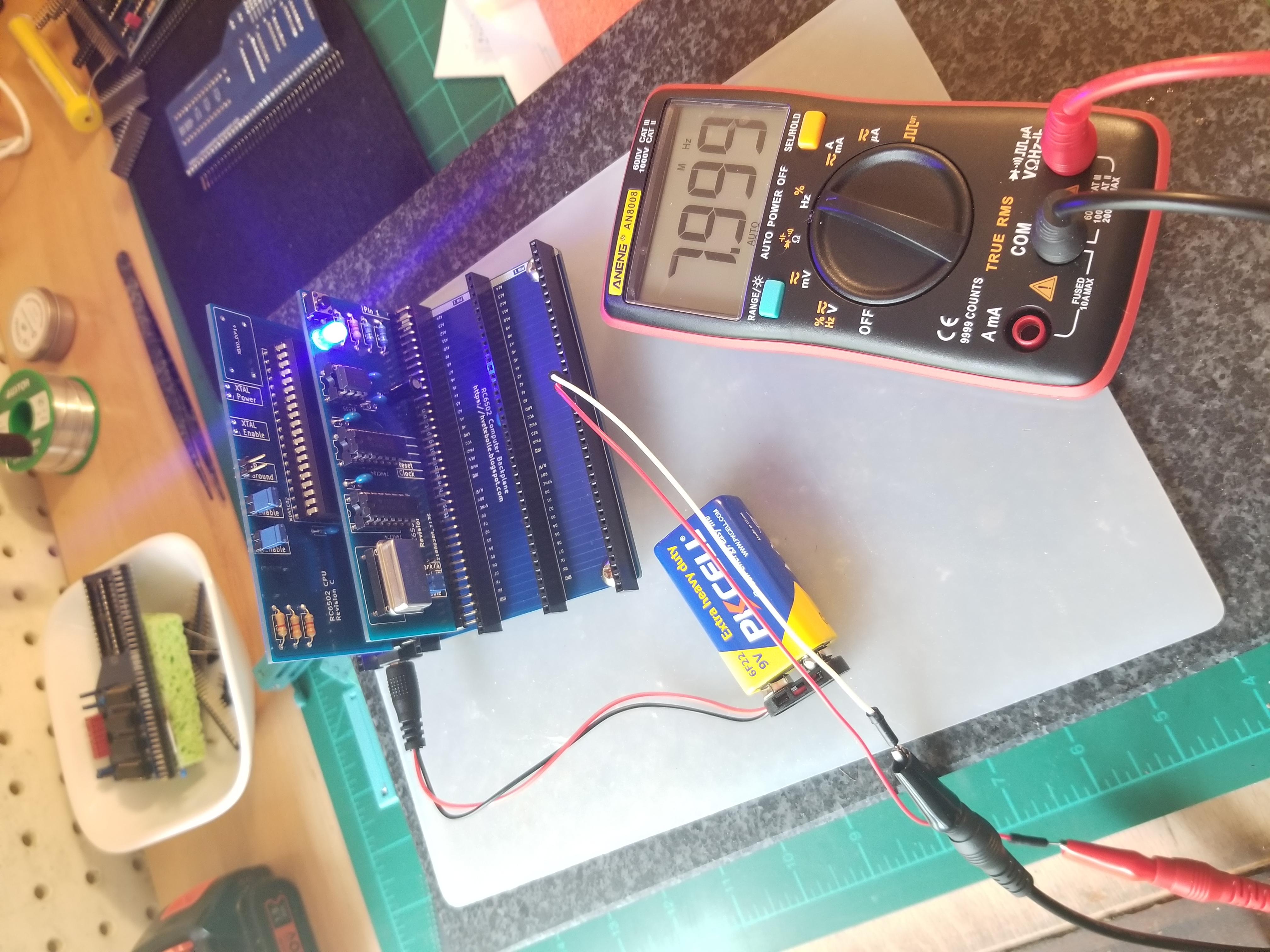

If I pull the SBC from the backplane and plug in this CPU module instead (using selfsame CPU):
The address lines fill with gibberish. The CPU board is such a simple one that I can't understand what I might have done to it that made it not work.

The only differences I spot concerning the CPU are that in the SBC pin 3 (PHIOut) is sent to the bus and pin 36 (BE) is pulled high through a resistor, whereas the CPU module leaves both of them unconnected. I can't see how PHIOut would have anything to do with what I'm seeing; the data-sheet from WDC is somewhat laconic about the BE pin.
The Bus Enable input signal provides external control of the Address, Data and the RWB buffers. When Bus Enable is high, the Address, Data and RWB buffers are active. When BE is low, these buffers are set to the high impedance status. Bus Enable is an asynchronous signal.
Does "high impedance status" mean that the CPU is totally cut off from the address / data lines unless BE is pulled high?

The only differences I spot concerning the CPU are that in the SBC pin 3 (PHIOut) is sent to the bus...
WDC no longer recommends the use of Ø1 and Ø2 out. Those signals exist primarily to support older systems that relied on those outputs for clock signals. Neither is tested in production and WDC doesn’t even guarantee the two signals will be exactly 180 degrees out of phase, or by how much they will lag the clock input. Best if you follow their recommendations.
...and pin 36 (BE) is pulled high through a resistor, whereas the CPU module leaves both of them unconnected.
As a general rule, no inputs on any CMOS device should be allowed to float. All inputs should be driven or pulled up/down. If a CMOS input is left floating it will likely pick up noise and cause the device to do silly things.
the data-sheet from WDC is somewhat laconic about the BE pin...When Bus Enable is high, the Address, Data and RWB buffers are active. When BE is low, these buffers are set to the high impedance status...Does "high impedance status" mean that the CPU is totally cut off from the address / data lines unless BE is pulled high?
When BE is high, the 65C02 will drive all of its outputs. When BE is low, A0-15, D0-7 and RWB will go to the high-Z state, meaning those outputs will not drive anything and will look like an open circuit to anything connected to them. This feature makes it possible for something else to take over the buses, e.g., a DMA controller.
I've done what testing I could think of with my multimeter, in terms of continuity testing all the pins on the connector against their corresponding pins on the CPU socket; the resistors are resisting. I'm stumped!
Try pulling BE up to VCC with a 3.3K resistor and see what happens.

Well shi..gee that sucks. After I posted last night I continued searching and found this thread: viewtopic.php?f=4&t=6153 (Apparently, searching for "WD65C02 BE PIN" will provide bupkis, but "W65C02" all by itself will get you just what you're looking for... go figure.)
It appears that although the schematic lists U1 as W65C02, and the *actual silkscreen* on the PCB labels it as W65C02, and even though there's a jumper for VP ground (!), a W65C02 will not actually work on the CPU module, due to BE left unconnected. That's frustrating!
That did the trick! Woop woop!

Pin 36 of the NMOS 6502 is a no-connect, whereas it’s BE on the WDC 65C02. The meaning of “no-connect” varies; in some cases, it’s just a pin with no connection, but in other cases, it is internally attached to something and hence should not be externally connected.
If I were making a “universal” MPU module, I’d have jumper blocks on it to isolate/connect pins 1, 5 and 36. Doing so would make it possible for the module to accept any type of 6502, meaning an NMOS part, any of the non-WDC CMOS parts, e.g., the Rockwell R65C02, or the WDC part. Pin 1 is ground on non-WDC parts, but is VPB on the WDC 65C02, which is an active output. Needless to say, you wouldn’t want that grounded.
Pin 5 is a no-connect on a 6502 or non-WDC 65C02, but is MLB on the WDC 65C02, which is also an active output. While pin 5 could be left unconnected in any case, MLB might be of interest with the WDC part. So I’d make a provision to be able to use it, same as with VPB.
The other pin to watch out for is SOB (pin 38). SOB is an edge-sensitive input that when asserted will set the overflow (v) bit in the status register. SOB should always be pulled up to Vcc to avoid v being randomly set and causing otherwise-inexplicable logic errors in programs that depend upon its status following an instruction that affects it, e.g., BIT. If no use of SOB is planned, it is safe to tie it directly to VCC and save the “cost” of a resistor.
Lastly, RDY on the WDC 65C02 is bi-directional and should never be tied directly to VCC. When the MPU executes a WAI instruction, it will drive RDY low. If RDY is tied direct to VCC, the MPU will try to sink the power supply when WAI is executed, resulting in a major malfunction. Typically, a 3.3K pullup is used in circuits that don’t use RDY. If RDY is to be driven by the output of another device, it must be connected to that device through a Schottky diode, or through a resistor of a sufficient value to limit current flow to a safe level. If the diode method is used, the need for a pullup remains, since the driving device can only pull RDY low.
