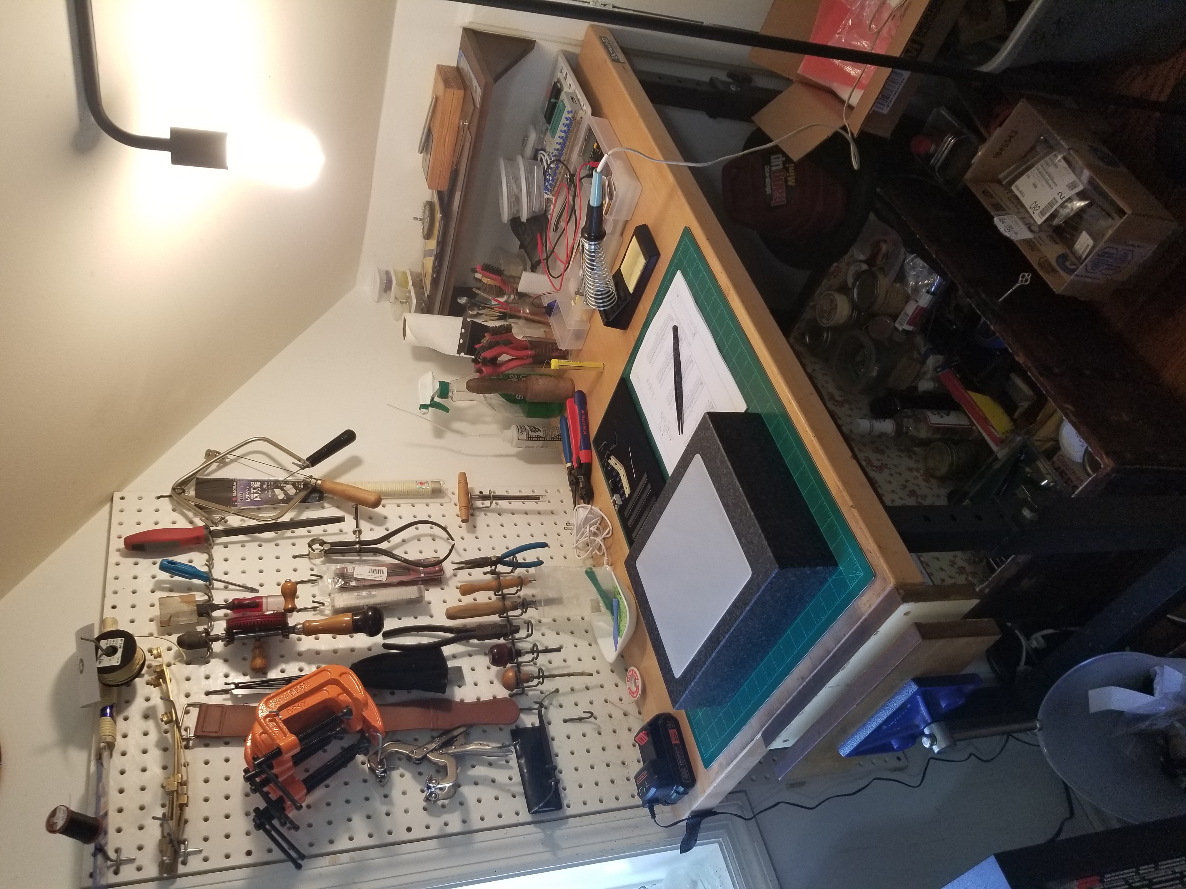

Anyway, here are some photos of the project, my little workspace, and a couple shots of my home-made EPROM de-programmer, just for fun:
