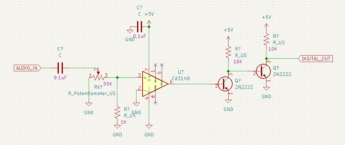

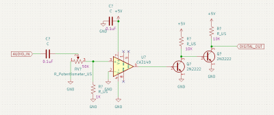

So I've been on a bit of a quest today. Trying to make this thing reach a 74HC' without a 74HCT' in between.
Attached is what I came up with. I think this works, I have been testing it with the 'scope with various levels of the pot.
I am seeing signal degradation if I try to hold the signal high too long. I see what's coming in and out of the OpAmp and it spikes at the beginning, but trails off rather quickly. Adjusting the pot lengthens or shortens the duration of a $FF type of byte, which is bad news. Single short bursts are unaffected. The $00 type bytes seem unaffected.
Anyways, the two 2N2222 transistors step-up the signal coming out of the OpAmp from around 3V or so to 5V. I'm getting a nice clean signal on a plain ol' 74HC00 with this! Does this look right to you guys? I am extremely new to analog stuff. Looking stuff up online has helped a bit of course.
Just wanted to by-pass a whole 74HCT' chip, that was the main goal of the day. I'm a little worried about signal degradation, though that's not the transistors fault (was getting that with the 74HCT' chip too), but I'll be working with this in software and hope to report back more results soon.

Would you prefer that the output be low, or high, when there's no input signal? Or does it matter? (I would do it with a single comparator section of an LM393 dual, and omit the transistors; but which way you want it would determine the configuration.)

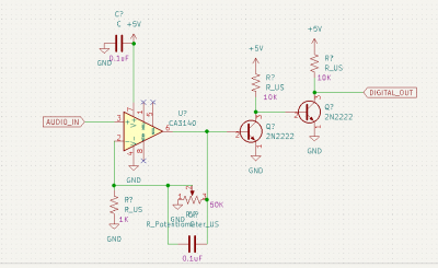

Hey everyone!
I got a PM from MichaelA yesterday, and he helped me with a new style, using the OpAmp as a amplifier, not a comparator. Thank you Michael, I hope you are ok with me posting about this.
Attached is what I've got going. I haven't verified with Michael if that is exactly what he was thinking about, but he did confirm the outline I used was correct.
I think the signal is more consistent, adjusting the pot does not change much besides a bit of duration, but definitely within spec. BUT, it seems to only work properly if I use the entire sine/square wave, both positive and negative. If I use only positive and 0V audio format, the pot varies the signal duration to much greater lengths, which is not good for speed purposes of course.
Can I make full sine/square waves on the desktop computer? Yes. Can I create those from a 6502 5V system (when I'm recording)? Eh. So I did some research, and made a little tester 'audio-out' circuit using a capacitor and big resistor (see attached). The problem I am seeing is that it takes a while to 'warm up', but if I have a oscillating signal and simply 'turn it on' for some time, I think I can get a signal out that would make sense to the desktop computer. Don't know how to do that yet! I had assumed that sending audio out of a 6502 was literally just putting a 10K resistor on a signal line. That is what I had seen on the Apple 1 cassette schematic, or at least how I interpreted it.
I think there are ways to create sine/square waves with both positive and negative voltages using a DAC or something, but I am very very unfamiliar with that.
So, progress, and learning! Thank you again Michael, and again I hope that posting this is ok.

I note that on your schematic you’re biasing the opamp at GND. Is this intentional?
I would probably bias it at half VCC. Maybe it’s just the phase of the output that’s affected by that.

Biasing at ground is typical for if you have ± power supplies, which you don't.
Op amps don't do well as comparators because if they hit the ends of their output voltage range, they take longer to recover. That may not be a problem here at these lowish audio frequencies. A cheap LM358 dual or LM324 quad op amp can still do about 7kHz when clipping at both ends of the range, if I'm remembering my test results from years ago correctly.
Comparators are made to hit the end of their output range and do not expect to spend time between full positive and full negative. They're also made to be faster for a given price point, but they don't try to hold to a phase margin, meaning that if you try to use one as an op amp, you'll get an oscillator unless you take appropriate measures which will mean slowing it way, way down.
The LM393 dual comparator (and LM339 quad) has open-collector outputs, so they can pull all they way to ground, and the high end of the range is whatever you pull it up to, in this case 5V. There's no need of additional output transistors. The voltage you power it from is independent of what you pull the outputs up to, although it the diagram below I did it all for 5V. This is slightly simpler than what I originally had in mind, since you said you didn't care what it does when there's no signal. The bias point is 1.8V, not 2.5V, because the input range does not extend all the way to the positive rail like it does to ground. 1.8V puts it approximately in the middle of its input range when you power it from 5V.

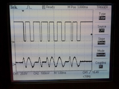

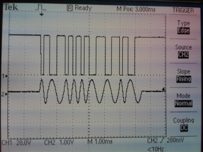

Hey everyone! Updates:
Garth's circuit above is great! The only issue was that I had said, "I don't care what the output is without a signal." But what I meant to say was, "I don't care if the output is low or high, as long as it is constant, without a signal." Garth modified his circuit to pull the output high when not in use, see attached.
I then made a small C++ program to combine 2000 Hz and 1000 Hz sine waves as 1's and 0's. Output is nice square waves between 0V and 5V, perfect!
Then I programmed the 6502 to read PA6 on the VIA, "babysitting" mode, no interrupts. The operation is very simple: Wait until PA6 goes low. Then count down from some arbitrary value. If PA6 goes high before the count is zero, it's a short signal. If the timer runs out, it's a long signal, but then NOP until PA6 changes back. Very simple, even in my weird and non-optimized code it was only about 33 instructions.
I was having WEIRD readings for a long while though! Every short was coming in as a short, sometimes coming in as 2 shorts. But every long was coming in as a short, long, and then another short! HUH? It took me a couple hours until I figured it out. It's not my code, it was the signal! I zoomed way in on the scope and sure enough there are little spikes right before and after every long. What I then did was when I saw PA6 change I NOP'd 16 times and that fixed it immediately.
We have mass data input!!! Super excited to see this. I think I'm going to ditch my ideas to record from the 6502 though.
Off to the next project. Thank you everyone, and a HUGE thank you to Garth! Again, I couldn't do what I do without y'all.
