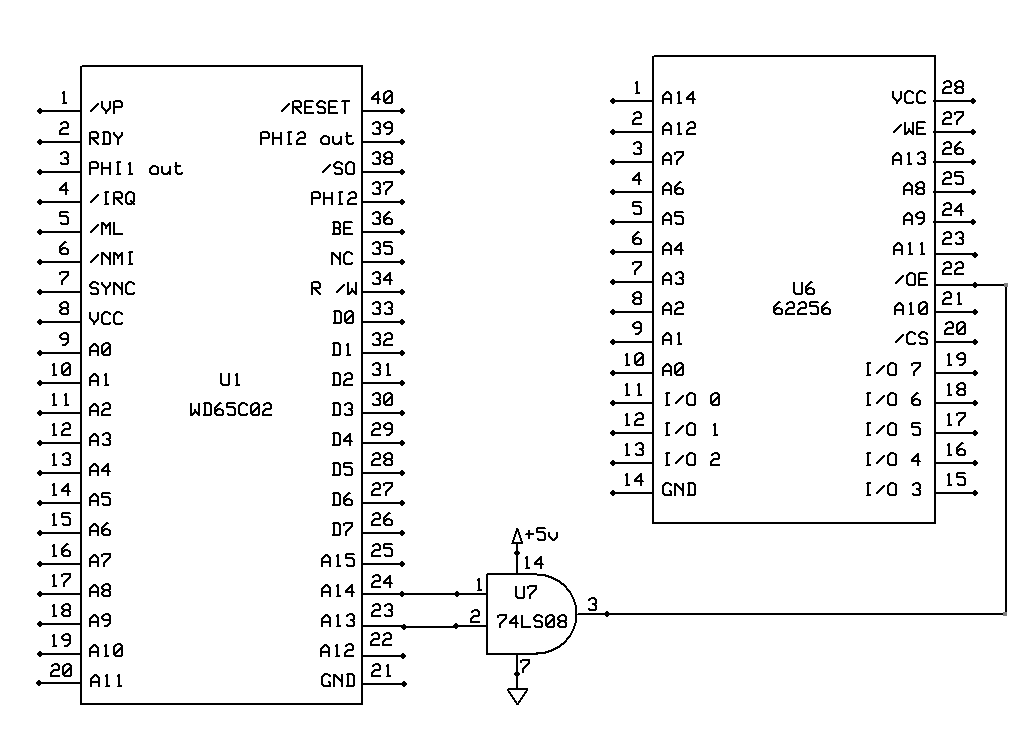

Just to summarise his layout:
  • W65C02 CPU
  • SRAM from $0000 to $3FFF (however using a 32kB RAM chip: 62256)
  • Nothing from $4000 to $5FFF
  • VIA chip (W65C22) decoded from $6000 to $7FFF however only 16 of those bytes are used. He referenced the VIA ports from $6000 to $600F in his examples, however I reference them from $7FF0 to $7FFF. The hardware decodes them regardless of the the other bits. In other words, the chip is selected when the processor sets the address bus to anywhere between $6000 to $7FFF and the register select is just on the low-order 4 bits.
  • He uses the VIA chip basically to drive the on-board LCD display, and also suggested switch decoding and displaying LEDs on the spare ports.
  • ROM from $8000 to $FFFF (32kB EEPROM chip: 28C256)
  • 74HC00 for address decoding
  • 1 MHz oscillator
In my documentation for G-Pascal I suggest adding 74LS08 "and" gate to do more fine-tuned address decoding for the RAM, which extends its range to be $0000 to $5FFF.
Ben's description of his project is here.

Nick Gammon wrote:
The address decoding seems straightforward to me. :)
Just checking, but did you notice how address line A14 connects to both the A14 input of the RAM and the OE# input of the RAM? :shock: It's not what I would call straightforward. At first I thought Garth had made an error in his schematic!

Joined: Wed Mar 09, 2022 9:08 pm
Posts: 18
Ah yes, I leveraged off that to increase the addressable RAM from 16kB to 24kB by "and"ing A14 and A13.

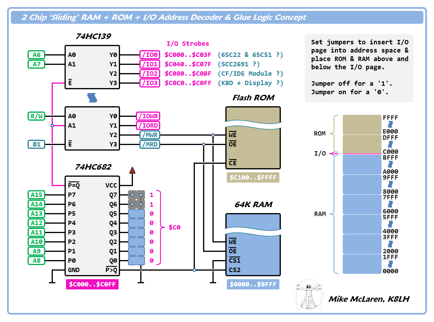

Since you've added a second 'glue' chip to the Wilson (Eater?) design to increase the amount of RAM available, may I suggest a relatively simple and flexible (untested) 2-chip method that even includes a few device select strobes? Of course it does rely on the active high chip select input on a 64K (or 128K) SRAM chip.
Stay safe, guys. Cheerful regards...

BTW, you could still use a single chip with coarse address decoding for 32K ROM, 8K I/O, and 24K RAM, but, like the previous example, the example below relies on the extra active high chip select input on a 64K (or 128K) RAM IC.
Cheerful regards, Mike, K8LH

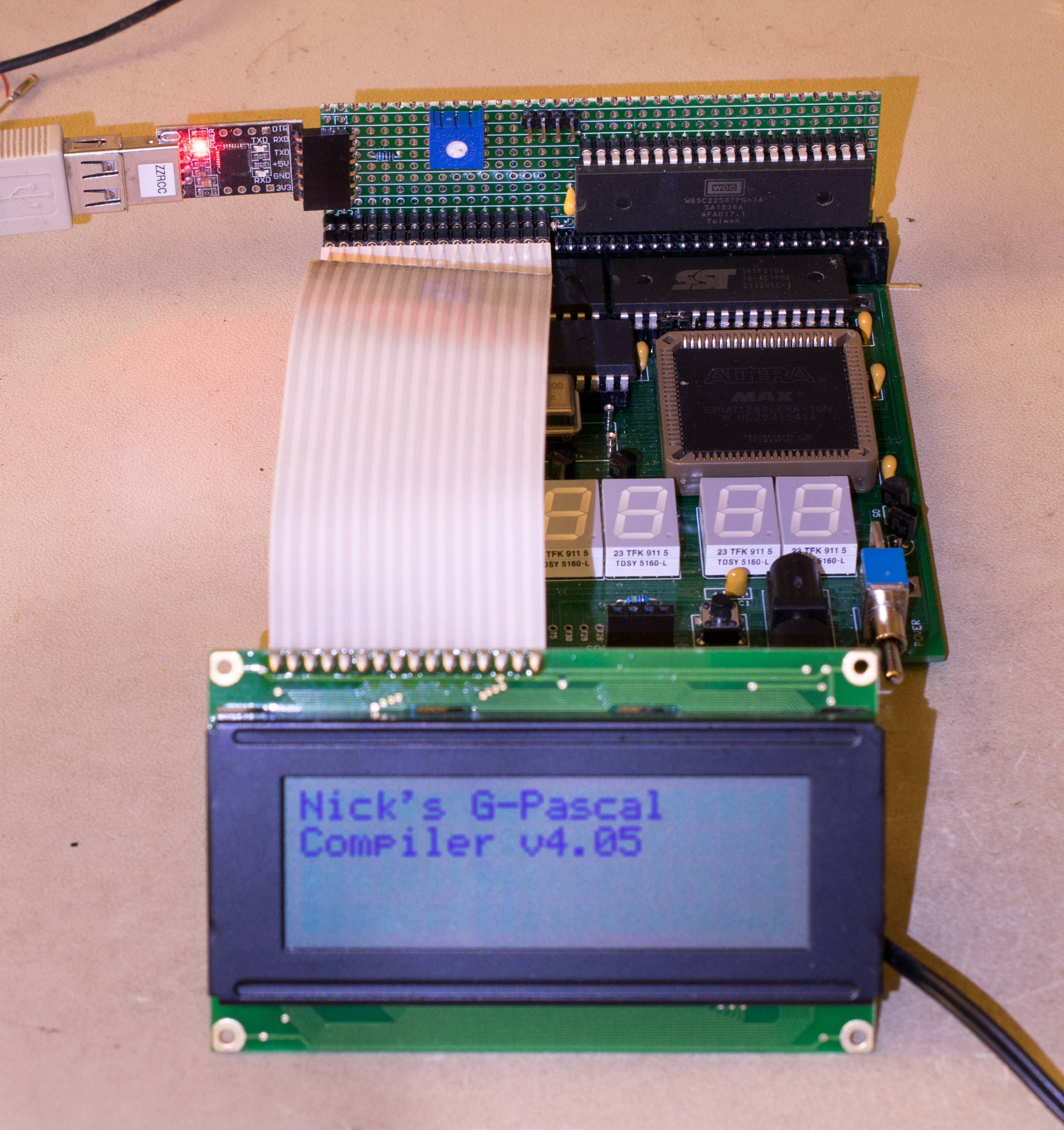

Hi Nick,
I try to port your G-Pascal to my CPLD6502 hardware that emulates Ben Eater's memory map. i.e., Flash from $8000-$FFFF, RAM from $0-$5FFF, and W65C22 from $6000-$7FFF. My original CPLD6502 has no W65C22 so I built a prototype board that plugs into CPLD6502's expansion bus. CPLD6502 is proven hardware I'm comfortable with but the W65C22 prototype is new.
I download your design from GitHub earlier this week. I burn a flash with the binary file, gpascal.bin. I made sure the program resided in $8000-$FFFF. Powering up I was expecting some activities on the serial port which is wired to PA0 and PA1 (PA0 is also connected to CB2 for falling edge interrupt), but I didn't see any activities while monitoring with a scope. When I send a character to the serial port, I can see interrupt generated to W65C02 but the interrupt stayed low, apparently it was never serviced.
I do not have 2-line LCD display but do have a 4-line LCD display. I hook up the 4-line LCD display (PA5 to RS, PA6 to RW, PA7 to E, PB0 to D0, PB1 to D1, PB2 to D2, etc to PB7 to D7), but it also showed no activities while monitoring RS, RW, E with scope.
I looked into gpascal.list listing and traced the execution of power-on reset, observed "hardware_init" routine being executed where VIA_PORTA, VIA_DDRA, VIA_ACR, VIA_PCR, VIA_T1C_L, VIA_T1C_H, VIA_IER, VIA_IFR are initialized with the right values. Yet VIA did not seem to be working.
Suspecting VIA prototype is the problem, I wrote a couple simple programs to exercise PA0, PA1, Timer1, interrupt, VIA_IER, VIA_IFR. They all worked as expected. I'm kinda stuck right now.
Is the software waiting on some inputs after power applied before output the sign-on message on serial port and/or LCD display? Is there a heart beat signal I can monitor such as interrupt? Is LCD display constantly being updated so I should see activities on LCD's RS/RW/E lines? Are there monitor/diagnostic embedded in gpascal.bin that I can patch into? Thanks for your help.

Try re-assembling with:
LCD_SUPPORT = 0
in gpascal.asm.
That way it should basically not do much with the 6522 VIA. I thought I had a time-out in the LCD code if it didn't initialise quickly enough but perhaps not. If that turns out to be the issue I'll have a closer look at that code.
The other thing is, does it emulate the WDC65C02 instructions? I used some of the newer ones like TSB and TRB. If they are not implemented the CPU may hang or generate interrupts.
There is an interrupt on T1 at the baud rate (4800/sec if you are using a 1 Mhz clock) however that is not active unless it is actively sending bytes. It does in fact send bytes at the start (the welcome message) so there should be activity in the IRQ routine shortly after startup ... unless it got hung up doing the LCD stuff.
The only way I can realistically generate heartbeat pulses is using the VIA, and the VIA is the thing in doubt right now. :)

A night's rest and assurance from the designer that I'm on the right track is the best troubleshooting technique. Because I don't need 512K RAM in this situation, I used a smaller 128K RAM (AS6C1008) instead. I forgot Address 17 (pin 30) in 128K RAM is chip select and need to be driven high otherwise the program will crash upon first return from subroutine. Boy, it sure did.
Once 128K RAM's active-high chip select is driven high, the original program booted just fine. The clock is 12MHz so serial port is running at 57600. The 4-line LCD display worked even at 12MHz; I noticed it needs local echoback and use line feed instead of carriage return. Thank you for your help.
