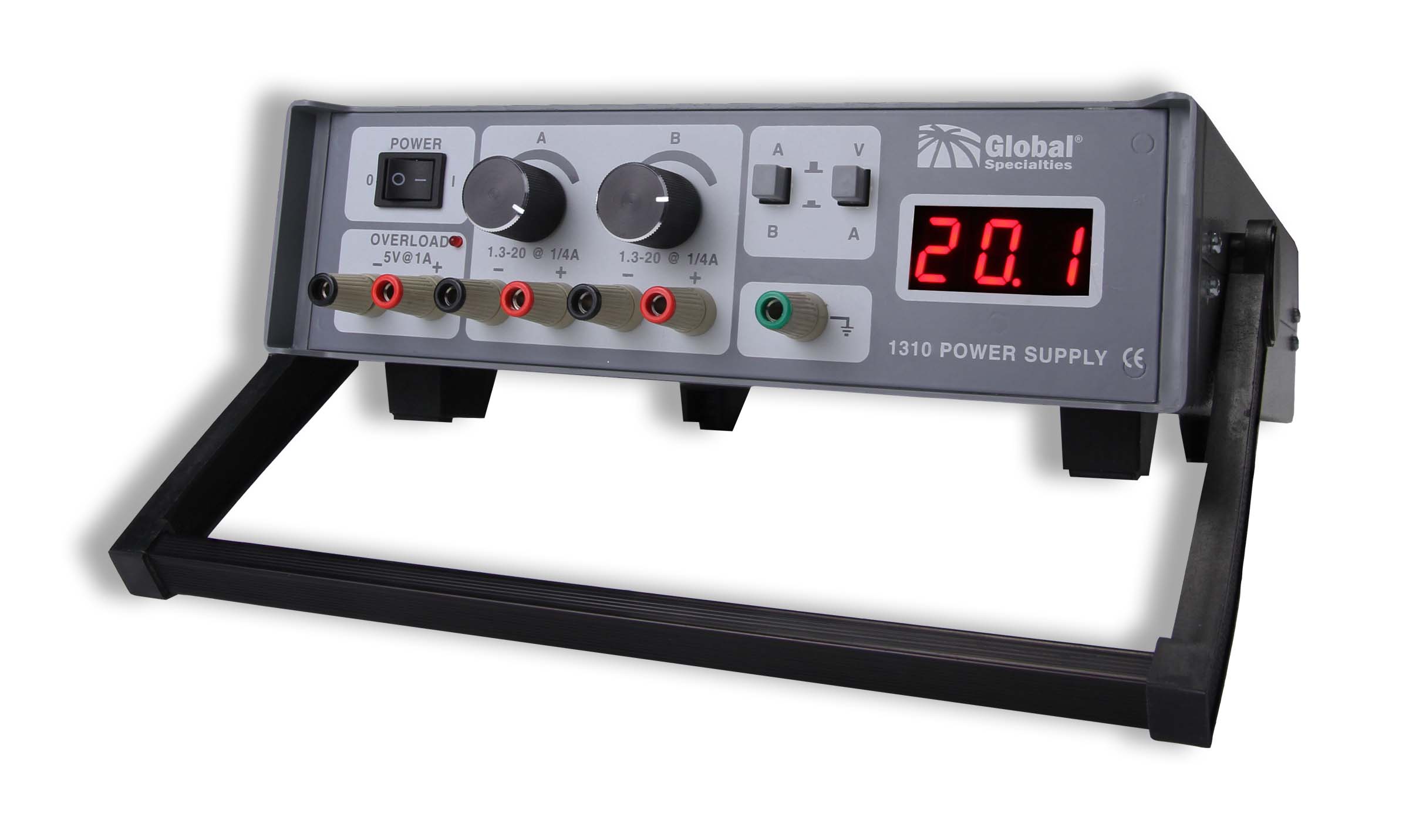

The piece of equipment that gets used most on my workbench is the Global Spcialties 1310 triple power supply which has a 5V 1A supply and two variable supplies that are supposedly 20V 1/4A but at around 12V they seem to be happy to provide more than twice that much current if you need it. It has current limiting and SOA protection so shorting it won't hurt it, and can display the voltage and current on the two variable outputs. It looks like
but has an older styling that the one in the picture. The 1300 which you might find on eBay is the same thing from the 1980's but with an analog meter instead of digital. These things have an outstanding reliability record. I've hardly used the 5V supply. My workbench computer uses ±12V (actually about 8-14V-- it's not critical) and has its own regulator from the +V power input to +5V, and uses the unregulated power inputs for the op amps for the A/D and D/A converters, the RS-232 line drivers and receivers, and the speaker amplifier (only +V for that one), and feeds these power supplies to the 65SIB (the multi-purpose synchronous-serial bus we devised on this forum) for 65SIB devices that don't have their own power supply, and feeds the +V to my home-made PIC programmer which needs 13V for the programming voltage (Vpp) for most PICs. The Vdd of the PICs is set by the D/A converter so you can program at 5V and test at anywhere from 2V to 6V, under software control. Some LCDs (especialy the STN) need a negative supply for the backplane and viewing angle setting, but this one doesn't.
