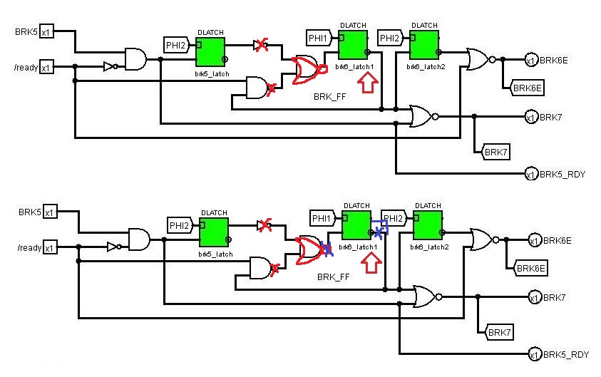

> It looks like the inverter for brk6_latch1 is missing.
Ah, I get it, as a result of the optimization everything is fine there, sorry :)
6502 addict
PostPosted: Tue Jan 11, 2022 8:54 am
Posts: 1431
org, nice going. :)
To the readers of this thread:
The situation is, that we have two teams which had used different approaches, notations and logic symbols for dissecting a CPU core.
//Assuming that the 6502 core and the 6509 core are identical at logic design level.
So it is fully normal to have false positives when cross_checking the results of both teams for errors.
For instance, I'm an old school hardware guy with absolutely no LogiSim experience,
and to me it wasn't obvious that a transparent latch like 74373 could have an inverted and a non_inverted output,
what had confused me a bit, sorry. :)
Also, in my schematics the disabling of the PLA product terms 92:T2.ANY_ABS, 99:T3.ANY_ABS, 145:Tx.IMPL
happens inside the PLA, while the 'org' schematics had moved that part into the random logic area,
what had confused me a bit, too.
So please see them false positives as a proof that we are just trying to do a good job while cross_checking the results. :)

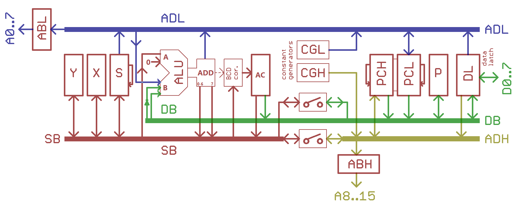

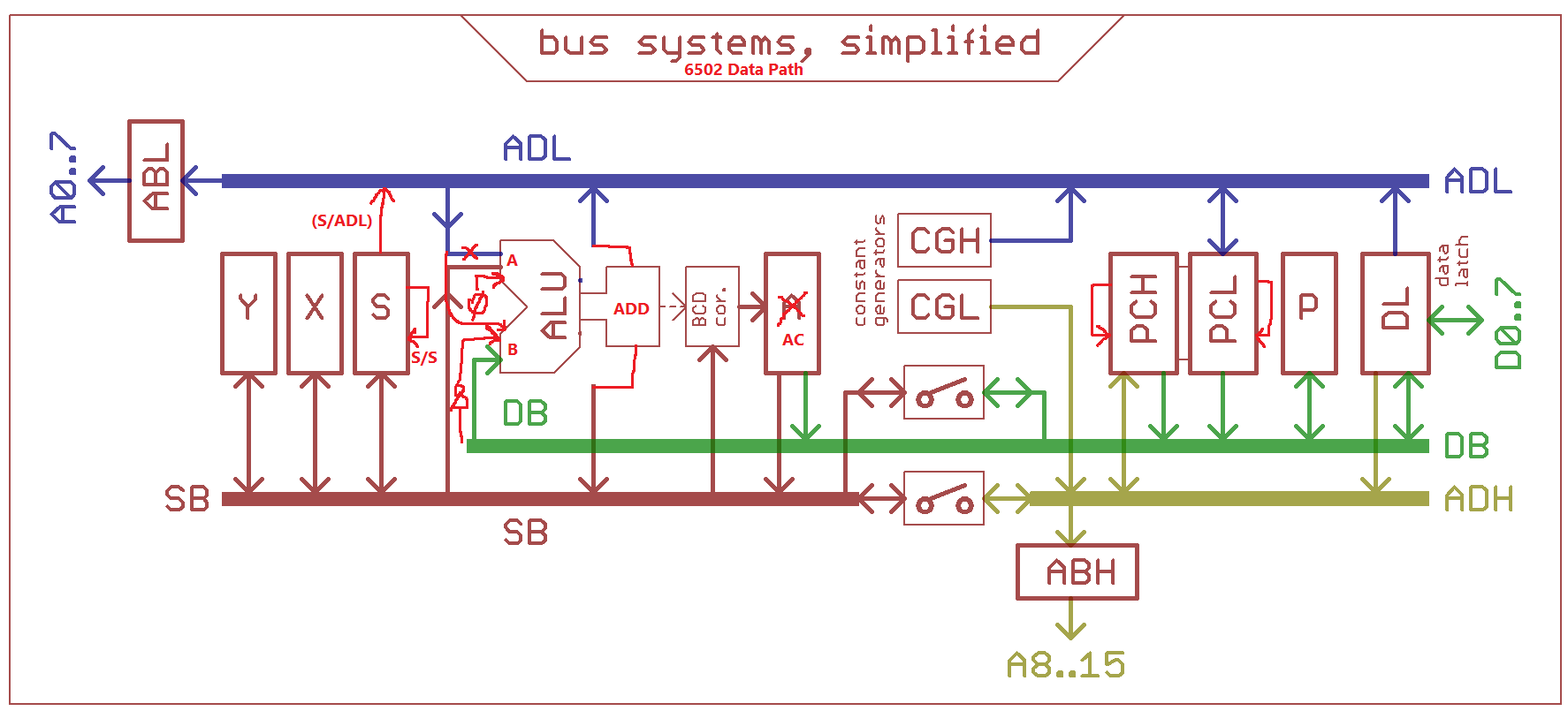

I did a little work on the Data Path diagram at the bottom.
- Missing S and ADL connection (S/ADL)
- The fact of loading direct and inverse value to the BI ALU latch is not reflected (DB/ADD, NDB/ADD)
- Zero load command is not displayed on the AI latch (0/ADD)
- ADL/ADD connects ADL and BI (not AI)
- Current value refresh commands are not displayed (S/S, PCL/PCL, PCH/PCH)
- Instead of "BCD-detect" made ADD (Adder Hold) and output to ADL and SB buses from it
- A -> AC (not to be confused with A Input)
6502 addict
PostPosted: Fri Jan 14, 2022 10:14 am
Posts: 201
In addition to the previous post.
- CGH and CGL are mixed up
- Adding a cleaner version of the diagram
6502 addict
PostPosted: Fri Jan 14, 2022 12:03 pm
Posts: 1431
I admit that I was in a hurry when drawing the block diagram with the bus systems,
it was the last step of the dissection.
It isn't exactly a data path diagram, because it shows the data path plus the address path. :)
Block diagram intentionally was kept as simply as possible to give an overview.
Don't worry, I'm adding a more detailed version.
My mistake, fixed.
I consider the AI and BI latches (plus the related circuitry) to be integral part of the ALU.
My mistake, fixed.
I consider the refresh paths to be integral part of the registers.
I consider the 'adder hold register' to be integral part of the ALU.
In Hanson's block diagram, the accumulator is labeled 'AC', so I'm changing 'A' to 'AC'.
Dang. How could this happen ? :)
My mistake, fixed.

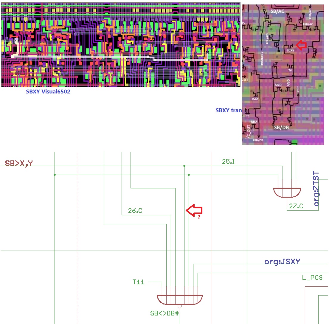

Case SBXY:
On the transistor circuit, the SBXY intermediate signal (SB>X,Y) comes in only one place - ZTST.
6502 addict
PostPosted: Mon Jan 31, 2022 11:07 am
Posts: 1431
org wrote:
Small case SB_S:
For some reason, the 6-nor is split into two gates (in the demorganized version 4or + 2or).
Reason was, that there were no 6or or 8or logic gates in the libraries of the CAD software I'm using.

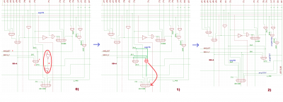

org wrote:
Case SBXY:
Ah, that... maybe I had skipped a step during optimisation:
0)
org:ZTST = SB>A | AND,BIT | SB>X,Y | org:T6
the output of an AND gate goes into the "SB<>DB# NOR": NOT(AND,BIT) & org:ZTST
1)
so we could consider that input of the "SB<>DB# NOR" fed by the AND
to be the equivalent of the output of a three input OR gate:
SB>A | SB>X,Y | org:T6
2)
So I had pushed that three input OR gate into the "SB<>DB# NOR gate". :)

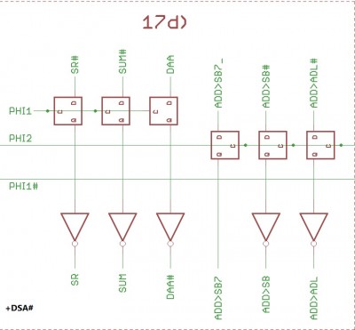

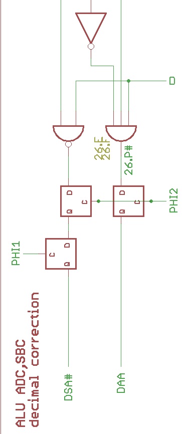

Cosmetic case DSA#:
I noticed that DSA# is obtained in random logic, but is not mentioned in the command block.
We know where it comes from, but for example, who will study it, will not immediately notice it.
6502 addict
PostPosted: Wed Feb 02, 2022 7:58 am
Posts: 1431
Good point,
so I added 6 signals to that part of my schematic:
0>ADL0, 0>ADL1, 0>ADL2,
DSA#, 0>ADH8, AVR.
